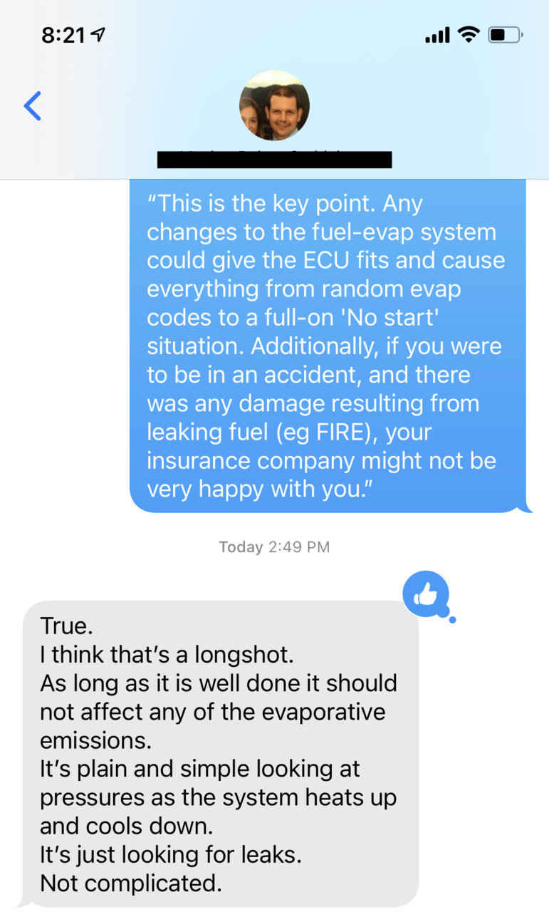

    I reached out to a mechanic friend who is also a fellow 3rd gen owner. He actually likes my idea. This was his feedback on the emissions/evap system:

    "It's just looking for leaks" is the whole point though and why some of us are against the idea of using the trucks tank to run a pump lol. I just can't see how it's not easier and less troublesome to plop down a 10g cell and call it beer thirty.

    Best idea yet. Or tap the filler neck with a tube that stops short of the bottom of the tank but personally I don’t see that risk as being worth the benefit.

    I don't see why you can't install a bulkhead fitting, a pickup tube and a shutoff valve into the tank. Drop the tank and remove the fuel pump assy. Drill a hole for the bulkhead fitting next to the fuel pump access hole. As long as you have a shut off valve, there is no tank pressure problems.

    Your pump will want to pull fuel so it may not hold against pressure. Aftermarket tank assemblies are designed as such to work as auxiliary or replacements but your itty bitty fuel line isn’t part of any design. That’s where it becomes a big IF. Yeah, try and avoid any Darwin awards.

    This is my thought as well. Seems like it may throw the evap system off if by tapping the system is no longer sealed.
