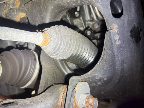

    Just bought this vehicle 4k miles ago and apparently didn’t do my due diligence. Went in for my first oil change and I’m being told I need a new steering rack. I’ve attached the link with the video they sent me. 2020 Trd sport with 58k miles. Do I need to do this now? Contemplating just trading it in and taking the hit.

    Clean it up, top it off, and give it a minute to see what's actually going on...
    It's not an emergency.

    You can live with a leak if it is slow and you keep the reservoir full.

    Thanks! I’ll give this a go

    It's common to see steering rack leaks like this on 2nd/3rd gen Tacomas and 4th/5th gen 4Runners. You have some time before the leak gets severe enough for fluid top ups to become a nuisance.

    That shit is pissing. Sure there isn't a hole in a line or loose connection?

    It’s been 2 days since I’ve topped it off and the reservoir doesn’t appear to be any lower. Given I’ve only had the vehicle a short amount of time and just discovered this I’m not sure how slow/fast it’s leaking. I think for now I’ll keep an eye on it. Thanks !

    Am I the only one that sees it pissing or am I going crazy?

    They are brutal to change, diff has to come out and engine needs to moved up, or ac removed.

    You mean the oil that's still draining from the oil change? Yeah, it's pissing but it's not power steering fluid. lol

    :facepalm: im now realizing that's the filter housing :rofl:
