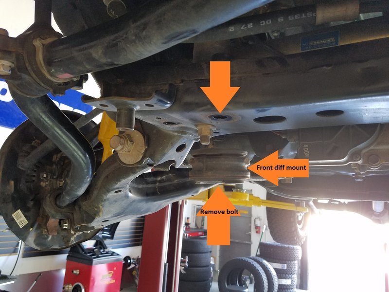

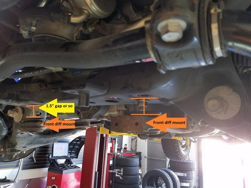

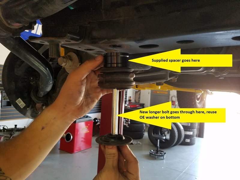

    Hey, I installed this diff drop kit into my 4runner this weekend (same process), and I added some notes in the photos. It comes with instructions, but it's very straight forward too.
    When you remove the front diff mount bolts, you can just let the axle hang, and in these photos you can see it just hanging there probably about 1.5" or so. Then you put in the spacer and push it back up with the new bolt in place.
