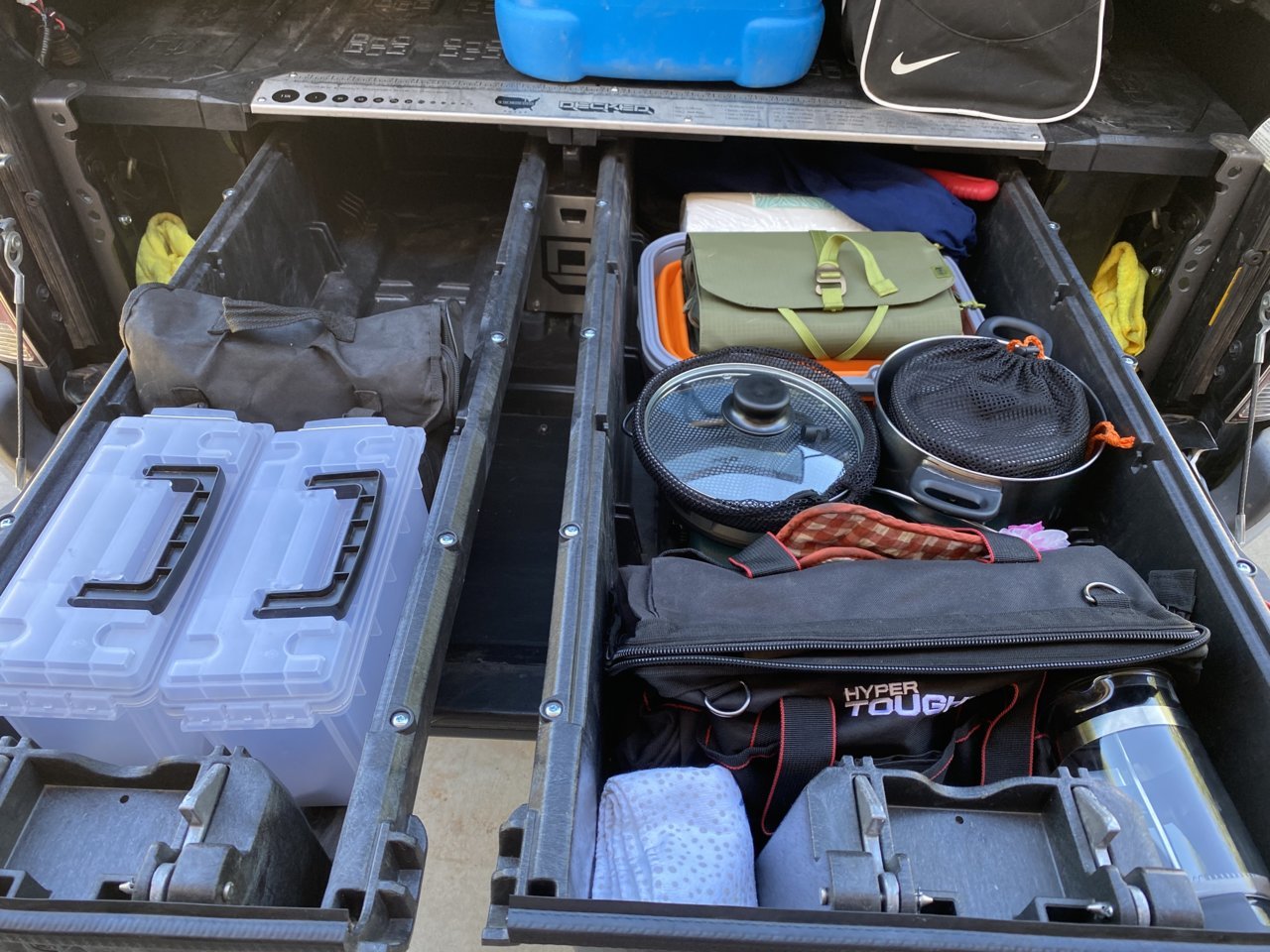

    • Decked drawer system

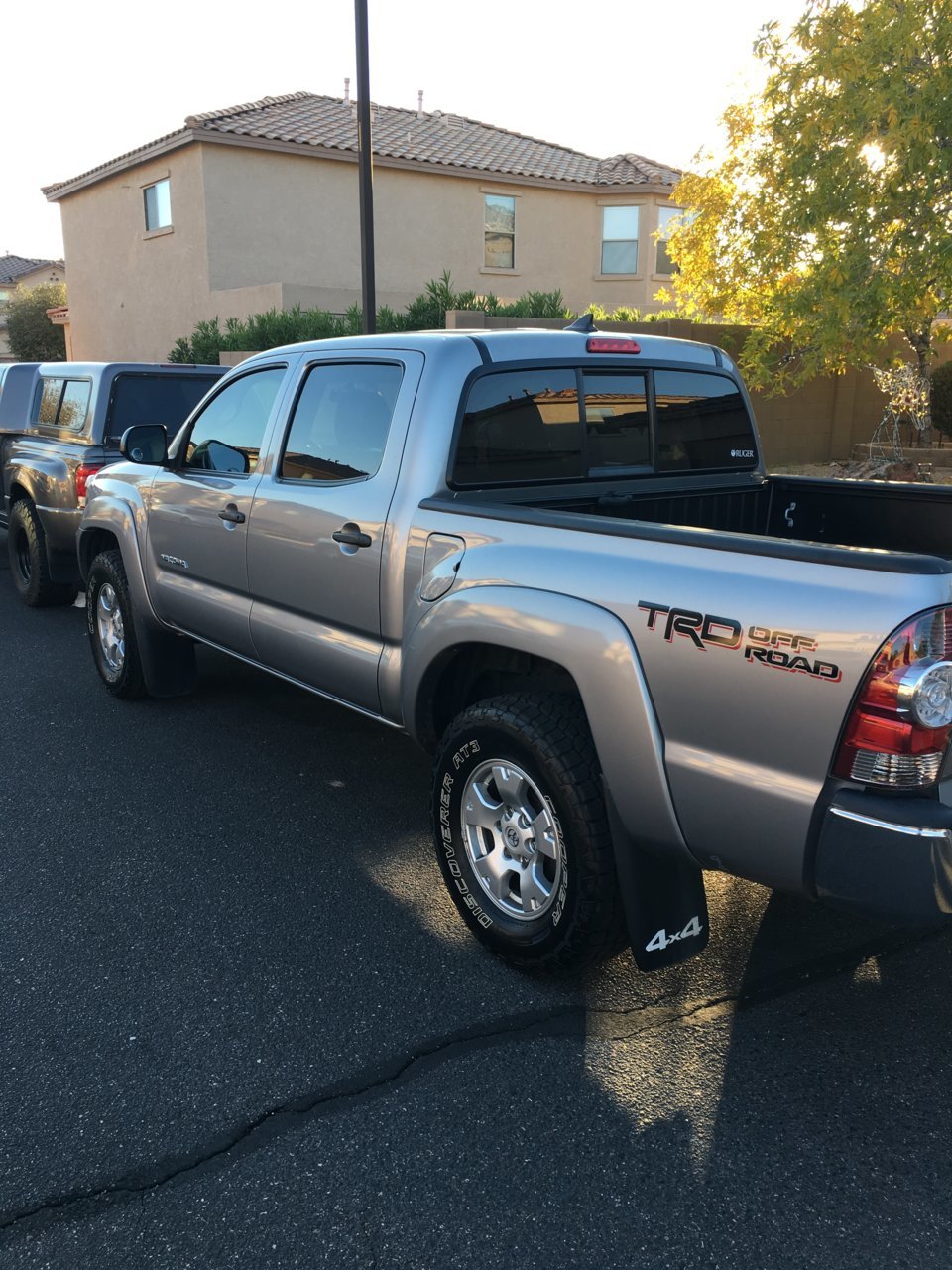

    First day i brought her home at 37k miles completely stock aside of some Cooper Discovery tires.

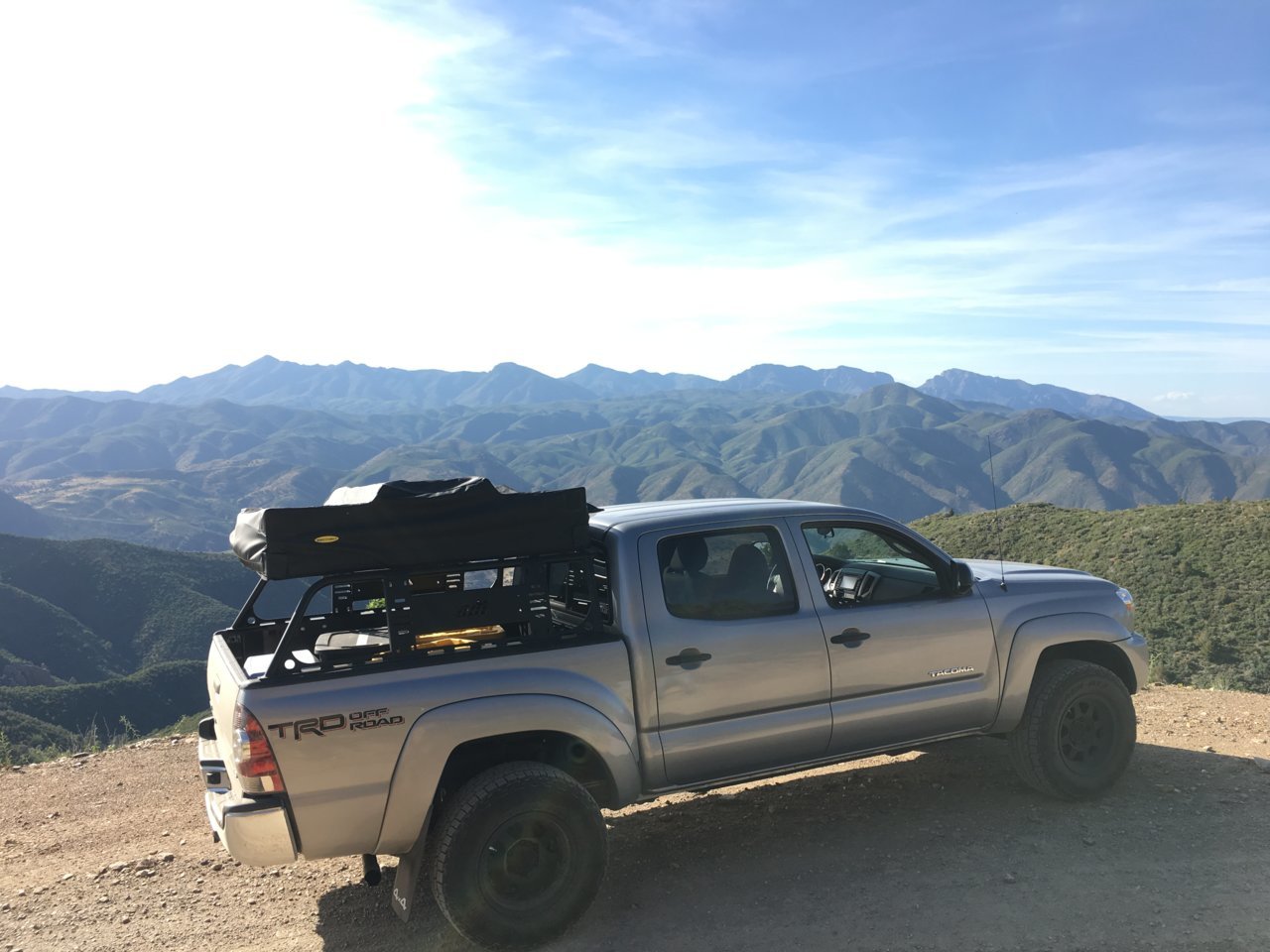

    2014 DCSB Silver TRD Offroad
    After my trip I was dead set on getting a RTT as i was seeing them everywhere and it seemed way too convenient (I was right its awesome). I paired it with the CBI bed-rack. I received the bed-rack right before a trip and decided there was no way I was going on that trip without both being installed. I started at 6pm with this being my first real project on the truck and it took me much longer than expected:rofl:. The last picture is the next morning with everything put together.

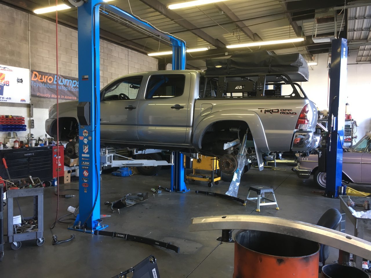

    Next up was a suspension upgrade. This was the time I became addicted to TW and was browsing it for countless hours everyday. I ended up talking to Erik over at State48Overland to do my lift. Awesome guy with tons of knowledge about Tacomas. I would recommend anyone over to his website that is looking for anything offroad or over-landing related. With some help I decided to go with King 2.5 w/ remote reservoirs , Icon RTX leaf pack, SPC UCA's and DuroBumps.

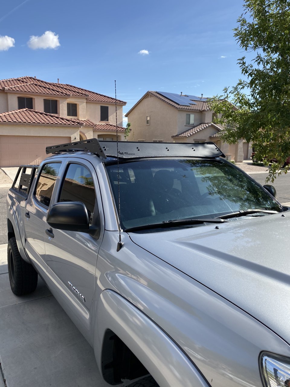

    Next up was a Prinsu roof rack to match the bed rack. This install went pretty well until some storm clouds started rolling in as I was sealing it all up with silicone. I ended up wrapping the whole roof up for the night :D. I unfortunately don't have any pictures of it all stayed dry with no leaks! The end of last year I decided to be a little festive and put up some lights.

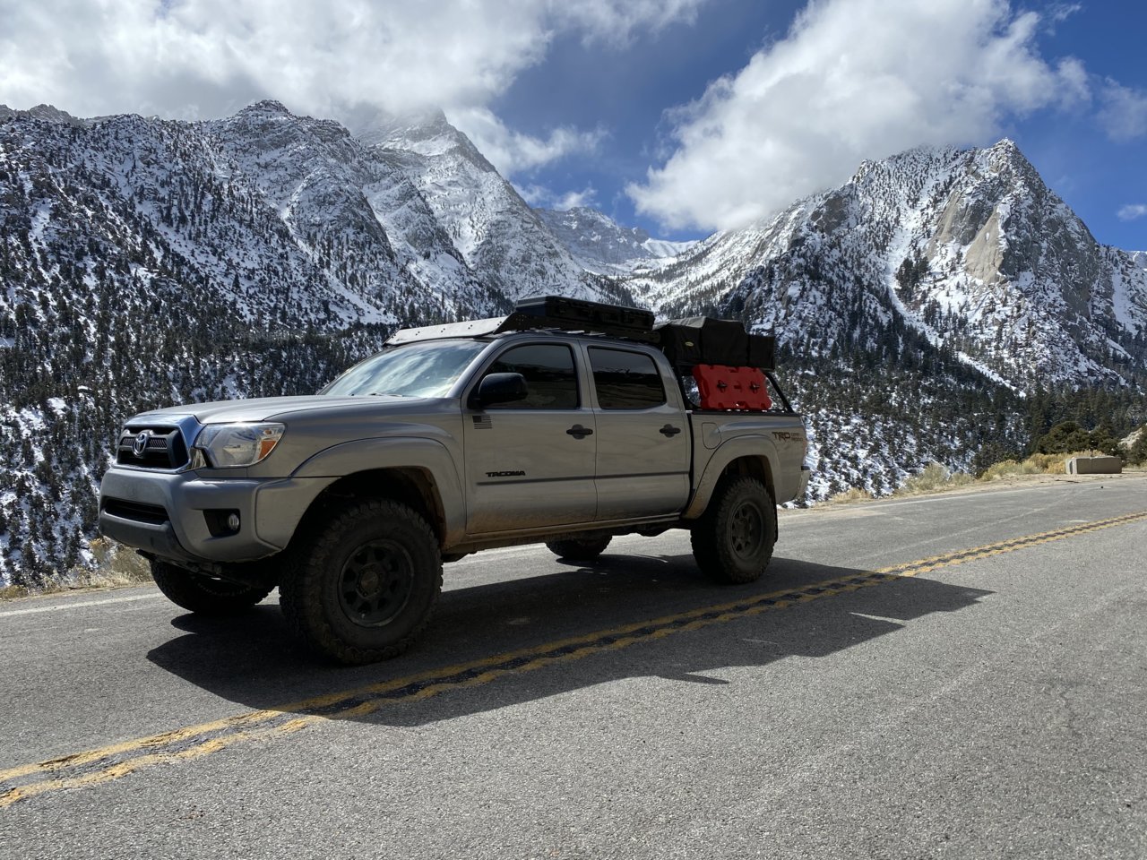

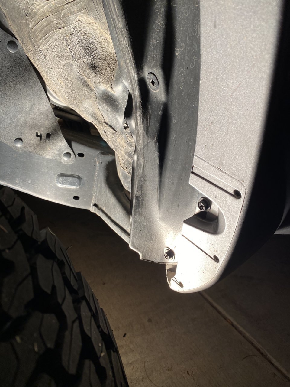

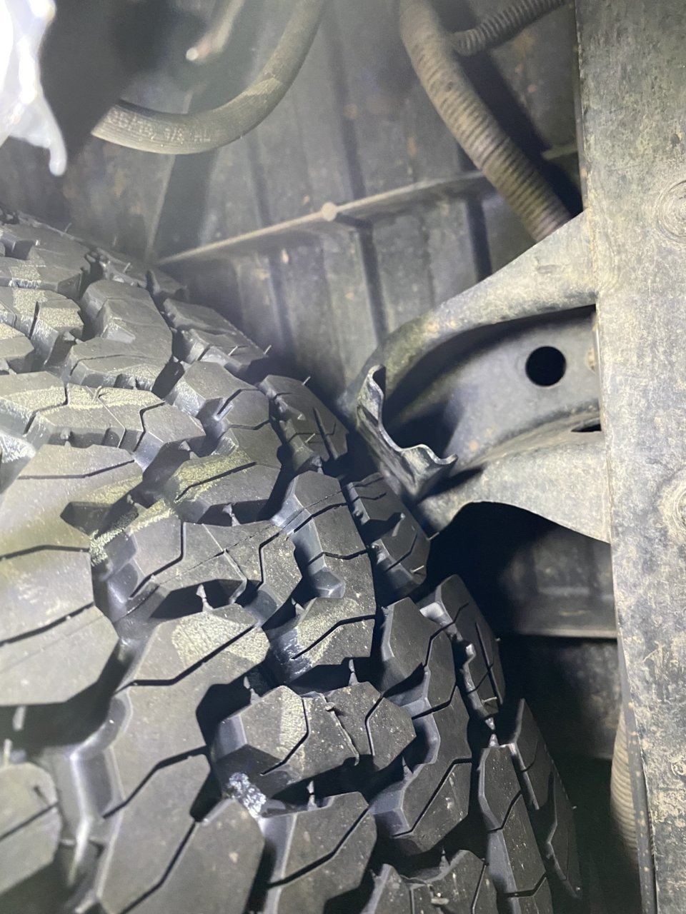

    Now with a lift it was time for bigger tires. Went up to 33s with the BFG KO2 285/75/16. The largely discussed topic "will my truck fit 33s stock". Well the answer is not with my wheels. Did some fender trimming and had ToyPros do a CMC, and removed the pinch weld.

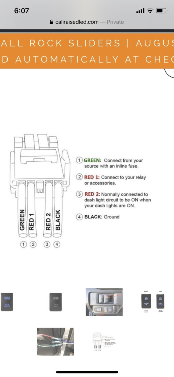

    Jerry Rigged some RC ditch lights to a Cali Raised OEM style push button

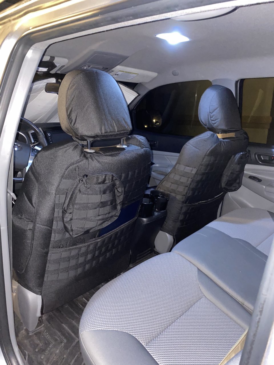

    Added the Bartech Seat Covers (these took way longer than expected to install) they ended up fitting really nice.

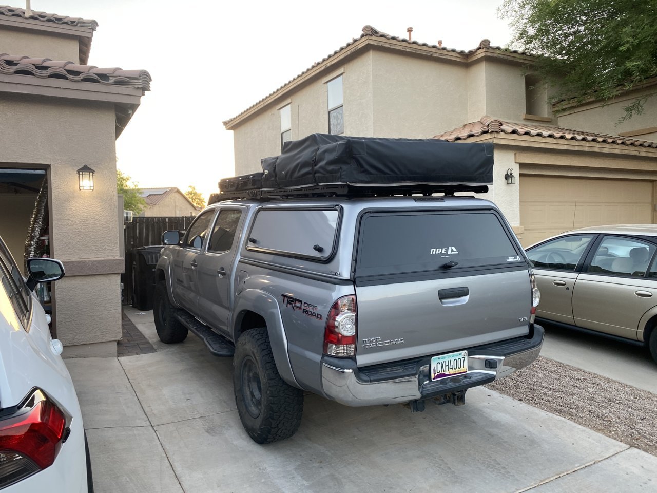

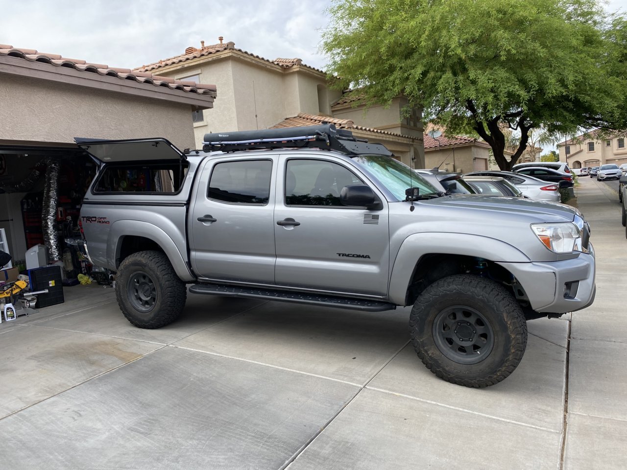

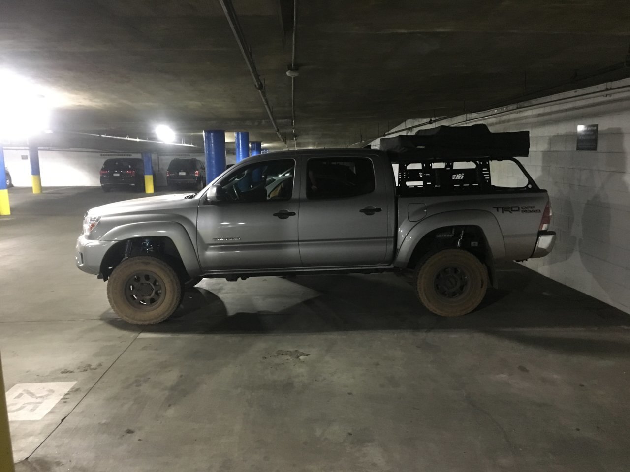

    This is how the truck sits now. I will be hopefully getting my CBI sliders sometime next month.

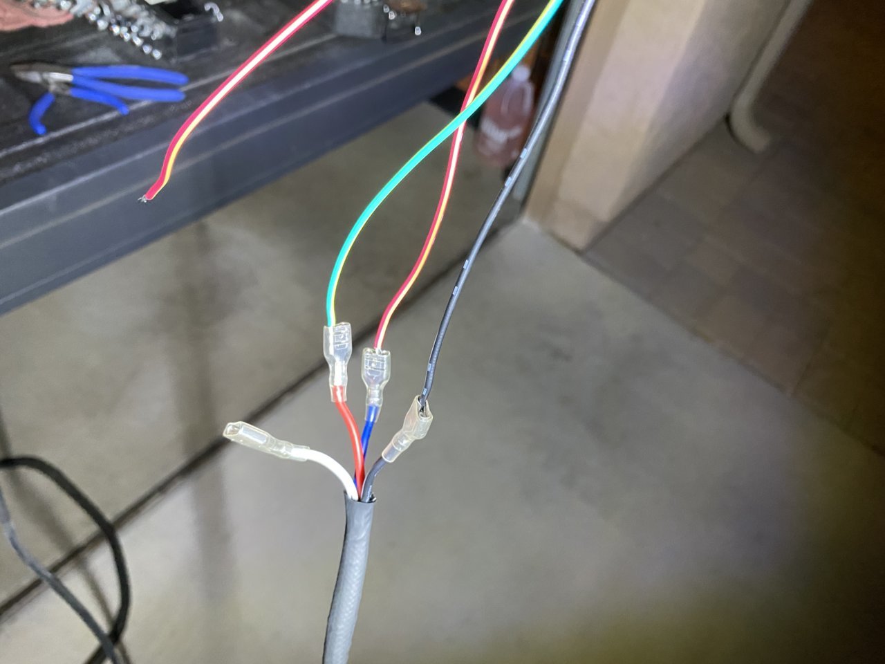

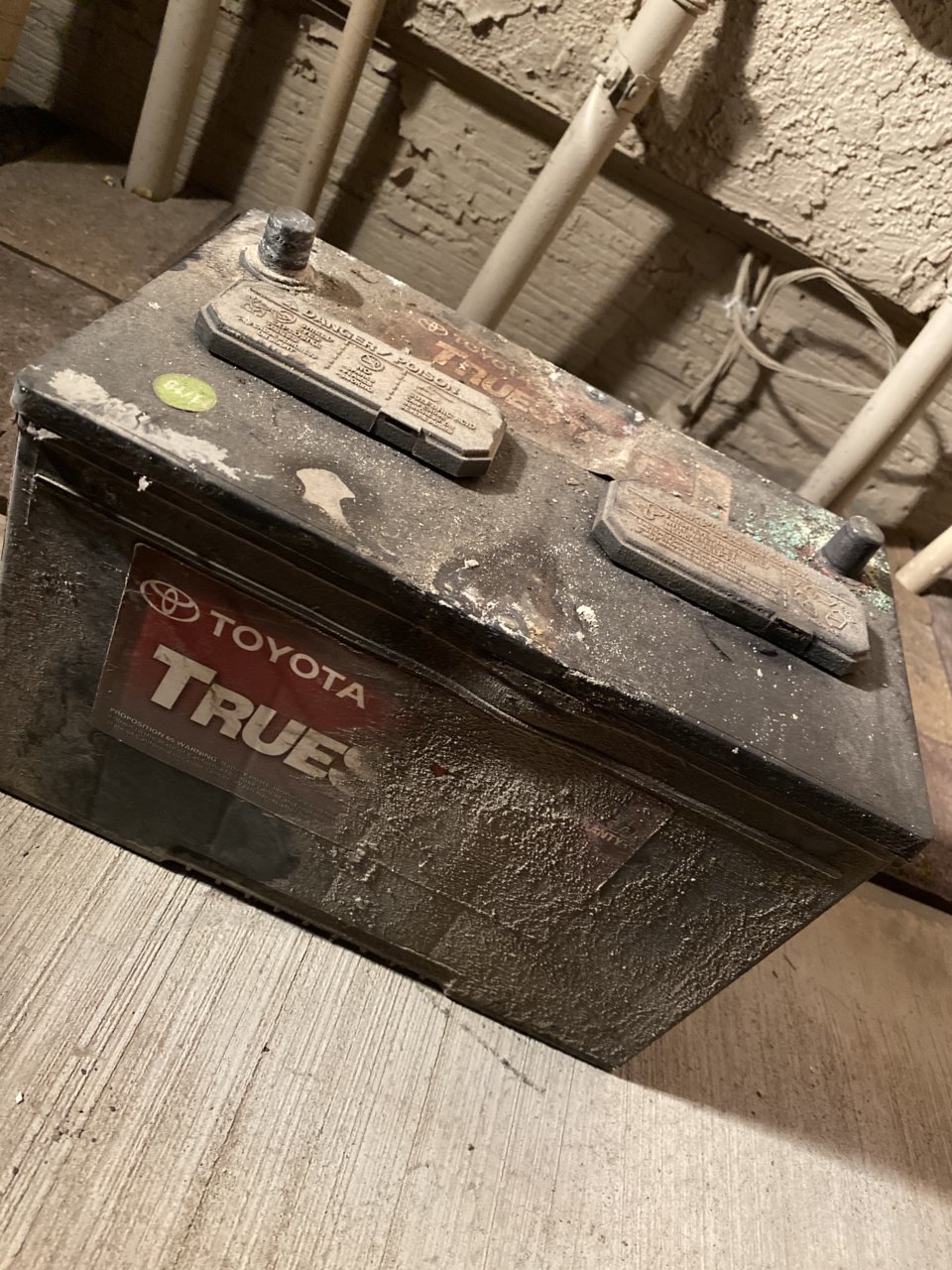

    Took a Trip to the Mojave Trial recently and on the way back my radio would turn off and back on. Sometimes the radio would turn off and occasionally the lights would flick off as well as dash lights flashing on for just a slit second. Super weird I couldnt find much info on it other than trying to update the stereo but it wouldn't explain the head and dash lights. I gave the update a shot and was still having problems with the just the radio. I was out of ideas so I tried replacing the battery since it was in horrible shape after the trip. replaced it and haven't had the issues since a week later. Very odd. Introducing my new Optima Yellow Top.

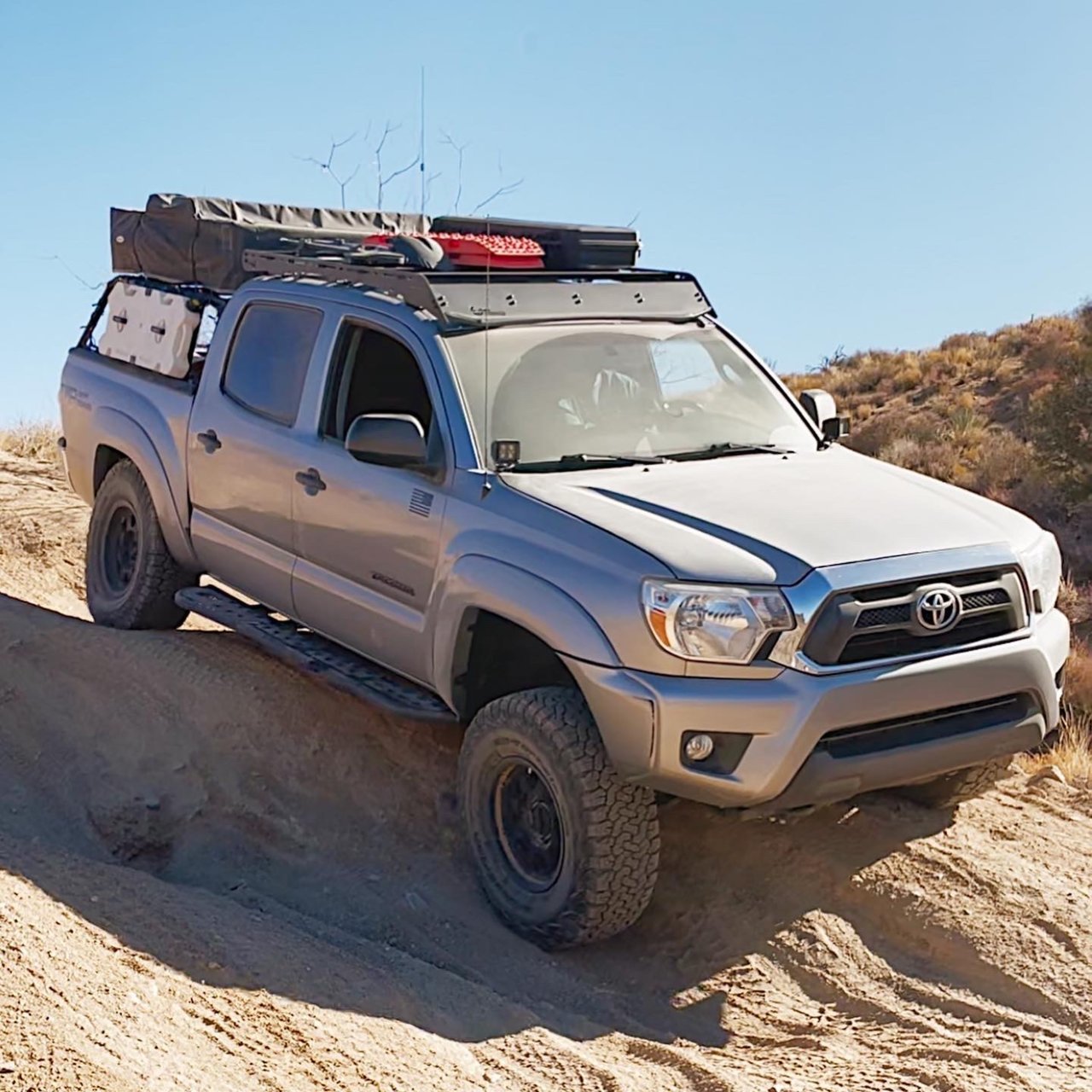

    Heres a few pics of the trip too.

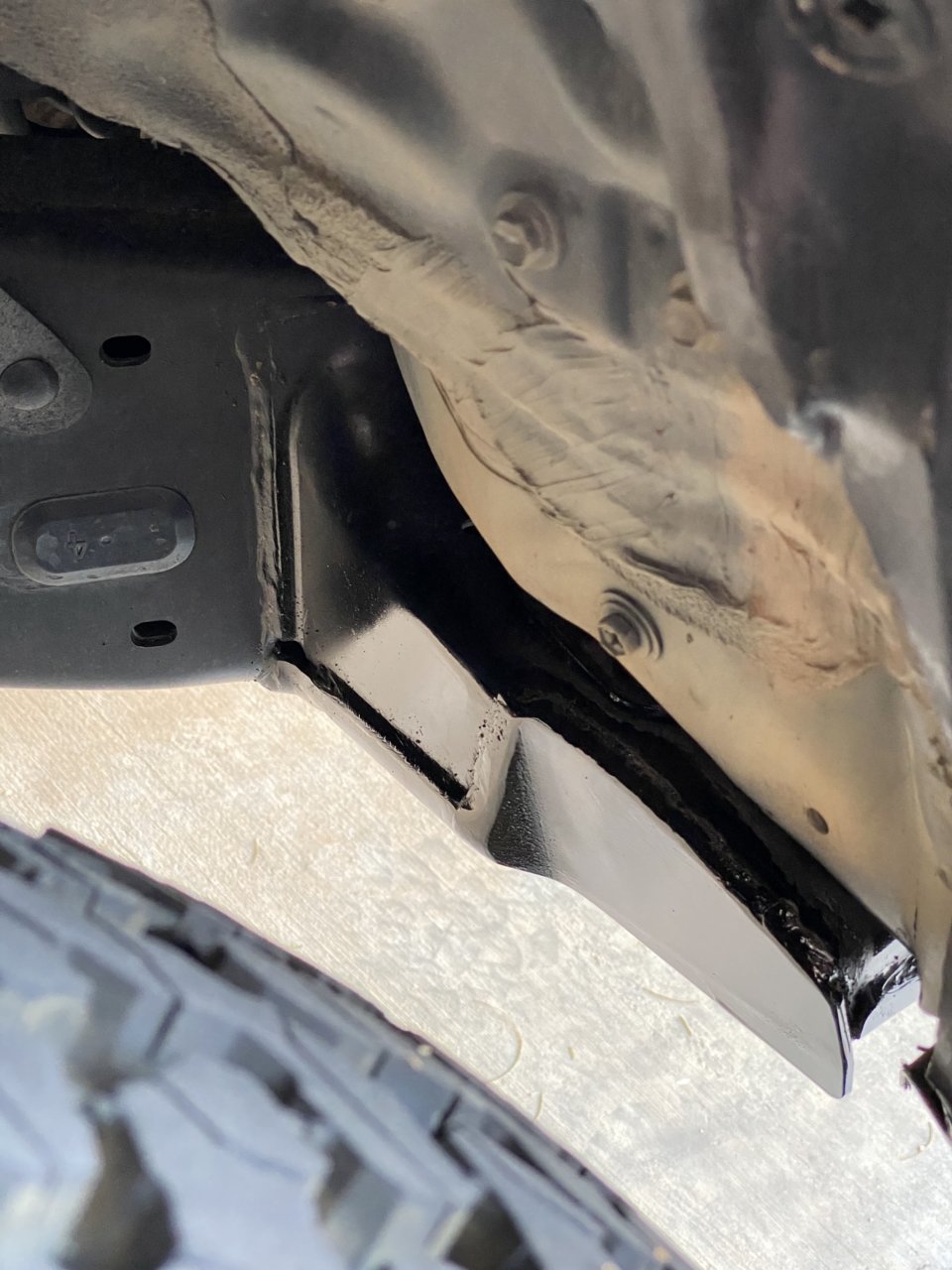

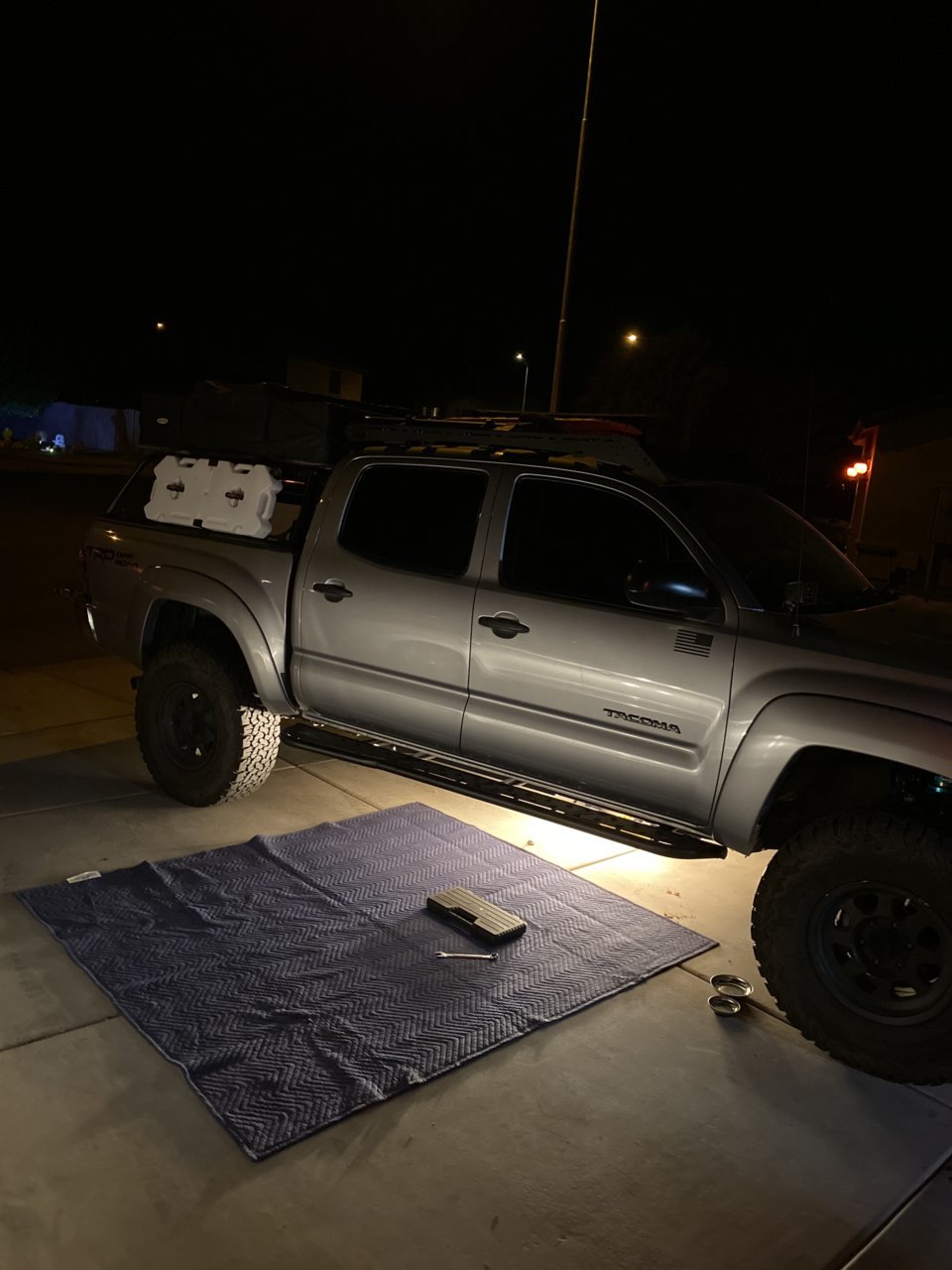

    Forgot to post the pictures for my slider install as well.

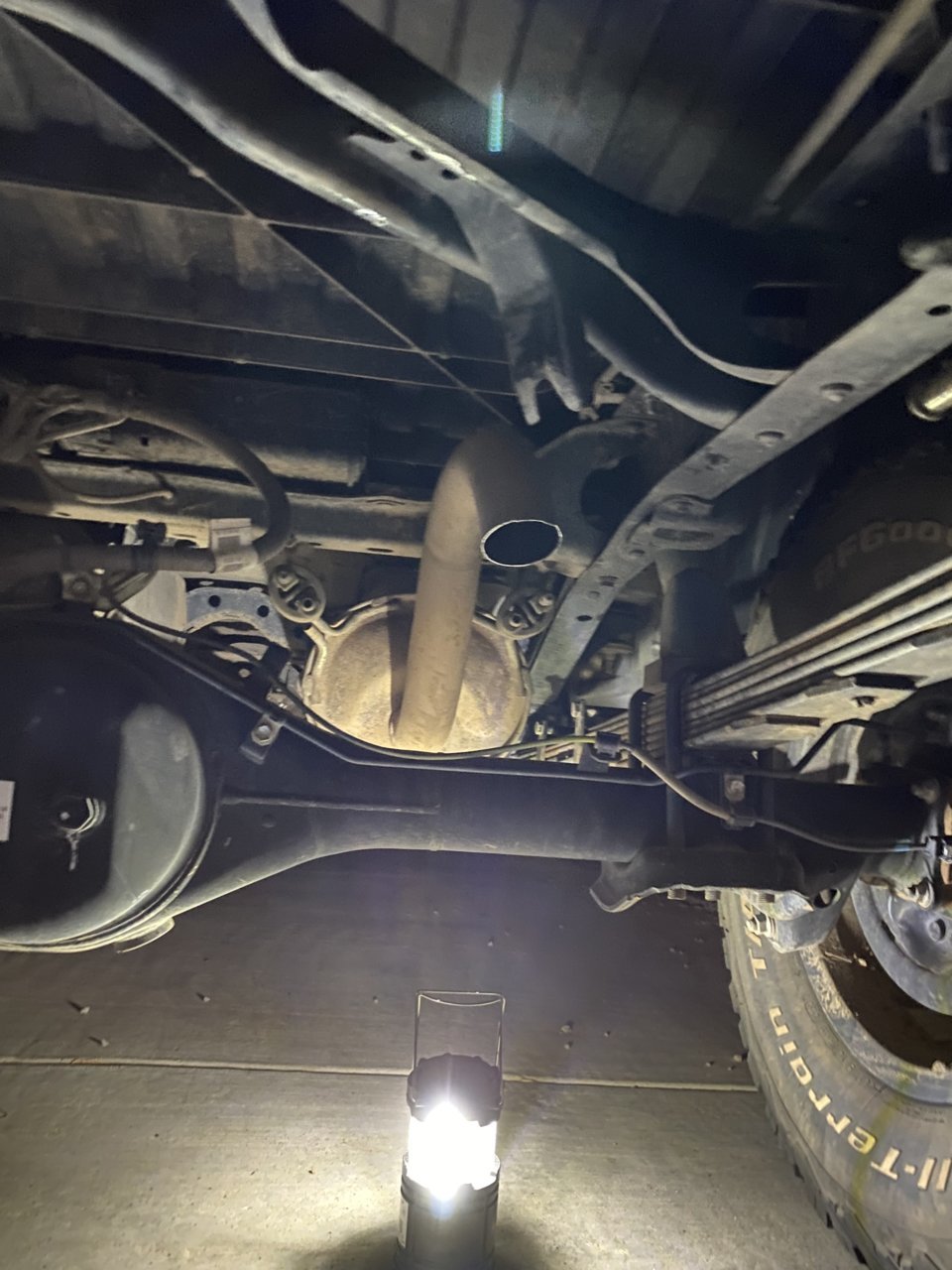

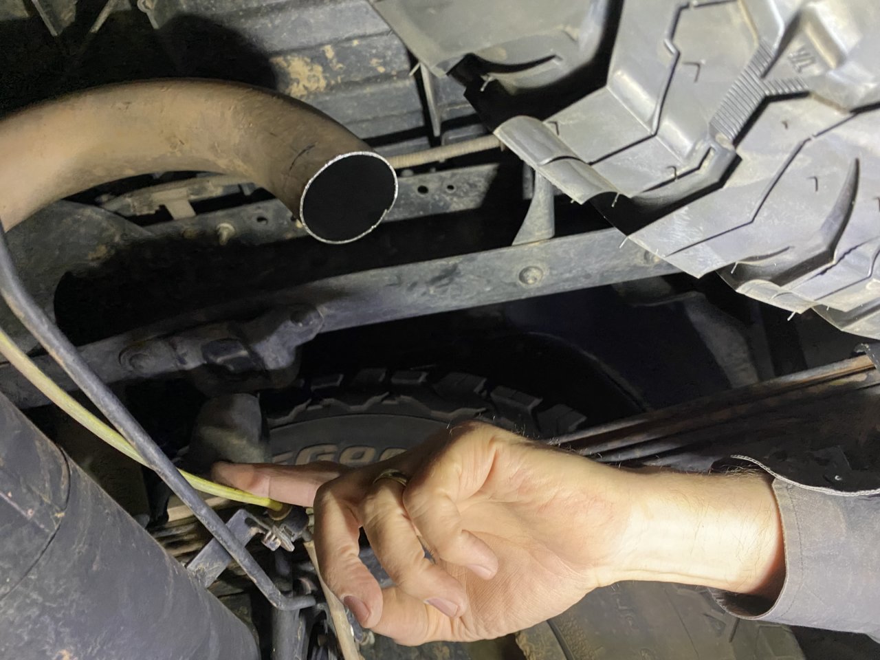

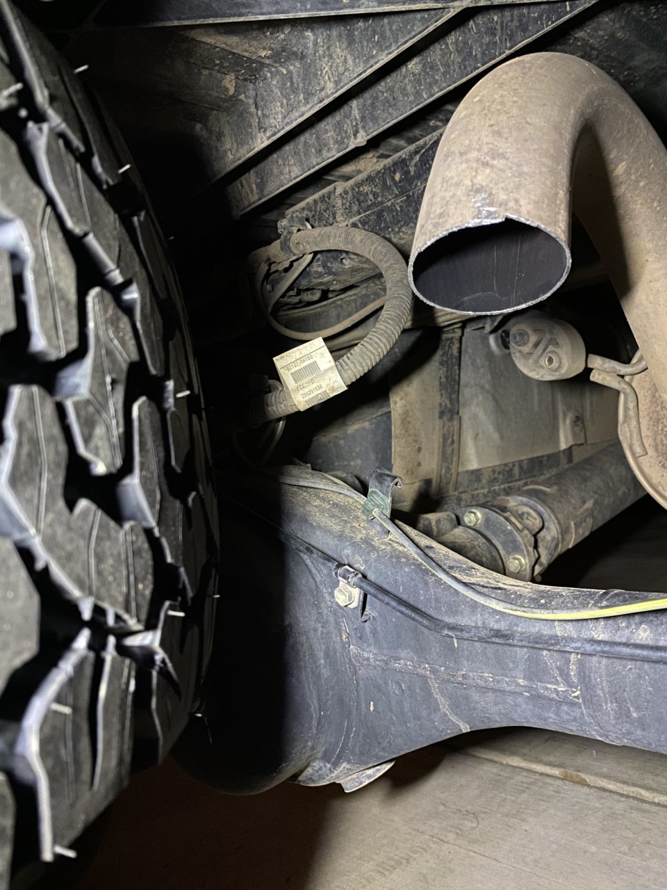

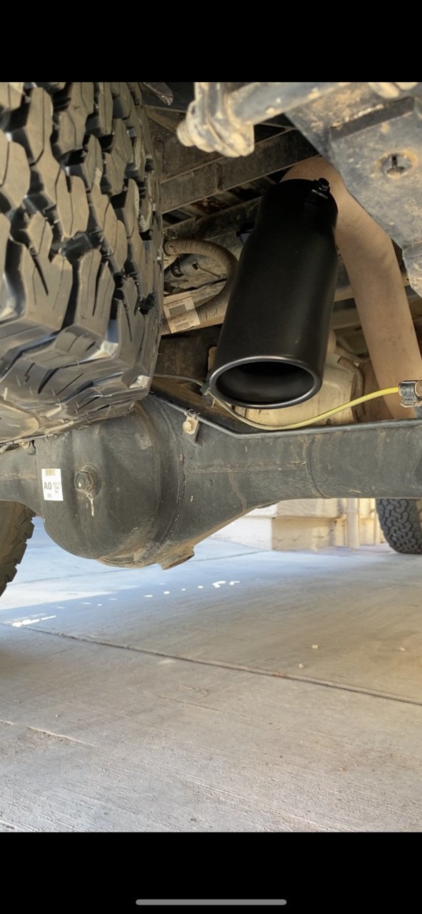

    Also fit up the full size spare underneath again and chopped the exhaust

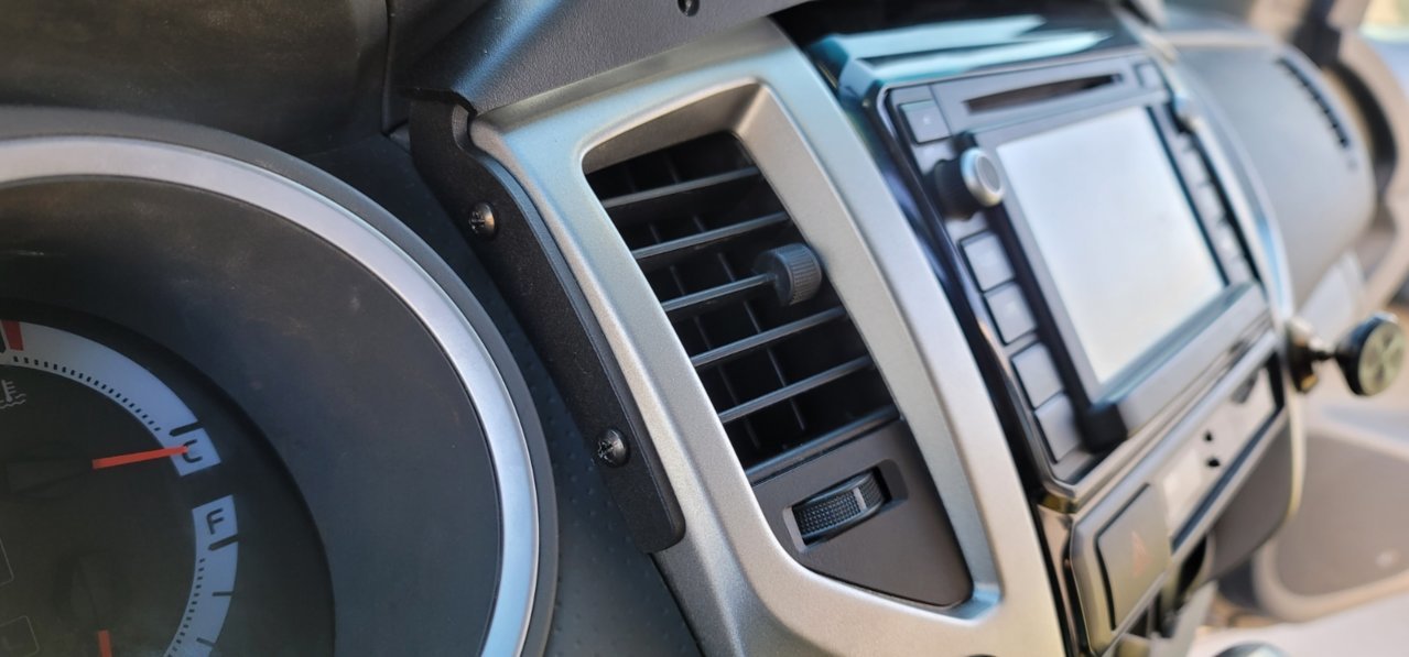

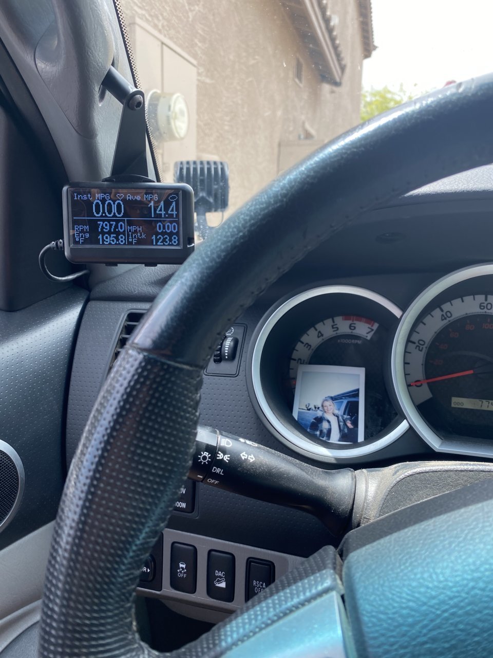

    Got the UltraGuage set up with the Spiker Engineering mount. Been messing around with some of the presets and calibrated it for my tires using these instructions from here

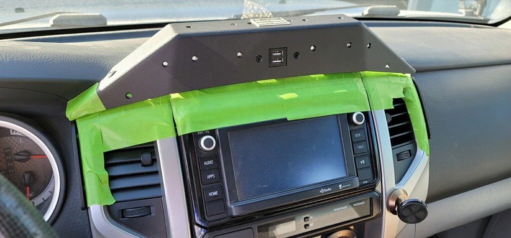

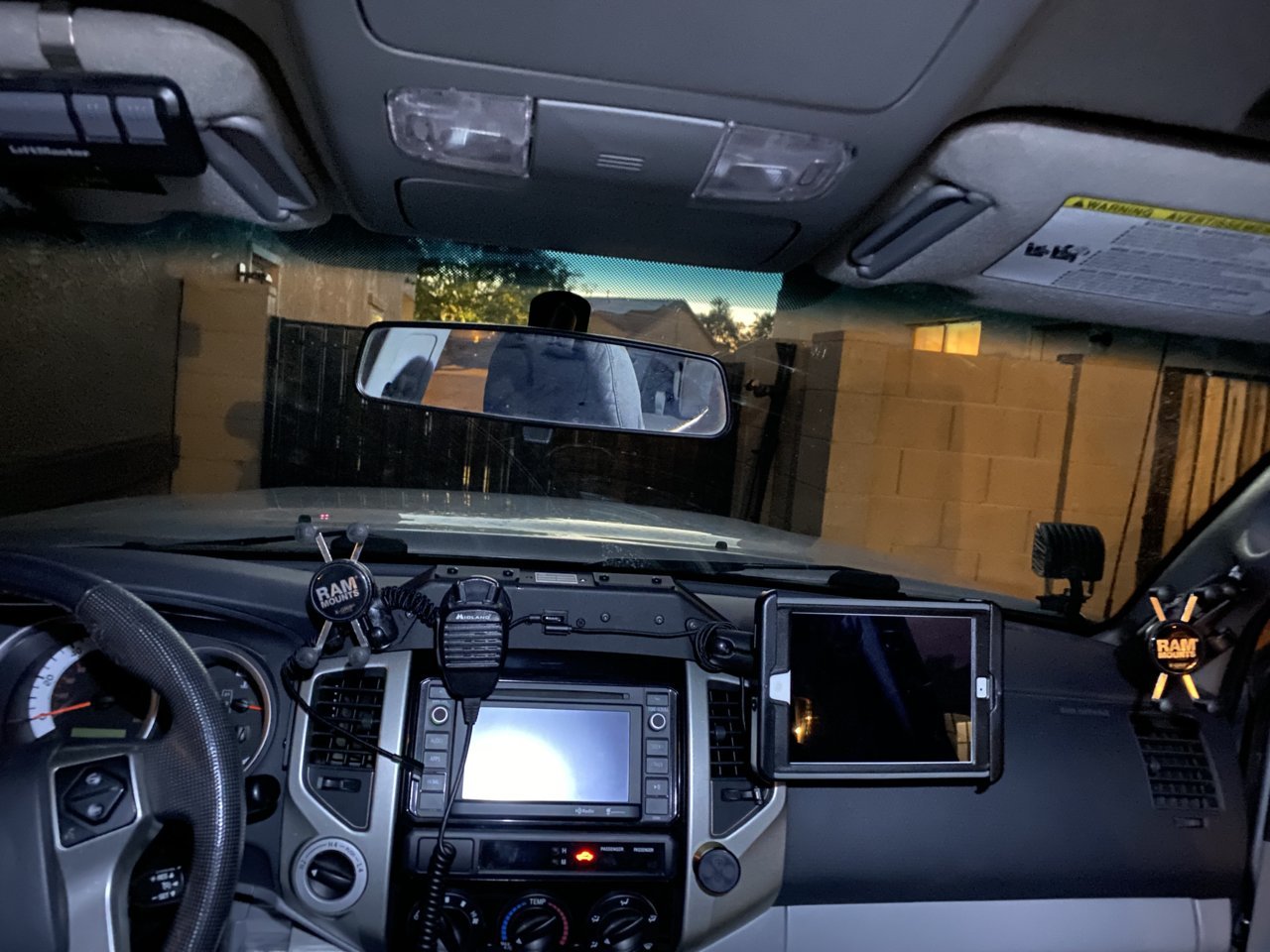

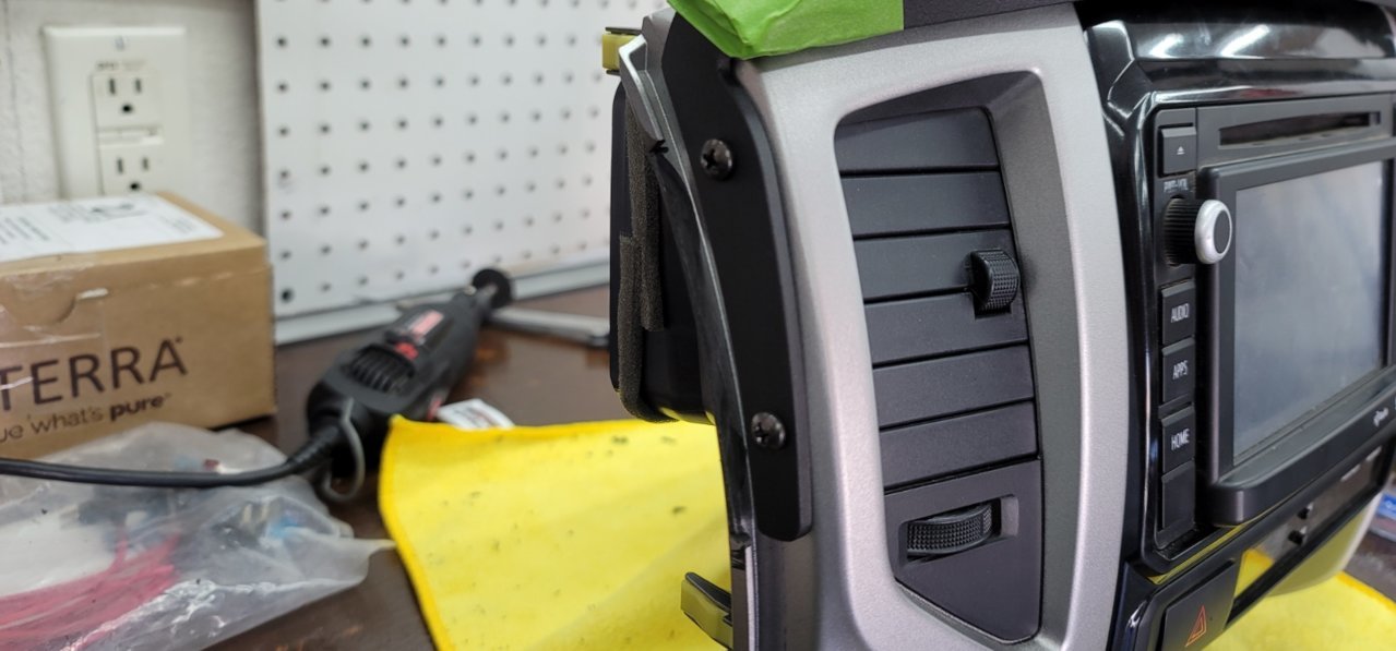

    A bit late writing this post up but @Man of Steel TRD recently install my 2TPAM mount for me. He did an incredible job and couldn't be more happy with it. definitely shoot him a Pm if you want the job done right.
