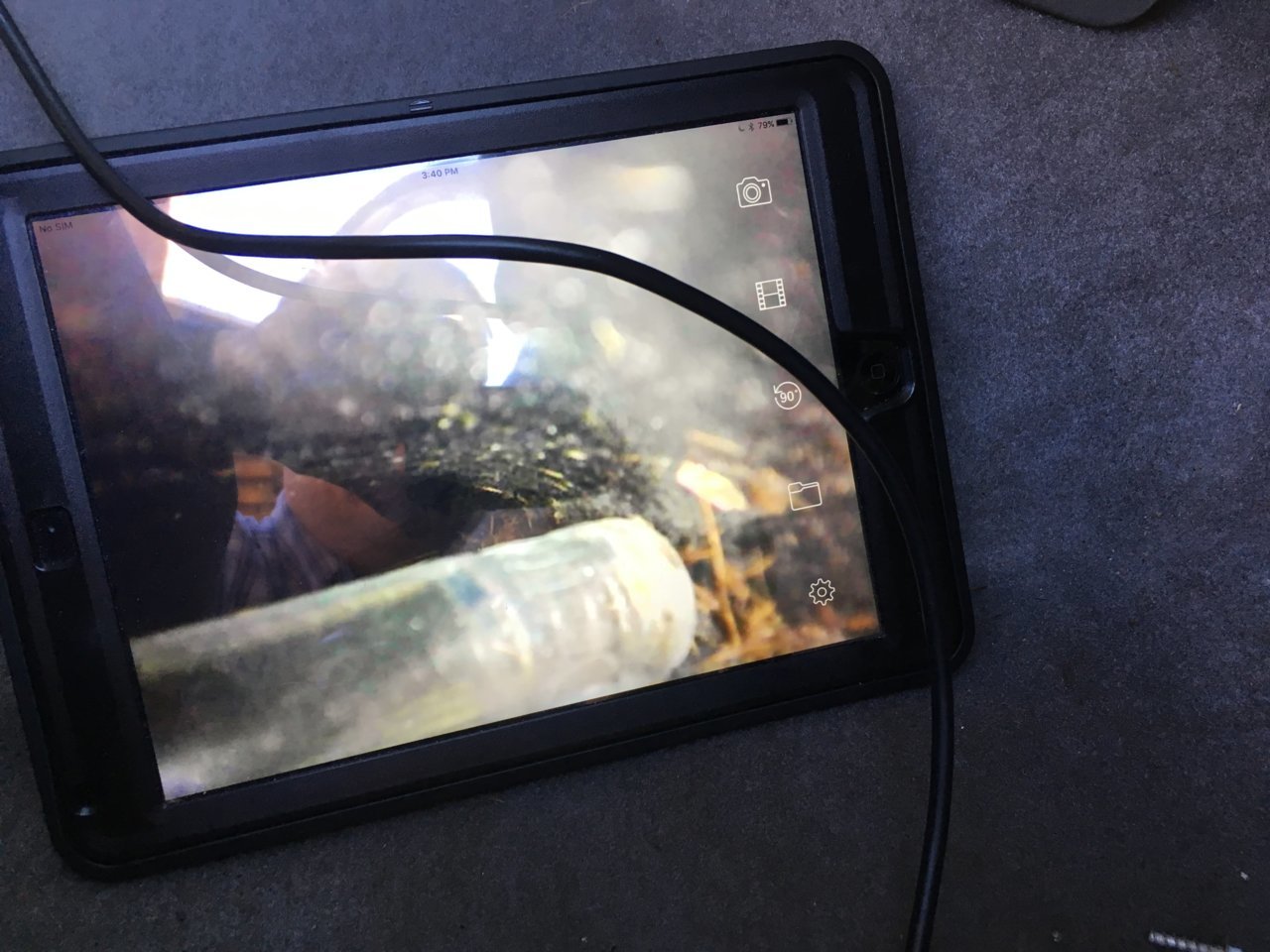

    Mouse Intrusion Odour Remediation
    As I have mentioned elsewhere, one of the major issues with this vehicle is that it say for ten years with no guard over that cabin air intake that mice love so well, and no changes to the cabin air filter. I'm not exaggerating when I say that there were mouse carcasses, and three-four inches of dung and nest on top of that filter. Additionally, it was soaking wet with urine.
    I spent a day in January, before the frame replacement, removing and disinfecting the cabin air filter area. I removed the blower fan, and soaked it in "Nature's Miracle" - an enzyme-based cleaner used for pet stains. I used a shop vac, weak bleach solution (covering the carpet, of course!), and more nature's miracle. I reached into the vent areas as far as I could, and cleaned for hours.
    The carpets and passenger side mat were discolored from years of this filth dripping out, and combining with a water leak (I have yet to solve this problem). I dried them as best I could.
    I then disinfected the rest interior with Lysol wipes, and vacuumed the cab.
    The next day, I drove the truck to the dealership for an oil change. It was a snowstorm, and I had to turn the heater on defrost. I almost gagged several times during the ride to the dealership. It was really putrid. I dropped the truck off, and that was that.
    Picking the truck up, I was somewhat relieved to smell far less odour, but it was still prominent. With the frame replacement done, it was time to start really taking action.
    The first step in the Remediation was to "bomb" the inside of the truck. The reviews on this material seemed positive, so we tried it on Friday night.
    We let it sit until today (Sunday), mid-day. Saturday morning I turned the heat on and let it blow around for 15 minutes to make sure the product was able to enter the ducts. Today the truck smelled like Chlorine a bit. If you put your nose to the carpet, the mouse/urine smell is still there, but it's very subdued. I'm not going to say that it didn't work, but it didn't completely eliminate it. Definitely helped.
    Cleaning up this odour is, I think, going to be a war of attrition. I work for an insurance company that often has to remediate hazmat spills. Our enviro remediation guy told me that Simple Green is a miracle worker when it comes to biological/ animal waste. He was right - All of the fins of the blower fan were stained with mouse refuse that had dripped through the filter through the years. Simple Green pulled those stains off, and the fan blades are pristine white plastic now. Every non-carpet surface in the truck was wiped down with Simple Green today, and I followed it with an Armor-All coat to revive the surfaces a bit. This has also helped, and the truck looks great!

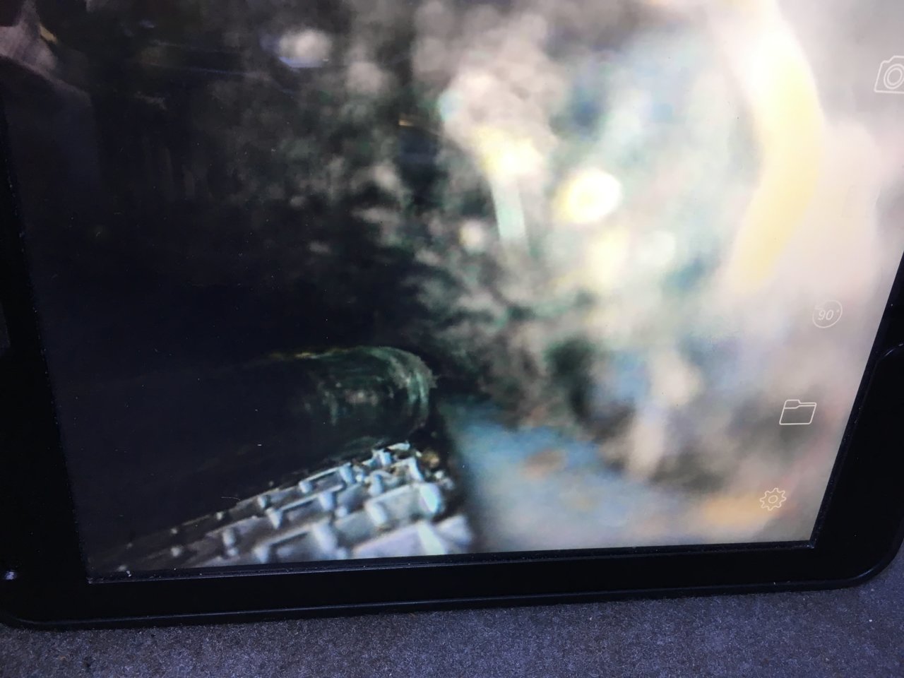

    Finally, the other concern I have had is that perhaps the mice were nesting down near the AC Condenser, in the center of the dash. Reaching this area for disassembly involves removing the entire dash, so I wanted a way to examine it before taking pieces off. The solution? A wi-fi borescope. These are used in my part-time job of Guitar Repair to examine braces and kerfing, bridges, etc in Acoustics. They can also scope out truss rod channels when pieces break off inside a neck.
    Here's what the borescope saw when it went in by the blower motor hole, into the condenser area. Please note that the scope is just the camera and 4-6ft of extension, which then projects the image by wi-fi to my iPad:
    The plastic tube you see is some beer line hose leading to a vacuum cleaner. I used the scope to steer the vacuum around, to clean the odd bits of fluff that had blown into that area. The really good news? After scoping out every vent in the truck, I see no evidence of mice nesting, as far as I can get the camera to reach. Doesn't mean they aren't there, but it's an encouraging sign that I may be able to beat the smell without disassembling the entire dash. Just some odd bits of dust and small pine needles.
    I know this is a lot of reading, but if anyone else has gotten an infestation as bad as mine, I wanted to let you know what worked for me.
    Ultimately, cleaning inside the ducts, and replacing the carpet are going to accomplish the lion's share of this. But it's a battle that was moved along considerably today.

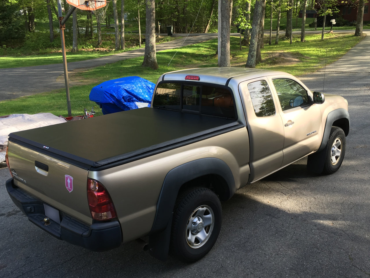

    Had some time Friday to work on the truck, so I got the Tonneau Cover installed. Truxsport by Truxedo - my neighbor with the big GMC 3500, 8' bed, came over to inspect this morning. He was really impressed with the latching system on mine, which I was glad to hear. It has an automatic tensioner to keep it from flapping excessively. Took a ride with it in the rain today to get some parts from @Tacoma/Taco (great to meet you!) in Maine. A few rivulets of water in the bed, perfectly acceptable for my purposes. Cross one more item off the list!
