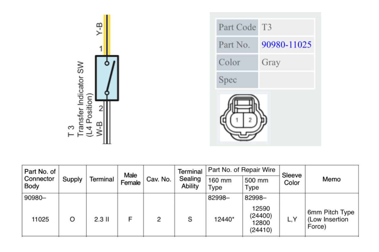

    The wiring to my transfer case actuator 4L sensor snapped right at the plug(female connector). Now I need a replacement plug, but have no idea where to start to get one. Any help would be much appreciated!!!

    If it's the one for the Low range detection switch it should just be a 2 wire plug. Yellow/Black and White/Black wires.
