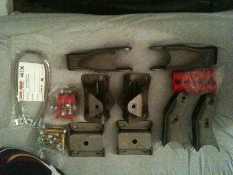

    5 lug, hmm I see. I have a question about this rear kit. Would the rear shock hoop fit a 6-lug? I called TC and they didnt say yes or no, they just said that the where in R&D for the 6-lug system. But from what I've seen (pictures on web) this system seems to just bolt to the frame, so, how would the # of lugs affect this?

    Um Im going to say the shock hoops can fit but the shackles are diffrent than the 6 lug and the mini retains the stock front hanger

    Instaled the kit.... Bolt on is a def An overstatement. The rear sits soooooooo high almost to my chest and I'm 5'10... Had to remove 3 leafs to bring it down to my hips/belly ... Still way higher in the rear in the front but I new that was going to happen.
    I also have to take it to a drive shaft shot to adjust the pinoin angle.
