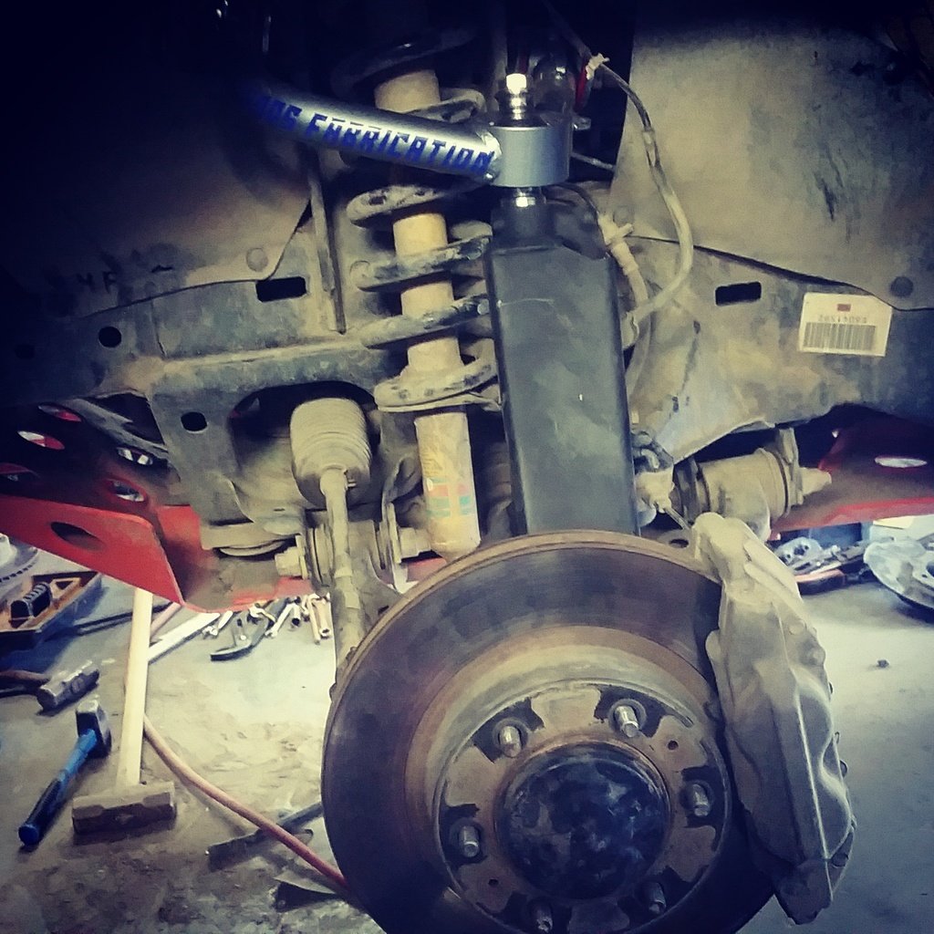

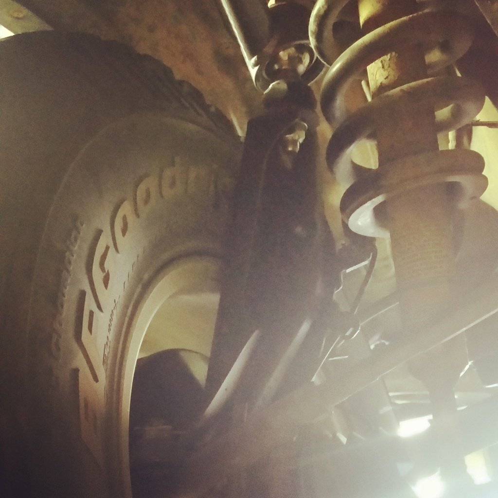

    So I threw on my tc uca and gussets this weekend a process I won't care to ever do again. Anyways I get everything back together this morning and suddenly my tire won't go back on. Like not even close. I did get the beefier sway bar ones even though I don't have a sway bar. Just wondering if anyone else has had similar issues. Tires are 265/75 r16 on Stock rims

    I've heard of this happening. I believe the oem rims back spacing isn't enough to run these gussets. So I'm thinking you need to get new spindles or get new rims with less BS at this point. Or on the cheap route you could get away with some spacers

    Well replacing spindles is out of the question with the amount of time I've spent getting this front end together. 1500 bucks on rims is an idea but I like the 200$ price tag on spidertraxx better looks like I'm walking to work tomorrow lol..

    Yea spacers are the cheaper easy route, I'd go with that.
