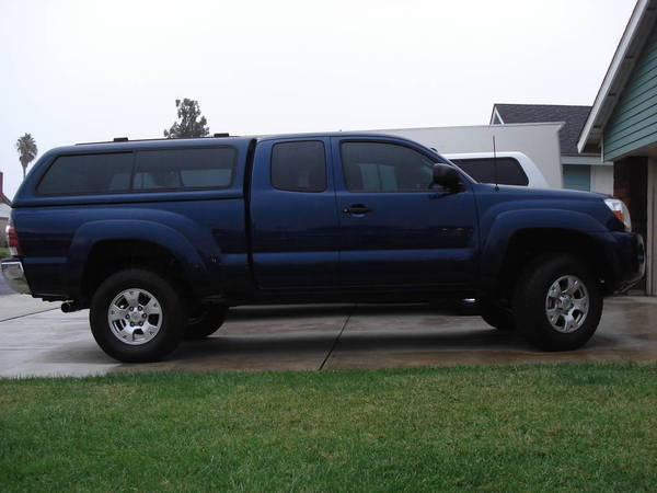

    What is your truck set at in the pictures that you have up?
  8. Oct 13, 2009 at 11:05 PM
    Kenny650
    Kenny650 Well-Known Member
    Apr 13, 2009
    #15944
    821
    The pictures I have on my profile and sig was my old 3" Revtek. Here it is with the spindles and 5100's set at 1.75

    Tinted windows, Upgraded door speakers with 10" Kicker CVT Sub, Pioneer AVIC D3, Magnaflow exhaust, Bilstein 5100 set to zero and Camburg 4" spindles
    That looks really good, exactly what I am looking for. Thanks for the help.
