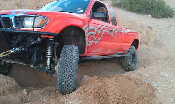

    alot of metal, small engine, decent travel.
    caged, camburg long travel, 50t leafpack (soon to be installed) light rack over cab, 5pt harnesses etc
    you can kinda see it right here....
    heres it part way through the build process

    Haha I'm fully digging the pictures of shame. this is only half way through ur build...looks done to me. Or r u talking about the back. Suspension wise looks like u finished it already. Anyways. Yea that's kinda how I want it to look. How did yours connect to ur frame. Was it bolt on or welded. And where is it connected by.

    its bolted on right now, but will be welded and tied into the cage. in this pictureVV you can see where its bolted on. see the shackle?(where the strap is) it has 3 bolts there, then right to the right of that and a little under theres 2 bolts going up. (you cant see the bolts) make sence?
