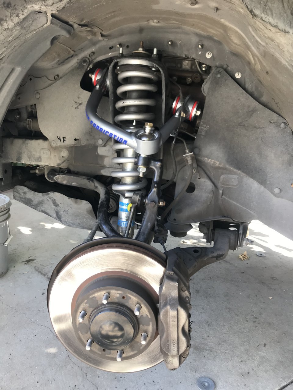

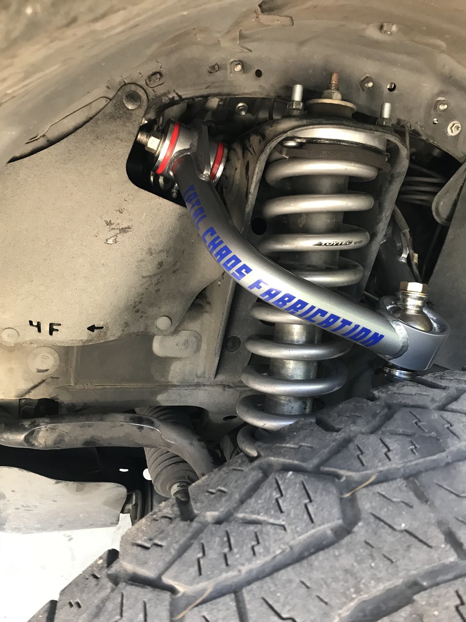

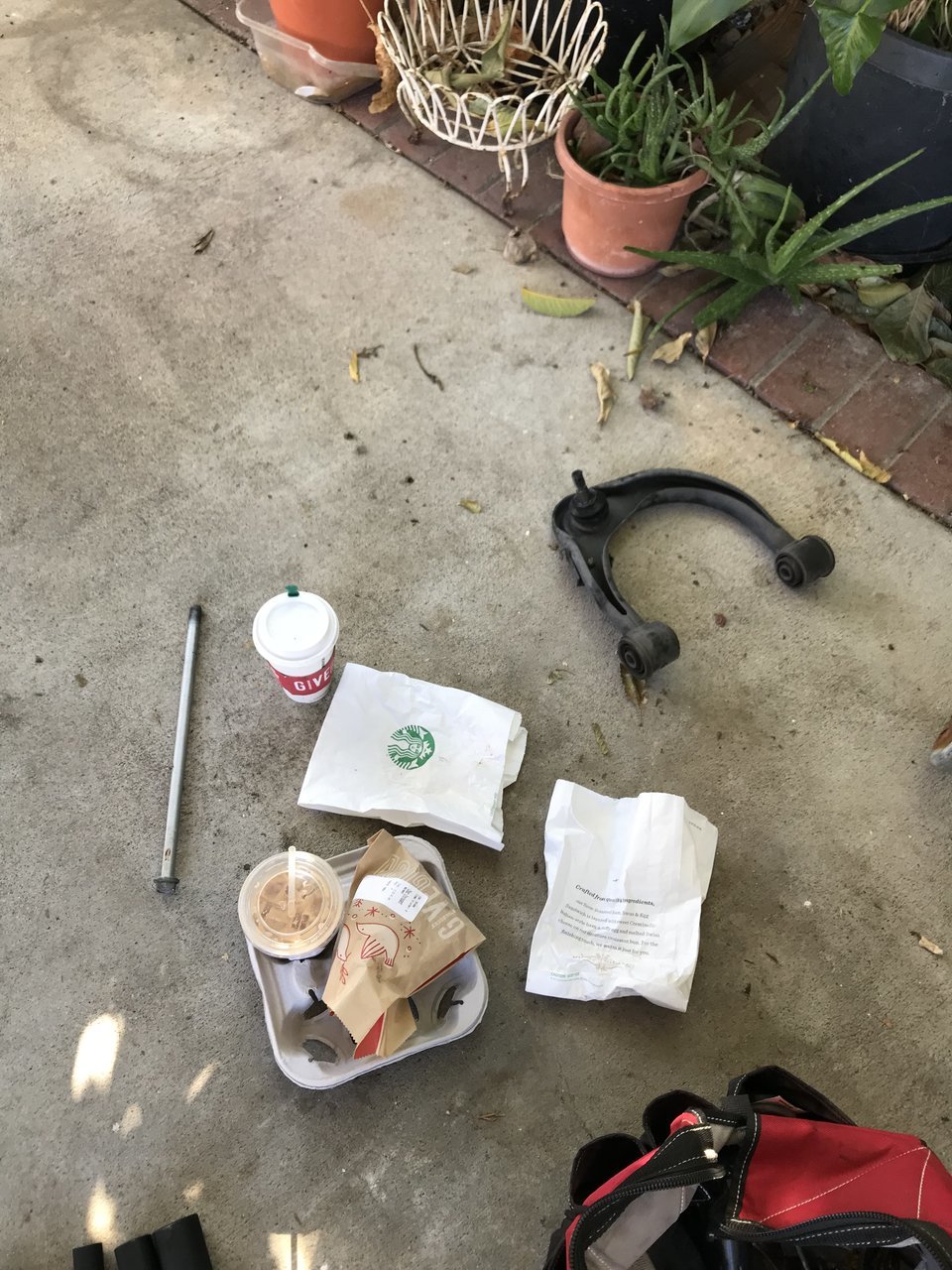

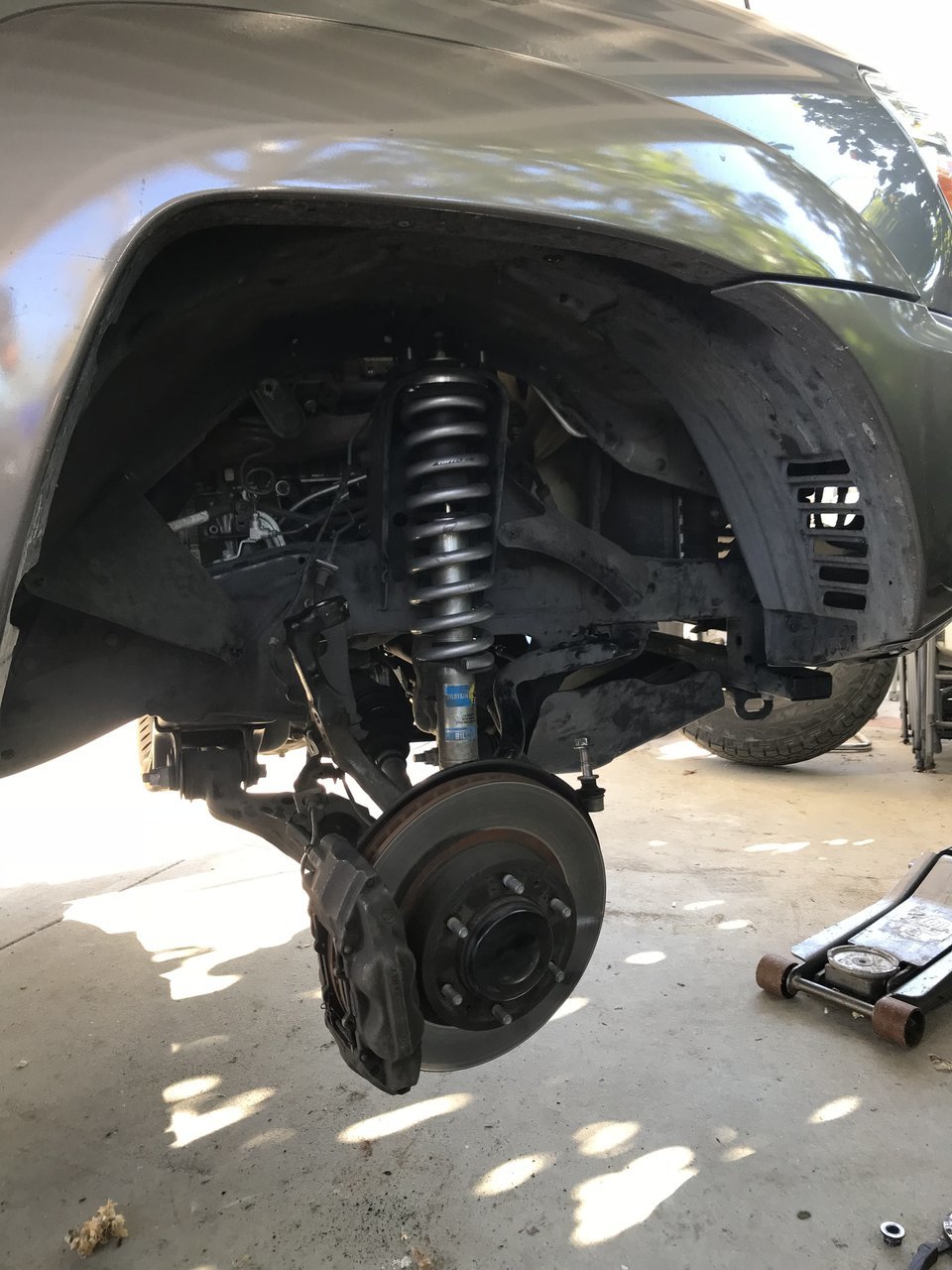

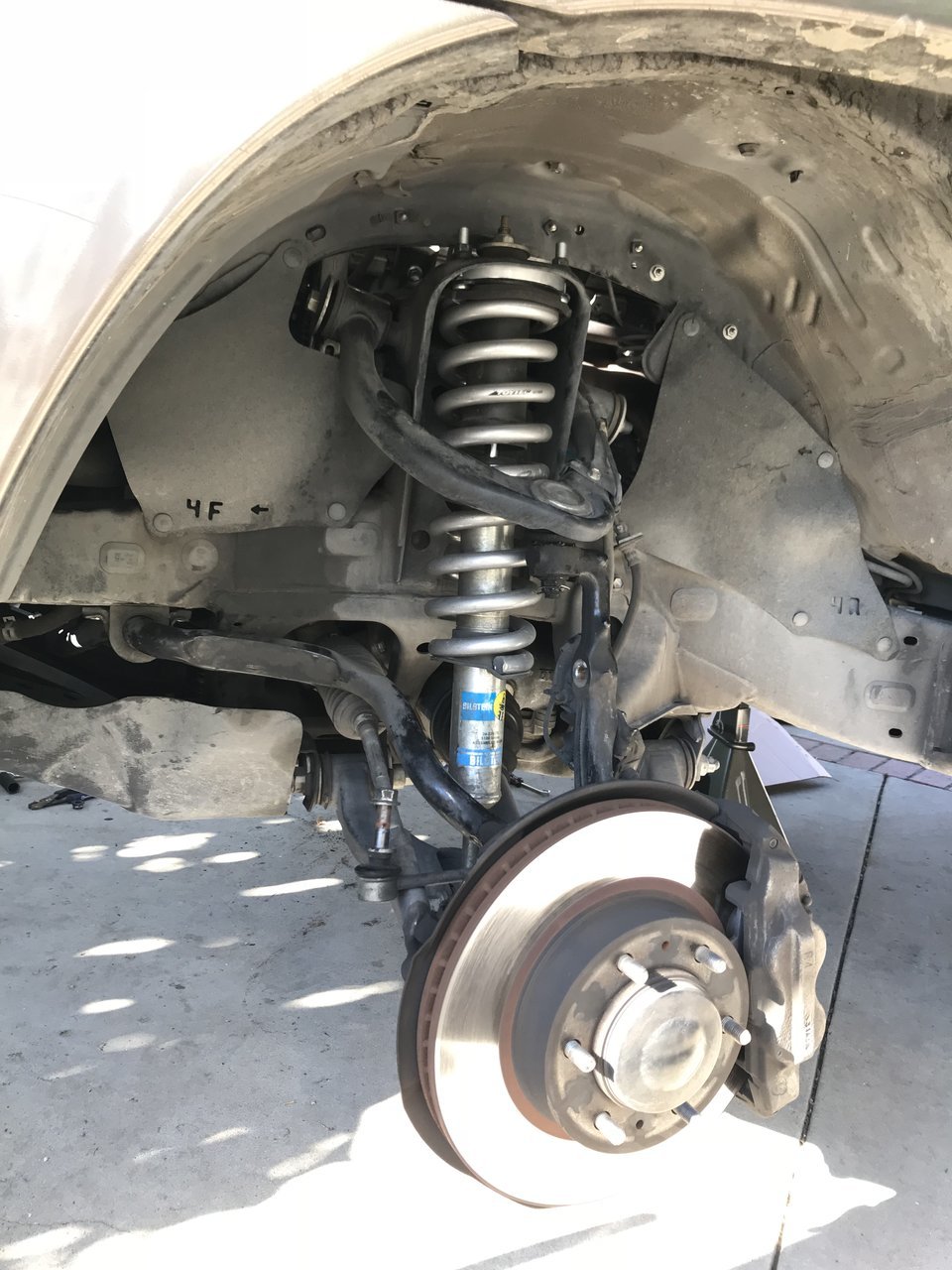

    Swapping out the stock UCAs for some TC 369A66C9-1ABC-472D-8243-17B531FBD1CC.jpg A7C495E4-294F-4E2E-8070-F7344C555C7C.jpg Some Starbucks to help us get through the install 9B60449D-CDB8-4471-966D-95511DF12B32.jpg EB67FC89-7BA6-4D10-B617-ED74A2FC7708.jpg The aftermath 54FDD61A-B999-4888-AF56-46C6B5AD3E99.jpg

    How's the ride after the install, compared to stock?

    Your bolt should go the other way so that if it becomes loose it won't work it's way out.
    Great work though and congrats!

    He cut the other bolt so he wouldn’t have to bend the sheet metal. Unless he bends it now, that’s the only way the bolt it going in. Hopefully he used some thread locker for extra insurance.

    Red Thread locker. That bolt is a pita on the passenger side. Nice upgrade op.

    They deffinetly feel a bit stiff I’m liking the ride, gonna take them offroading tomorrow to see the feel and break them in.

    Yup! Exactly that bolt was a bit difficult to remove , specially for the passenger side, I’m gonna double check on all bolts to make sure nothings loose and re torque, but this way for future if bushings ever need to be replaced or anything it’s not difficult for me to take apart And don’t have to worry on bending sheet metal.
