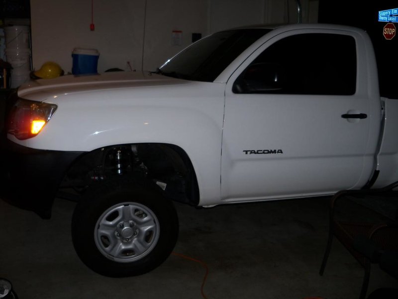

    gotta download pics. primary measurement 26 1/2 final meas 32 3/4. approx 6". taken on center of fender well, in line with hub

  18. Feb 28, 2011 at 9:22 PM
    #18
    Hotshot
    Hotshot [OP] Member
    Feb 27, 2011
    #52002
    18
    Ty
    Ca
    07 Taco 5 lug
    2.5 Icon coilovers, TC UCA
    heres some pics.
  19. Feb 28, 2011 at 9:25 PM
    #19
    schiz94
    schiz94 Thread Jacker
    May 26, 2009
    #17674
    4,235
    Caleb
    Bellingham,WA
    08 Tacoma Reg Cab
    Morimoto Projector Retrofit, alpine cda-105,Wheelskins leather wheel cover, wet okoles,5% tint on back and 24% on front two windows,Debadged tailgate,custom sockmonkey centercap decals, xr rims pced gloss black.
    eww i thought you had bigger wheels and tires haha haha
  20. Feb 28, 2011 at 9:36 PM
    #20
    Hotshot
    Hotshot [OP] Member
    Feb 27, 2011
    #52002
    18
    Ty
    Ca
    07 Taco 5 lug
    built it today, tires tomorrow. so adjust the preload is what i get out of this. thanks for the help.
