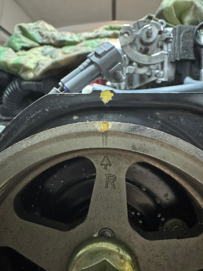

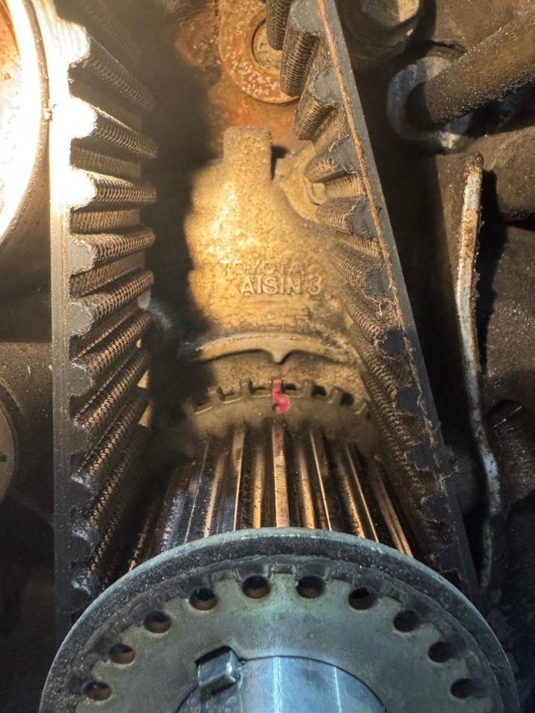

    My vision is proving problematic with determining if I am TDC on my 2001 3.4l.
    Please let me know if I am good to go. Thanks!

    Looks good to me. Make sure you rotate it over 2 full rotations (of the crank pulley), and recheck (if you have not already), before reassembly
