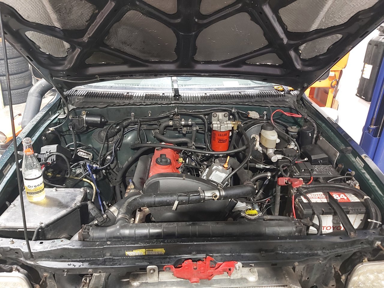

    Excuse the wiring mess, but this is an 03 ALH in my 03 Tacoma. They fit very well, aside from needing to notch the oil pan. Wouldn't recommend this swap to someone who doesn't have either a) fabrication skills and a welder or b) a friend with fabrication skills and a welder. These swaps arent cheap either. A proper one will easily cost between $5000-$7000 depending on what you do for upgrades, who builds your stuff, etc.
