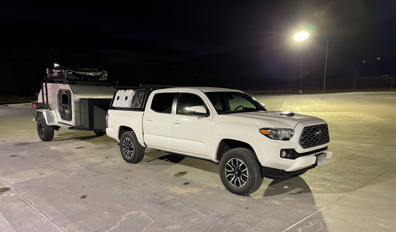

    I am interested to know the basis for comparison used for "they tow like shit". My thoughts immediately below and about me at bottom. Take ALL advice on TW with a grain of salt (including mine) and before you believe some random person on a forum on the internet, request they show you their trailer.
    • A trailer brake controller IS ABSOLUTELY necessary IMO for those "oh crap" situation where you need to stop in a hurry because a random Elk wants to play chicken with your taco. It is also required by law for a teardrop that size and the trailer comes with brakes. I recommend the Redarc Tow Pro elite and have towed my XOC through Colorado without issue.
      • Edit: my apologies for the misinformation, I looked up Colorado law and 3K + lbs. is the threshold where CO law requires trailer brakes. It is up to you OP, but I wouldn't think about towing 2K+ through the mountains without a trailer brake. 42-4-223 is the code section.
      • Here is my brake controller install post
    • I use a Scan Gauge II to monitor TP1 and TP2 transmission temp readings in real time - I highly recommend some sort of ODBII display app or device to anyone who tows so they can see, in real time, how transmission temperatures are effected as driving conditions change.
    • My XOC is 3500 GVWR on Timbren 5000k rated suspension and I have a max coupler articulating hitch. I have been over Kenosha Pass in high winds and didn't even know the trailer was behind me. I have towed my XOC across I 80 at freeway speeds in strong headwinds with big rigs and have had zero issues with sway. Also: ignore anyone who recommends a weight distribution hitch teardrops do not need them.
    • ECT mode just moves the shift points in the electronically controlled transmission to hold shift points longer to accommodate towing
    • Search for "Tacoma Towing Bible" and read up on why OD gears can be a bad thing in certain towing situations. With stock gears I never go into S6 when towing and only use S5 in downhill or flat situations where the Taco doesn't have to work to maintain speed. If you are in OD gears and the Taco is working to maintain speed you will see the temps leaving the torque converter (TP2) get hot quick.
    • Don't be afraid to run your Taco in the 3-4.5 K RPM range. Through the Colorado mountains (285S) from Denver to Salida there were parts of the drive where I had to drop down to S3 and S2 in a few steep cases to maintain speed. Our V6s have more horsepower than torque and peak HP happens at or about 5K RPM so these engines need to rev to get the most HP and TQ out of them. Some people get uncomfortable when their motor goes over 3.5K.

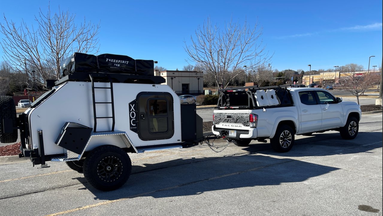

    My rig:

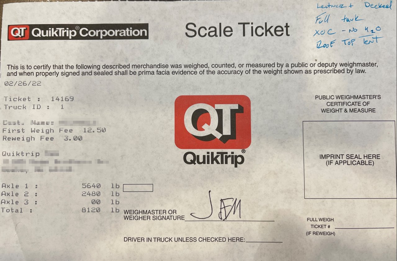

    Note: I am running dry here since temps are below freezing still. about 350 lbs on Axle 1 is the trailer tongue weight. Keep that in mind.
