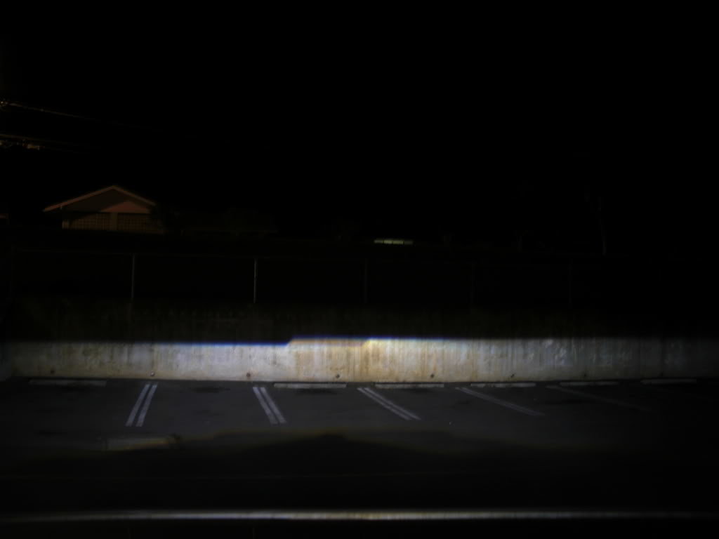

    I'm real close. When adjusting the beams, should the step ups line up with each other, or should there be a gap between the two? Basically, when the low beams are on should I see one step up, or both when I'm looking at a wall?

    Should have two. Here's what mine looks like. This is roughly 25ft away.

    Awesome, thanks a lot!! Does it really matter how far apart they are? I know that depends on distance, but if anyone could give me a rough idea that would be great. I can't get to far away from any solid walls, so I have to use my garage, so I have maybe 10 or so feet to work with, maybe a little more.

    ^ the same distance between the headlights. might be a little off at 10 feet when you back up , but thats an easy fix if you get it close now.

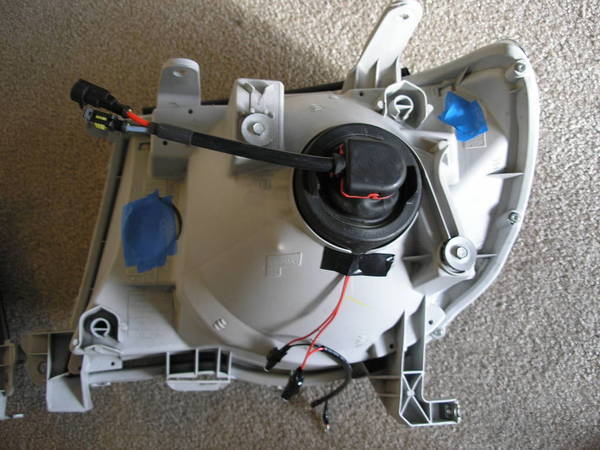

    Hey Rhino, here is a pic of what I did to the rubber gasket on the back of my headlights. I trimmed about a half inch or so from the opening much like ElectronMan suggested in his write up.

    Thanks, I got it all together. It is amazing!!!! I love the output!!
    The only issue I have is I stripped one of the black plastic adjustment screw holder things that is attached to the back of the bowl. I'll have to fix this, I'll have to see if someone has a trashed light with an intact adjustment thingy, I'll just swap them out sometime.

    I had the same problem, and what I did was put lock tight on the threads that of the bolt that go into the adjustment thing and once it harden up it was fine.
