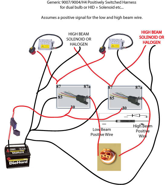

    after hooking up the solenoid to the factory flash wire, I found when I flash or turned on the high beams, the solenoid would activate, but the bulb would turn off. How did you go about changing this so the ballast wouldnt turn off when you turn on the high beams?

    you fix it by having a correct wiring harness. your light goes out because you have your low beam light signaling the ballast. but when you flash your highs, the high wire activates, but the low wire is no longer part of the circuit, therefore you ballasts are no longer powered, which means no lights!! this is the reason for the diode in the following circuit.
    here is a schematics that you can use. our 05+ tacos are postive switched fyi...

    yosh do u have a pic of ur wiring where is everything tied together?

    no, but if you go over to HIDplanet.com forums, in the university section, there is a huge thread of wiring schematics...i pretty much am following the above posted diagram, but i will have a separate relay for each headlight and then the highs, for a total of 3 relays.
