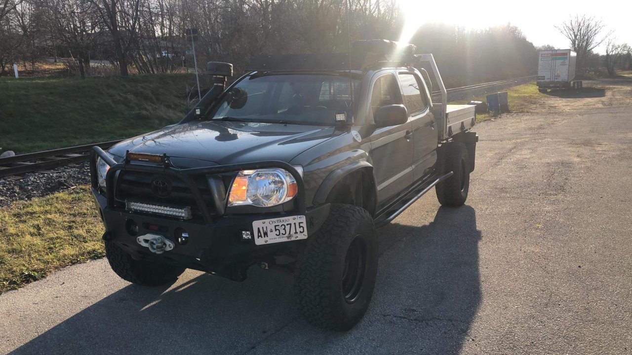

    tacoma16
    tacoma16 Well-Known Member
    Mar 15, 2011
    #53109
    11,160
    Peter
    Ontario
    Double cab SR5 4x4
    it lives
