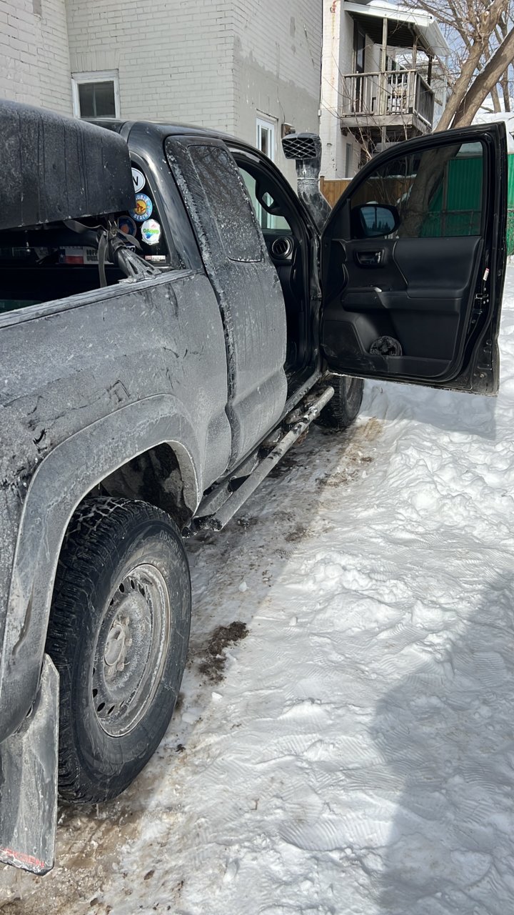

    Mine do double duty

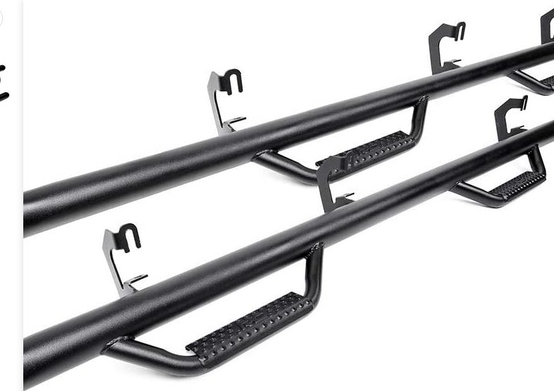

    the OEM side steps/ nerf steps like so:
    will do more damage to your truck than if you had simply taken them off. unfortunately i dont know what you have on but side steps and sliders are 2 different things.
    Side steps are just that, enough structural rigidity to let a 400lb gorilla step onto them to get into the vehicle.
    Slides on the other hand try to be as structurally part of the trucks frame (in terms of mounting and support braces) that it can (and should) be able to support the entire weight of the truck while on them. so instead of lifting the truck from the jack point, you can use them.
    Material wise: Nerf bars and the OEM steps are anywhere between light-duty steel to aluminum and will tear off the truck if hit incorrectly.
    Sliders are generally DOM (Drawn on Mandrel) steel tube which has a higher yield strength. these are meant to take a beating.

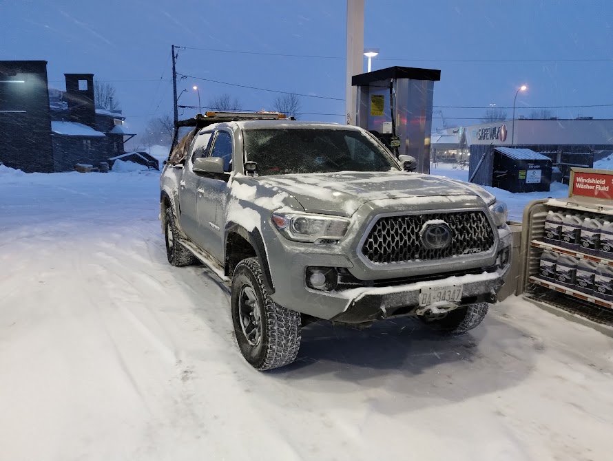

    this: horrible and inhumane

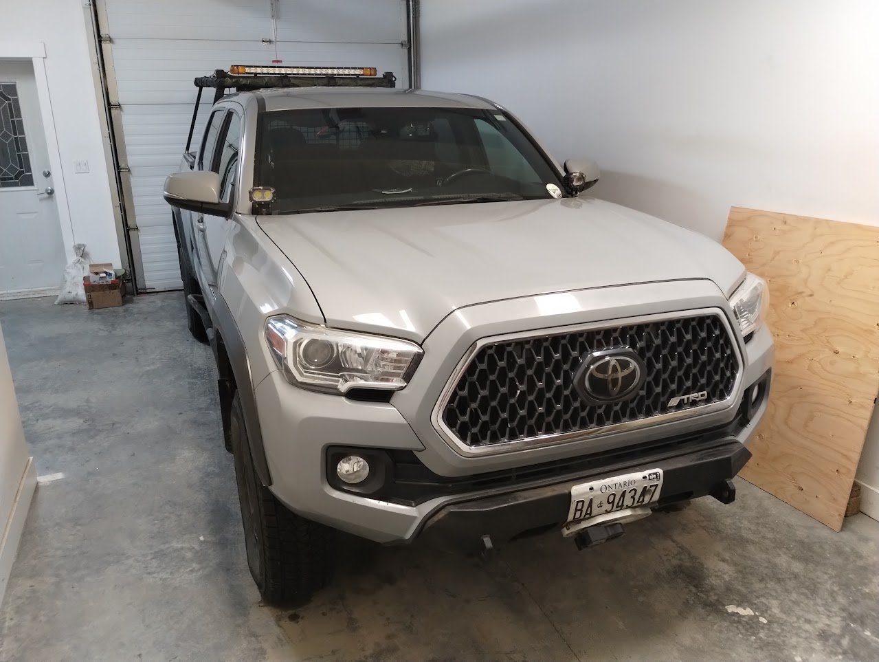

    this:Loving and caring, keeping it warm
