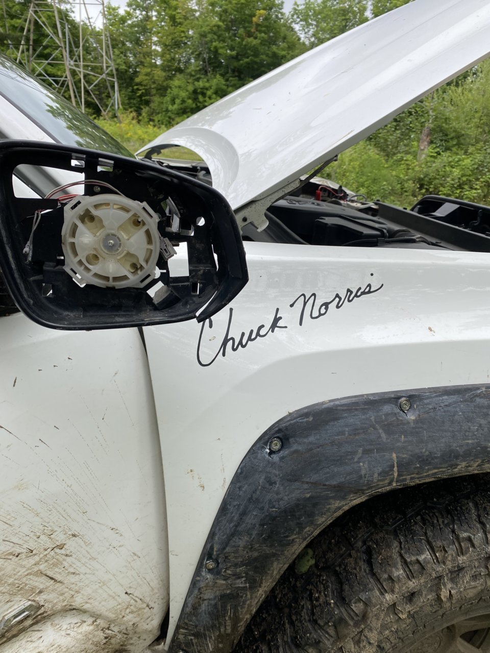

    Broken passenger side mirror
    Dented beds
    Dented doors
    Bent sliders
    Cracked steel bumper
    Torn fiberglass bed
    Broken tail light
    Starter kaboom
    Something rattling when in 4WD
    probably other issues once washed and cleaned…
    That’s the list between me, @Windigo and @tacoma16

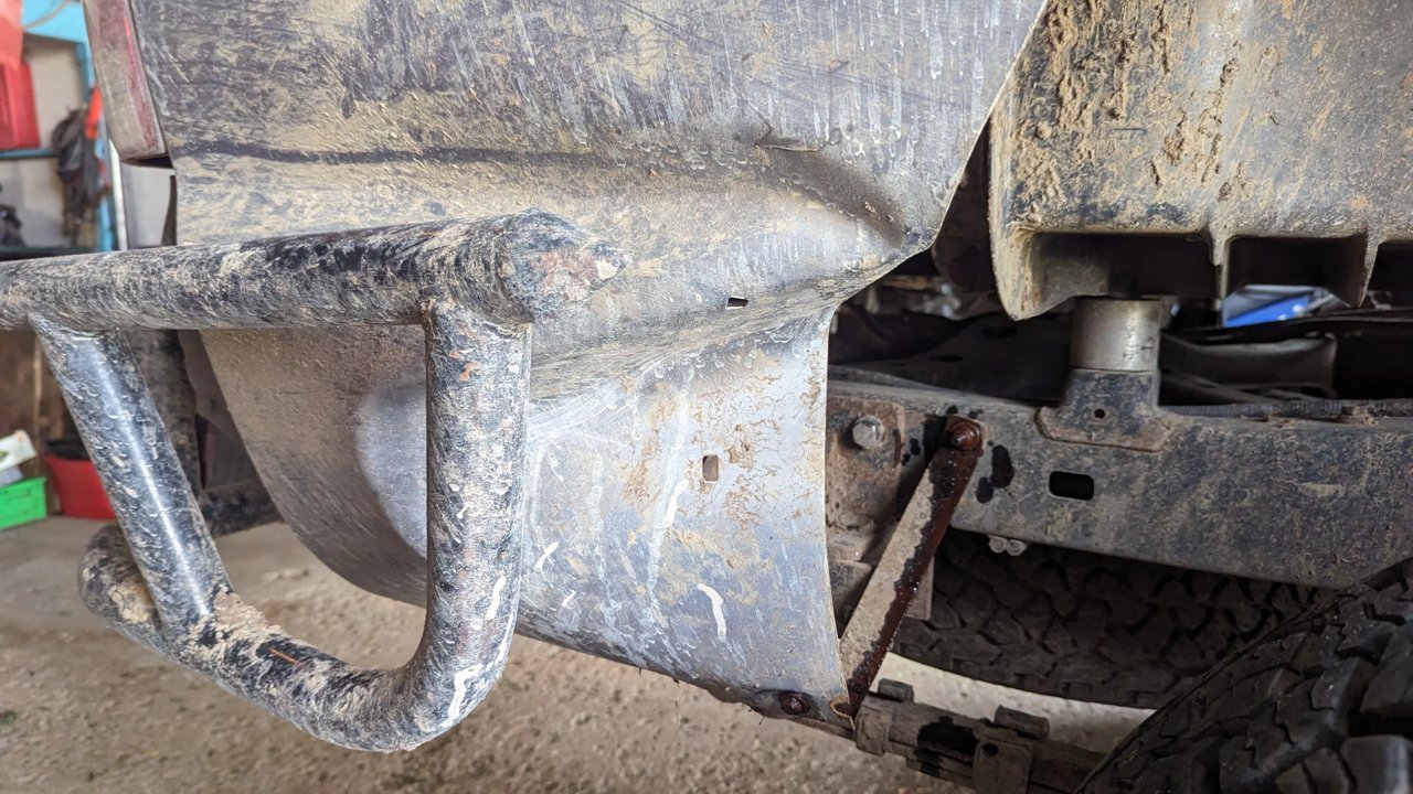

    speaking of repairs, I think my biggest one is fixing the bumper and maybe adding some grease to the winch to help with freespooling

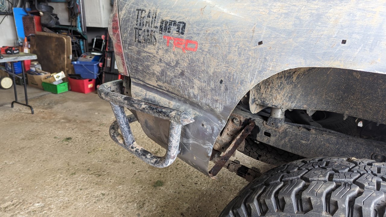

    I'd take the edge or a grinder and v out that crack. and I'd weld 1" segments with a break in between in case it wants to crack again it will stop after the first break. it will look funny but just a suggestion..

    That was the plan. Going to use a bur bit to groove it out. May drill a hole at the end of the crack to help it, then plug it all. Good thing is that it’s just the wing of the bumper so nothing structural from what I could find.

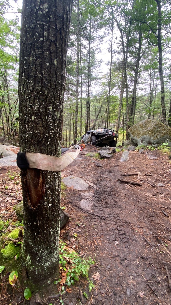

    55 and still at it. Lol. Thanks for taking this pic.

    Thanks for pulling line lol. greased the freespool knob on the winch and she is buttery smooth now.

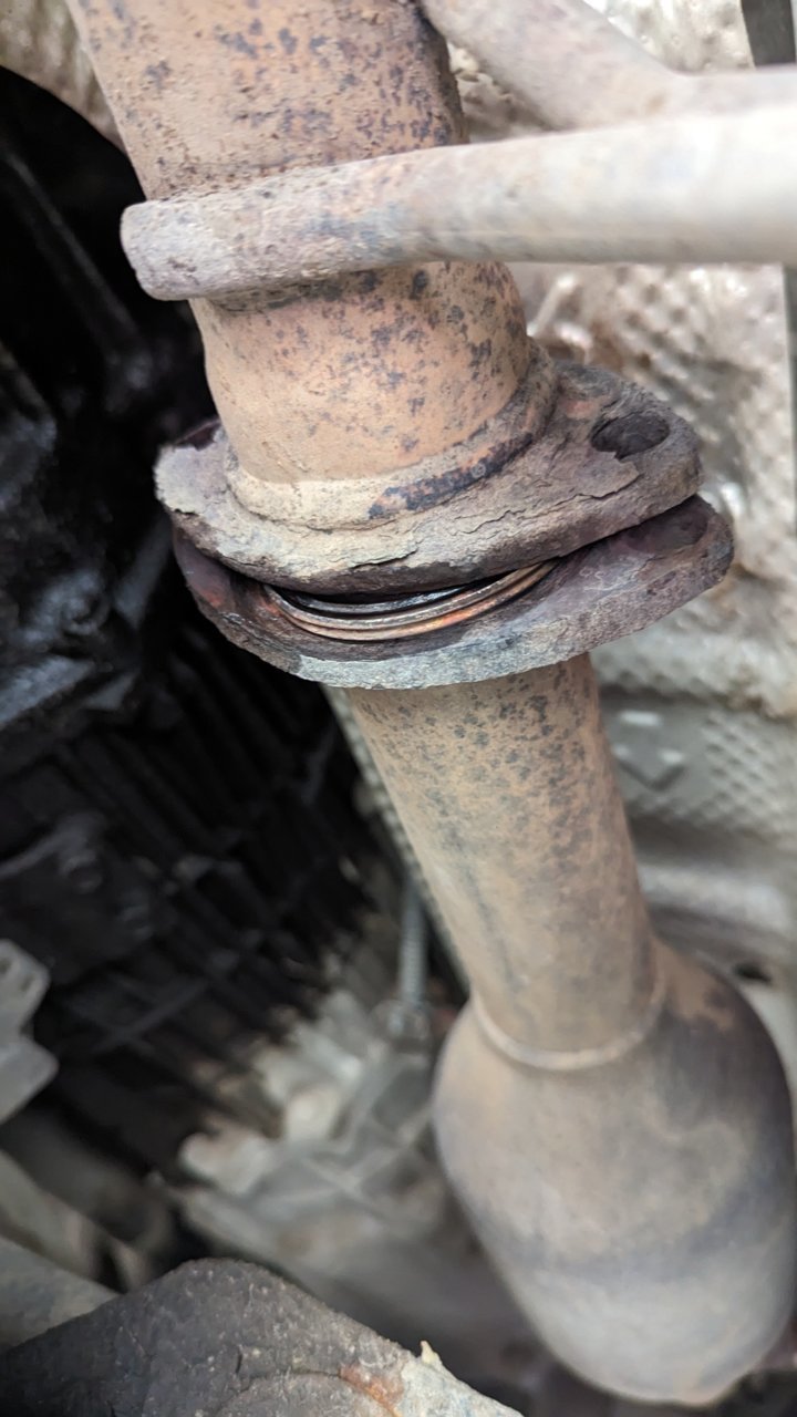

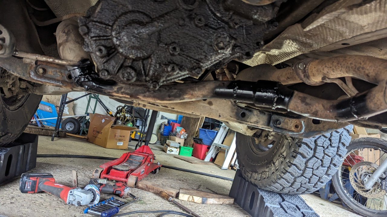

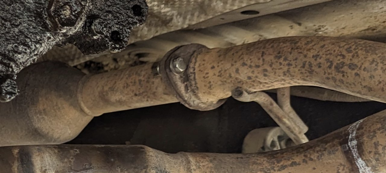

    Some B4 and after. Not professional but good enough. I did not remove the bolts from the exhaust my skid plate did:)
    I figure if I have.to do a exhaust reroute might as well try something first
