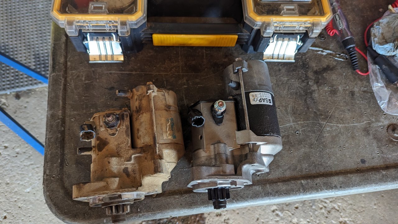

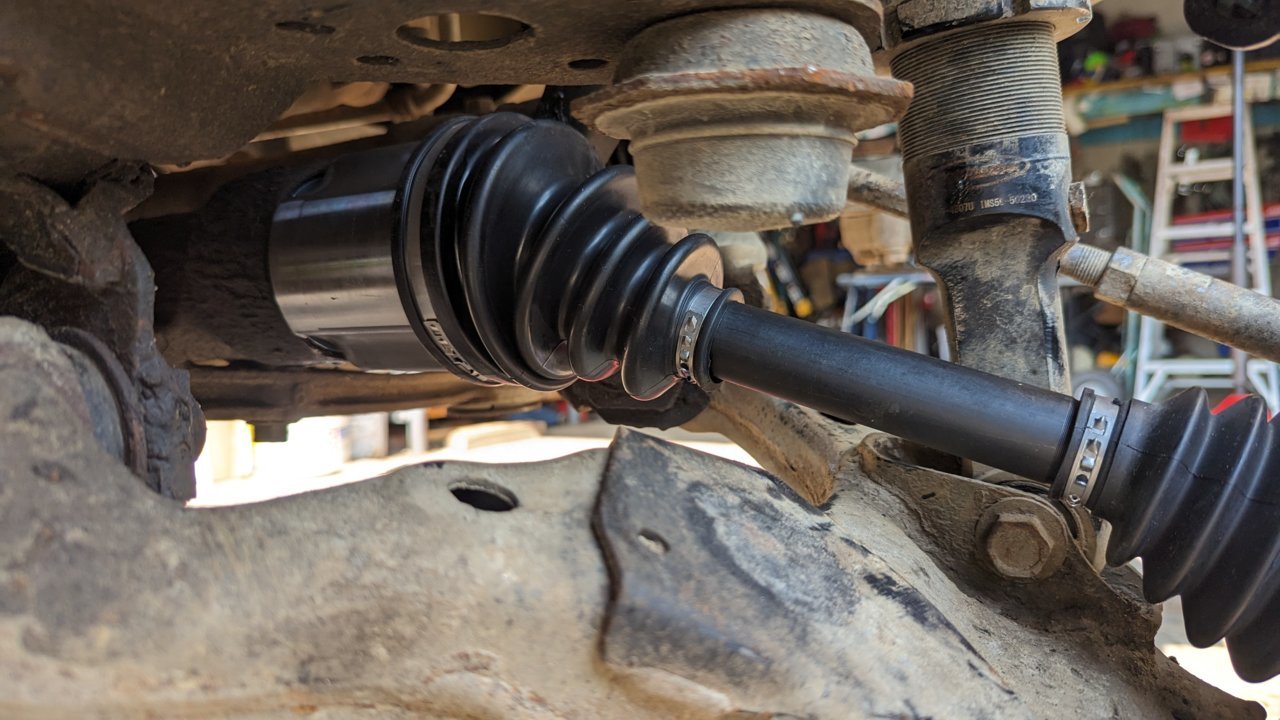

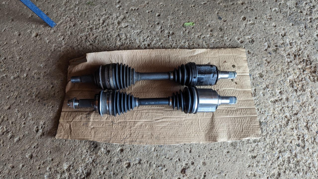

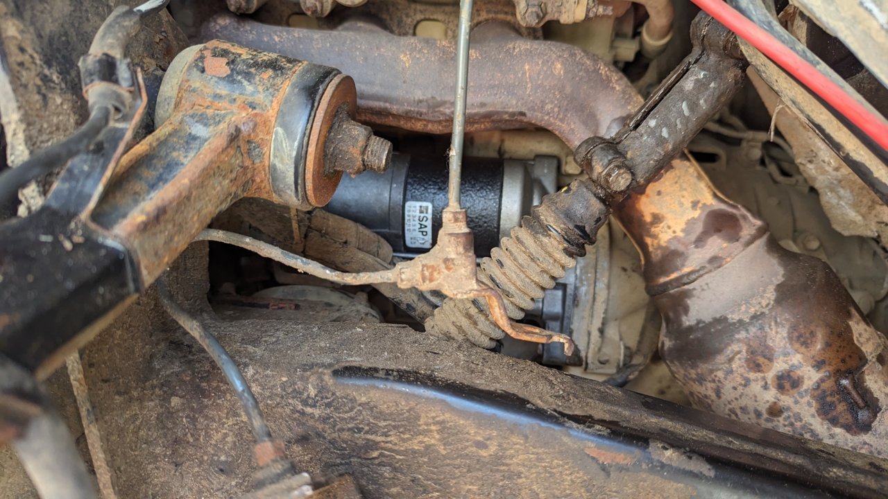

    Well the repairs keep coming.
    Starter replaced today. Of course like most things it's not the same as the original it's bigger. Well it works.
    Also 2 new front shafts.
    Crappy tire jobs. Lifetime warranty

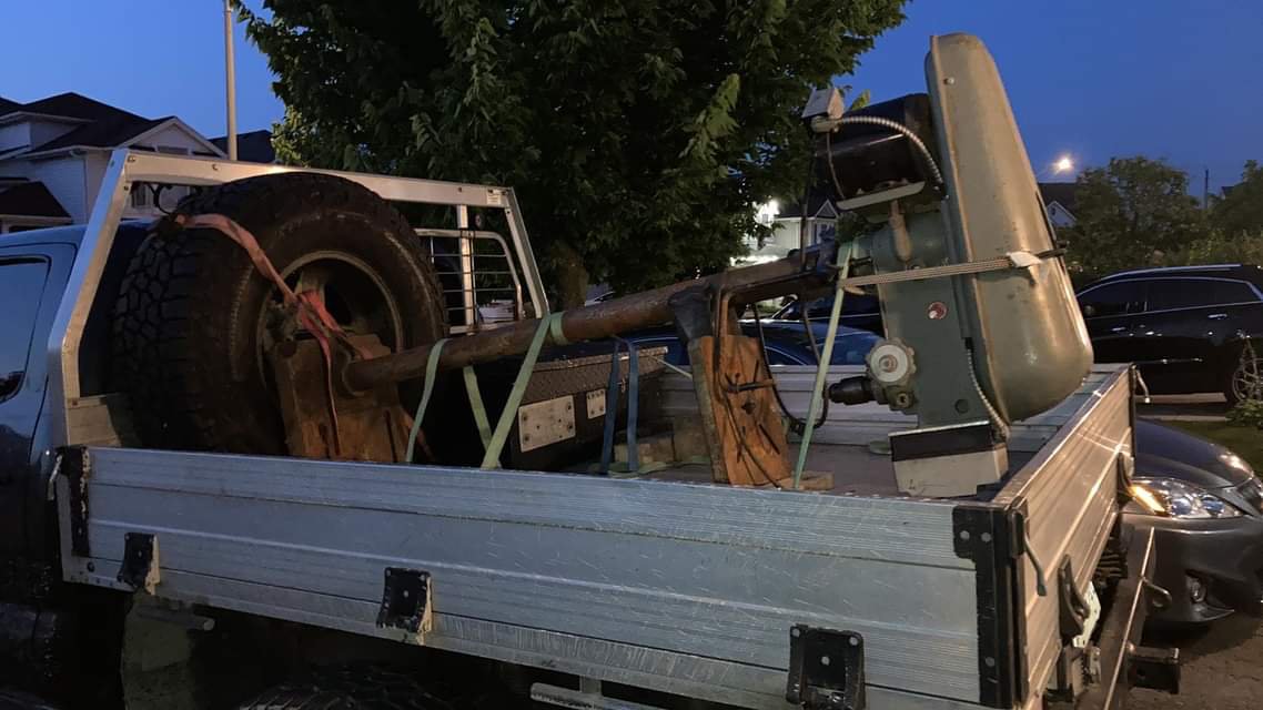

    I’m thinking it would be the cv making the noise. If it was the tcase I think it would be even while driving. Hope that fixes it!

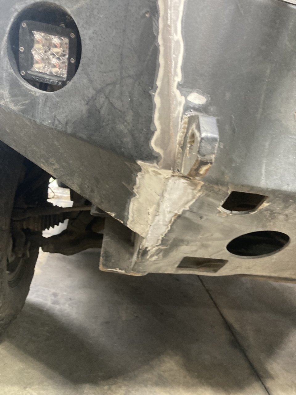

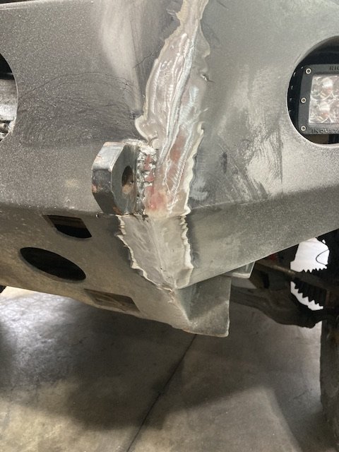

    I ended up fixing my front bumper and then used the truck to get some stuff
    Drove 6 hours round trip to grab this drill for a family member
    Other then the odd rattle trucks good.

    That drill press is older that me and you put together. There the most reliable ones. :thumbsup:

    Thanks. Old buffalo 15. Uncle had me go grab it for him. No room in my shop for it. One day maybe though.

    thank you hope it dose too. and no more click, click, click, click, click, click, click, click...start. lol.:cheers: and nice bumper repair that bumper is a tree magnet:)
