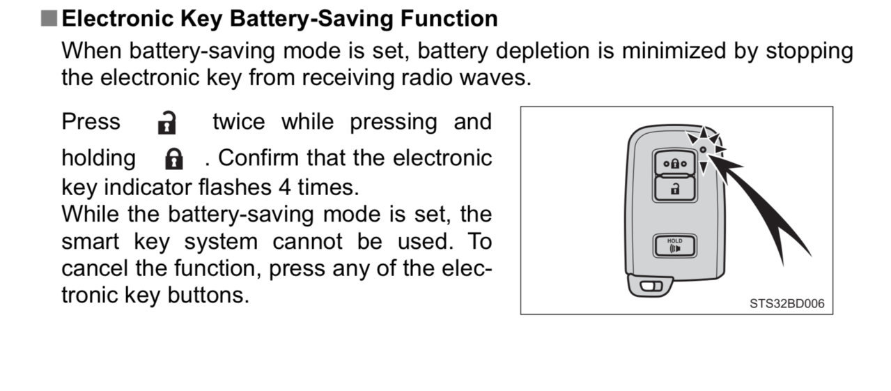

    You can turn off the smart key from broadcasting and lock it anywhere in the truck, assuming you can gain access using the app on an Apple Watch or your phone. To turn it off, press and hold the lock button and then press the unlock button twice. The LED will blink a total of 4 times to confirm it is off.

    Can’t you just turn the fob off. I’ve seen other use a hitch vault. Lock you stuff inside the receiver.

    Turn off fob as others have mentioned, remove the fob "key", lock truck leaving fob inside, store key in wetsuit key pocket, surf, unlock driver door with "key", press any button to activate fob, return "key", drive away to your favorite taco joint. :cool:

    This one looks to be the easiest one, with turning off the fob in second place.
    Well, on second thought .....I think it's a tie.
