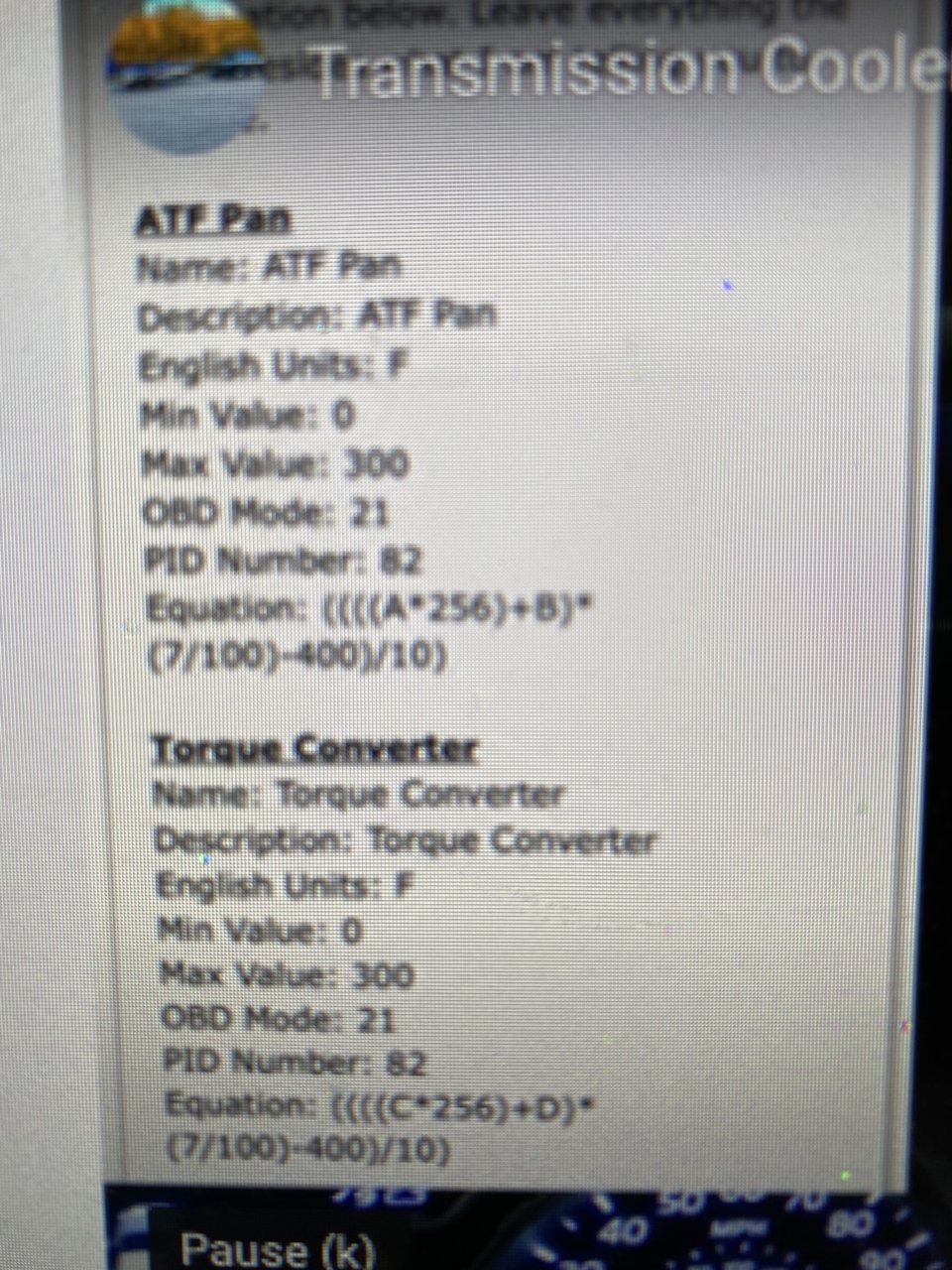

    Hi Planning to use a VeePeak and OBD Fusion app to monitor my transmission fluid temps. on an iPhone. I got these values (which were posted for a 2020 Tundra). Just wondering if they are the same for 2021 Tacoma Sport Edition or if someone has the proper ones. I'm here to admit - that I am not really a tech, so this is a learning curve for me. Maybe there is an easier way, for dummies ! Thanks Scott

    Found this in another thread

    IMHO, if you are using OBD Fusion, it is well worth the $10 to buy the pack that has everything already programmed for PIDs for your particular model year
