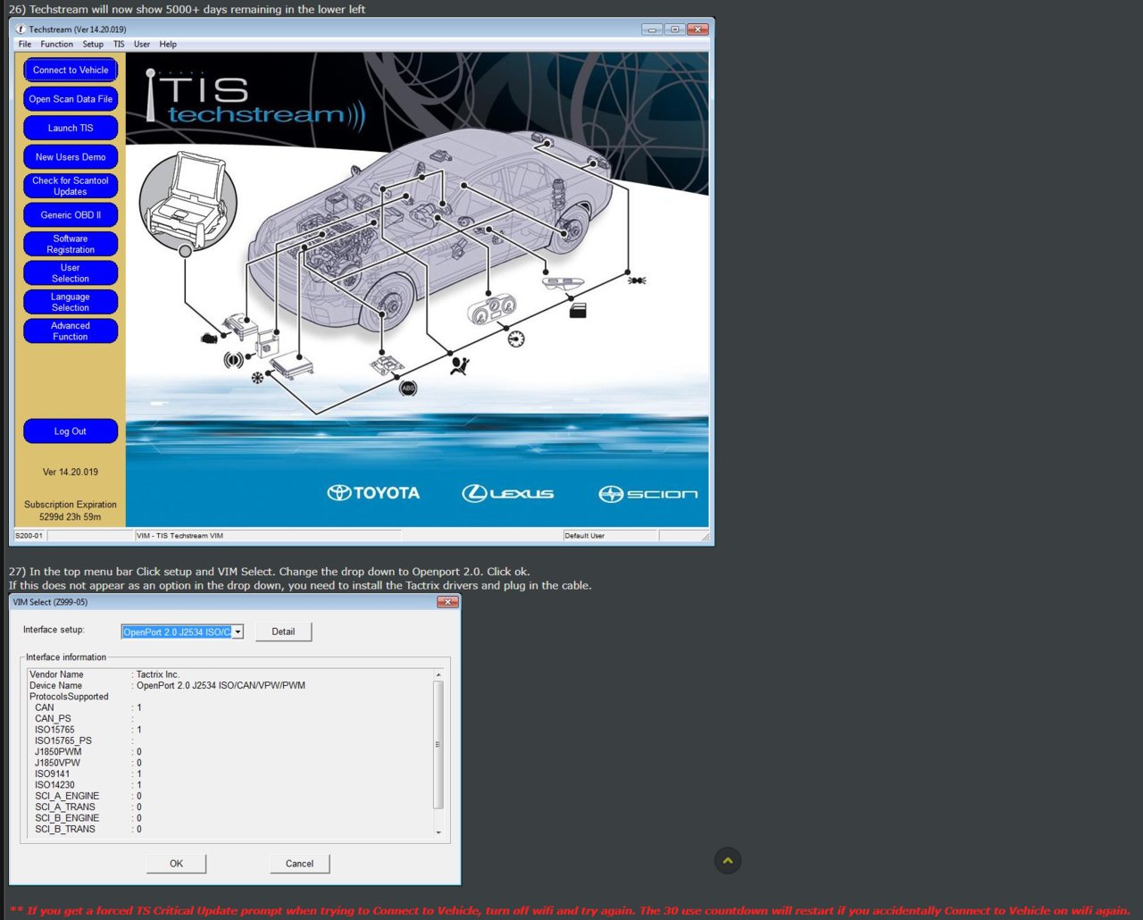

    Hello Tacoma Ppl,
    I need help with my techstream it was working fine, then all of a sudden when trying to used it the other day on trd sport I am getting vim error. It is v16. Any ideas how to rectify.
    Cheers

    Go to the Setup menu (I believe), click VIM Select, and make sure that your adapter is the one selected.

    I tried that , same problem

    Possibly try reinstalling the drivers? They might have gotten blown out.

    Will try that
