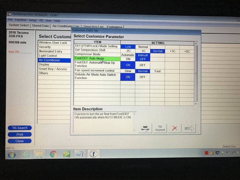

    Thanks to the forum I had to get a cable and install TIS Techstream and play around with settings. Got rid of the annoying seatbelt warnings, changed blinker settings, etc. I'll be doing the Lexus card style key soon and can program it myself now too.
    One option I wish to change is the " auto" climate control and how it directs the air to feet only. There are a couple settings that seem like they would be related to this but I didn't get the desired result. Below is a pic of said settings, maybe someone has an idea?

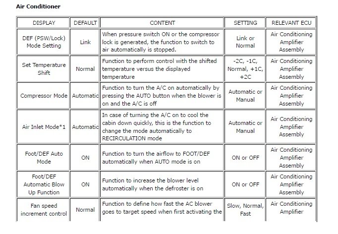

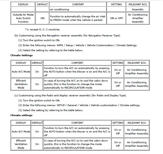

    This PDF gives a little bit better description of the customization.

    So by that chart, in the air conditioner section, foot/defroster auto mode should turn be on by default. I wonder if this is only when running the AC, or if it should when running the heat. By default, mine will melt my feet when the "auto" setting is on, and it only directs air toward the feet. I would love for it to split the heat between the defroster and feet.
