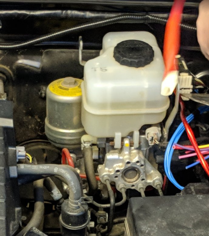

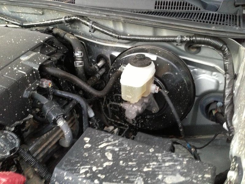

    Depending on which setup you have this might be why you can't do it.
    I know there's 2 different Brake booster setups, the regular vacuum pot style and the fancy new style with accumulator for VSC. On my truck 05 with the vacuum booster i know you can't bleed the brakes with Techstream or any compter, but have done it on a couple others with the VSC accumulator.
    Vacuum booster, with the ABS(actuator) brick on the passenger side.
    VSC Accumulator with ABS(accuator/pump) built in

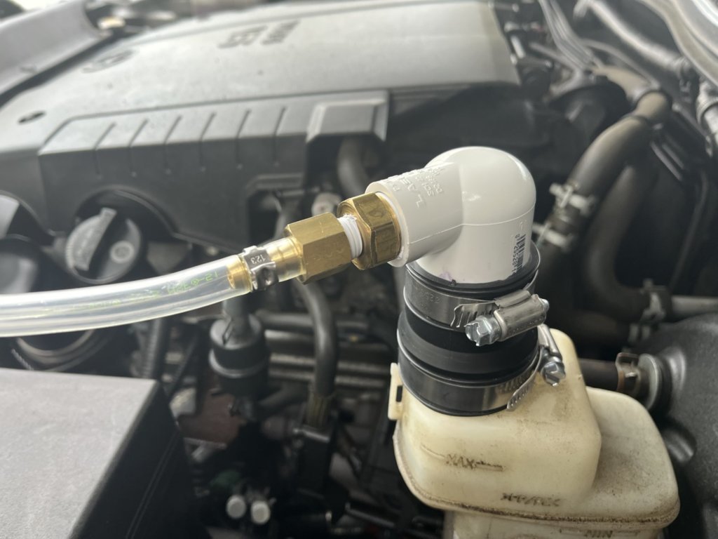

    I have a power bleeder, but I don’t have any adapters that fit on this master cylinder. I need to look around and see if they make one.
  11. Apr 22, 2025 at 3:41 PM
    Micbt25
    Micbt25 Well-Known Member
    Jan 12, 2020
    #315844
    594
    TM
    2015 MGM TRD Sport Access Cab 4X4 V6
    They do make adapters or you can make one, which is what I did:
    Or you can buy a BA10 adapter.
