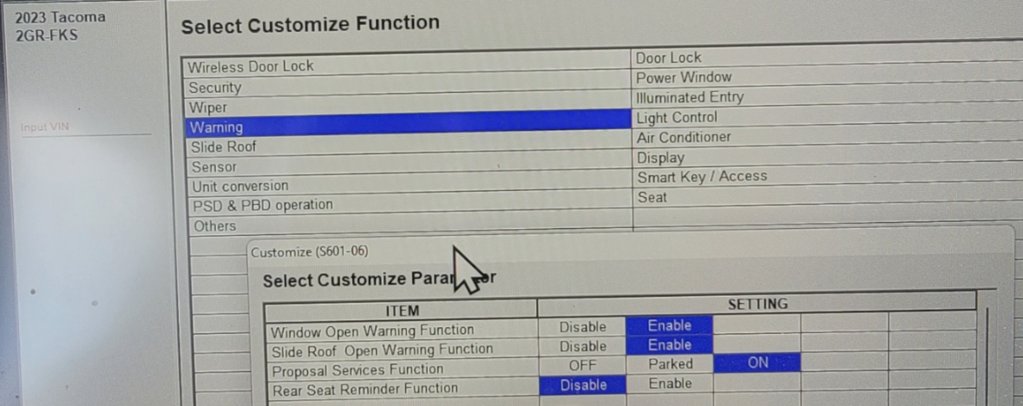

    Finally got around to this, but couldn't find the seat chime. I was able to disable the "rear seat reminder function" but can't find anything under warnings for the seatbelts. Given your advice (that engine etc doesn;t matter) I even tried looking under the 2023 Rav 4 HV, 2023 Tundra HEV, and 2023 4 Runner modules, but found nothing.
    Most Warning sections looked like this:

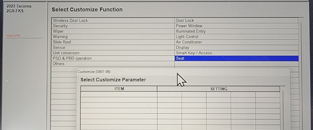

    and many are just blank:
    I'm curious what model you selected? I'm returning this cable to Amazon, but have a few days to drop it off. I may just bite the bullet and get a Carista :(
