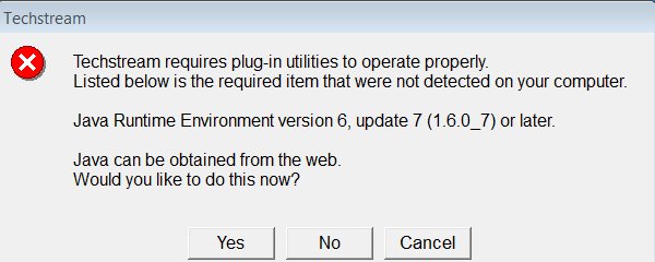

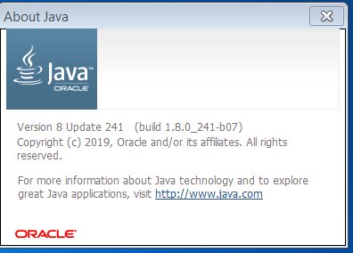

    Do you ever get this error with TIS ?
    I actually have Java 8 installed.

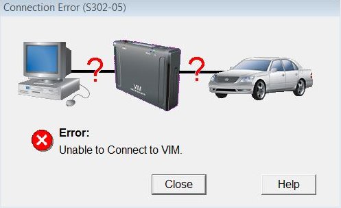

    I got a little further when I tried to connect.. Error code 29 stating TIS requires a network connection.

    Everything but the driveshaft. B03A - 410

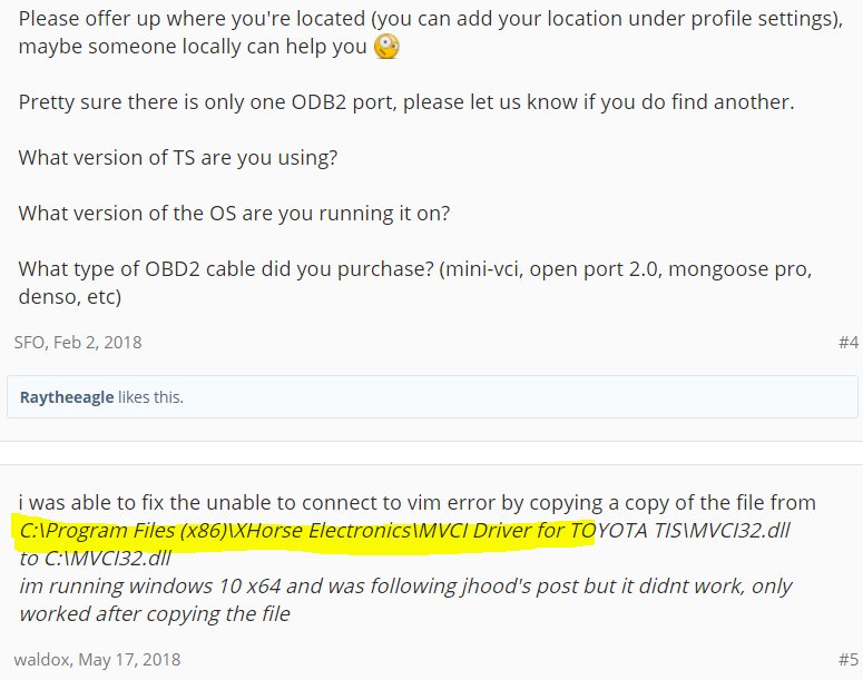

    A little further. I think the problem is with the lack of correct drivers for the cable. I see references to XHORSE directories and software in installation guides. I don't have it on the installation disk. I can't seem to find a place to download in install just the drivers. The Amazon seller where I bought the cable is gone. I remember fussing around with some XHORSE directories on the first installation. But I can't figure out what I did to get it to work on the first time. I don't remember it being too bad. Not like this.
    I'm about to go buy the Tactrix cable just to get drivers that work and "support" from a real company.
    The part that bugs me about this installation is that I do not have any XHORSE electronics software under c:\program files (x86) like referenced below.
    This seems to be my hang up.
