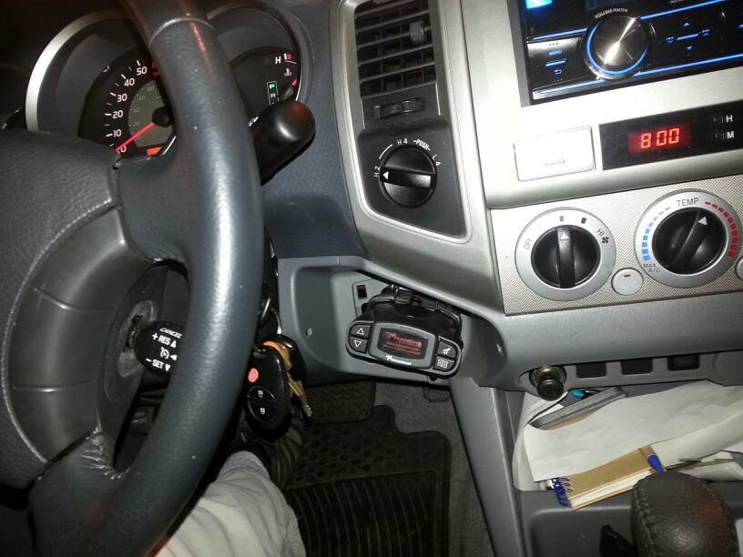

    You can see where I mounted my Tekonosha. Not sure what model, but it's a solid state one not mechanical. A little fiddly to mount there but not to bad & easy to pop in and out once mounted. Great spot to monitor and manipulate while driving.

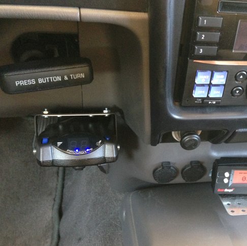

    I mounted in a similar position underneath my e-brake.
