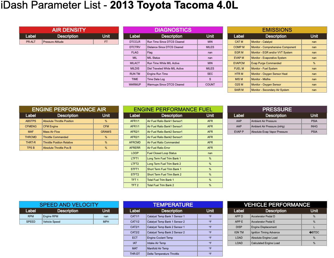

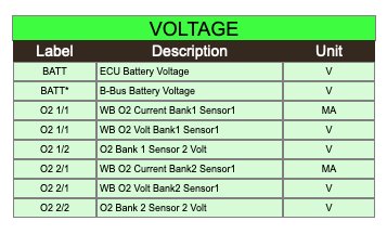

    This post is for discussing how we can monitor forced induction setups and what solutions we can come up with and maybe even some theory around what to monitor. I have some background in turbo cars and even adding turbo's to naturally aspirated engines but this is my first Supercharger so if any of the Supercharger guys can answer a few questions I have:
    1.) I've always felt that "Boost/Vac" and "EGT's" are a MUST when adding forced induction, especially when modding the system, what are the Supercharger guru's on here thoughts?
    2.) Are there parameters natively through OBDII like a MAP sensor that can monitor boost pressure without adding a mechanical gauge?
    *Banks Performance iDash can pull these from a 2013 Toyota Taco:
