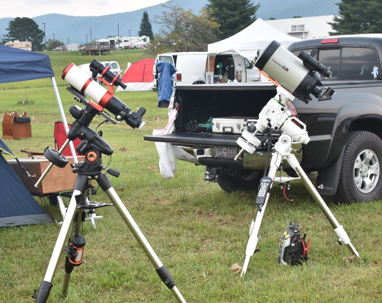

    1st pic is my refractor, a f/5.9 William Optics 3 inch apochromatic, next to my Edge 8", which is a Schmidt-Cassegrain design, both on computerized go-to equatorial mounts. This was at a star party at the Green Bank, WV Radio Observatory, home of the world's largest steerable radio telescope. The dish measures 2.3 acres in area.

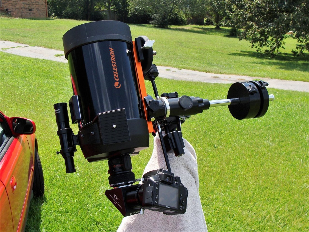

    2nd picture is my 6" Schmidt-Cassegrain on a manual EQ mount. I was shooting the Solar Eclipse of 2017 from Clemson, SC, where it was over 2-1/2 minutes of totality.

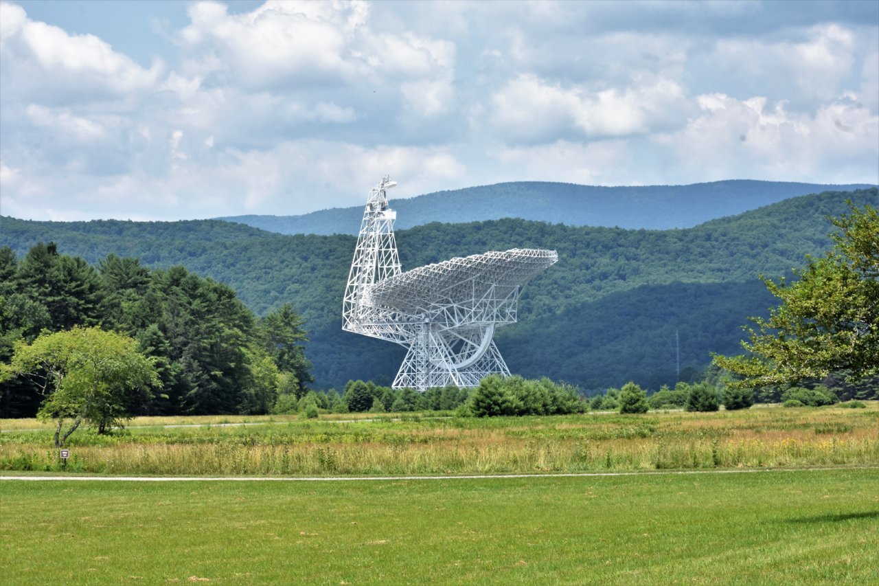

    4th picture is the main dish Radio telescope at Green Bank. The picture was made from a mile away, the telescope is over 375 feet tall.

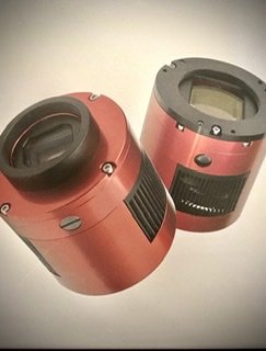

    I pulled the trigger on a 14” Meade. I also picked up a camera, ASi294. Looking for a wedge also but none seem to be available.

    On a more positive note, the camera showed up today!
