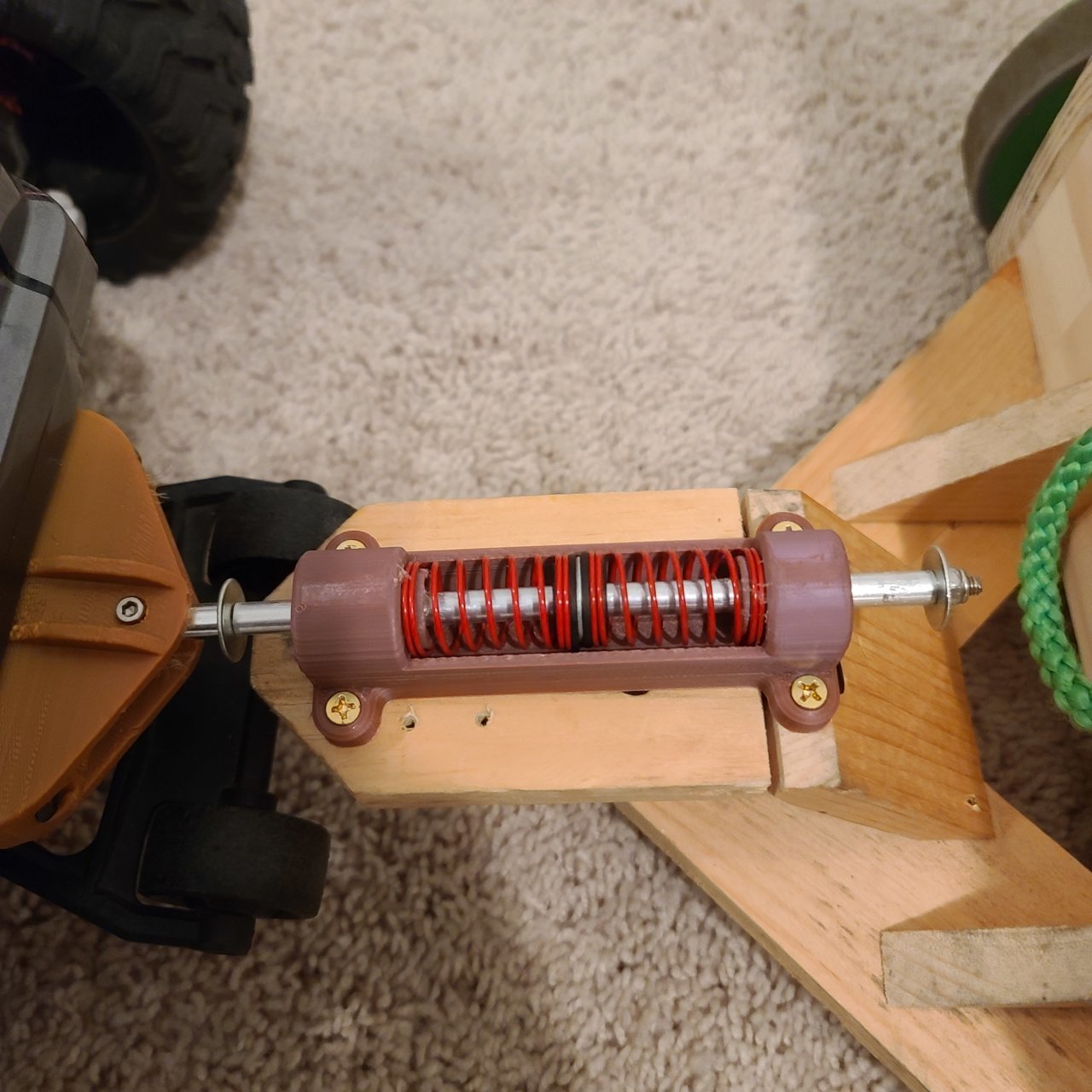

    I'm playing with a hobby project that has a telescopic tongue with a spring and damper on the length of the tongue.
    I'm looking for some real world examples.

    The closest thing I can think of along these lines would be a surge brake or overrun brake.
    Are you doing this to reduce the forces on the trailer when the tow vehicle accelerates or decelerates?

    Holy pitchforks y'all! :p Some of the surge brake systems (or overrun brakes overseas) have dampers inside to help regulate how quickly the brakes actuate. Yes, you still get all of Newton's affects, but if you can change the rate that the trailer accelerates (positive or negative) in relation to the rate that the vehicle accelerates by using a dampener (need to have a dampener) then you will reduce the forces involved.
    With the OP's above picture, you could easily make it a dampened system by building the unit as a sleeve that covers the springs. Place a seal or two around the metal disc between the two red springs and you've made a piston. Place a small air port on the forward and aft end of the spring sleeve and you've got a pneumatic shock absorber that will use air pressure to slow the movement. It almost looks like @soggyBottom is heading this way and that he 3d printed with a cutaway to see inside.

    Based off of his image, he's trying to develop an RC car trailer that will safely deliver a pint of his favorite frosty beverage without spilling any due to the RC car's jerky accelerations :D
