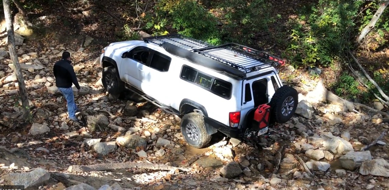

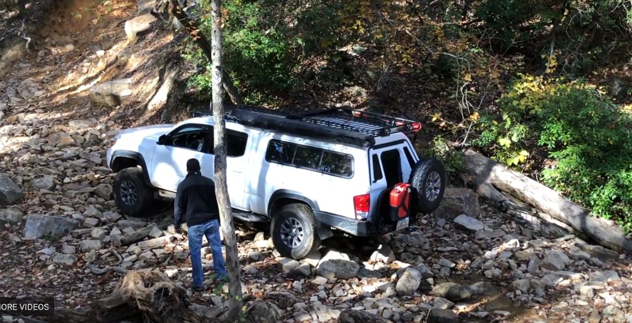

    Yes, they replace rear factory stops. I have a lot of weight on the back of mine and tow often. They are the most cost effective solution to help suspension droop without anything else. I talk some on airbags vs sumos vs helper springs vs aal here: https://www.tacomaworld.com/threads/ga-tacoma-owners-bs-thread.17642/page-1168#post-23149668
    Installing them - this is what full droop will look like with Dakar leafs, stock leafs it'll sit closer up. When the truck is on the ground and not flexed, my sumosprings sit snugly on the top cradle:
    The installation is trivial if you're just adding Sumos, I could do it in my driveway in under an hour. I've done it before though, so if you're less mechanically inclined, maybe a few hours max. They're very easy to install.
    This is misleading. You lose a bit of flex, but not enough to matter. You'll never notice unless you're rock crawling, and you don't rock crawl with a load enough to need Sumosprings.
    2 stills from a video below, they show enough flex. It would flex more if I did one of those instragram-pose shots on a loading dock behind Starbucks. The key point here is Sumosprings won't hold you back offroading.
    That said - and in defense of your point - here's a steep off-camber descent where I have less flex than a stock truck. It's exacerbated because there's no weight on the rear end. This was steep enough that my check oil light came on, so far from normal driving conditions. Again, good for overland, not good for rock crawling, but if you're rock crawling you should travel light and not need Sumos.
    Mine have been great! No complaints whatsoever. I'd do airbags now since I have on-board air, but they're a really great low-tech solution to a saggy ride under load.
