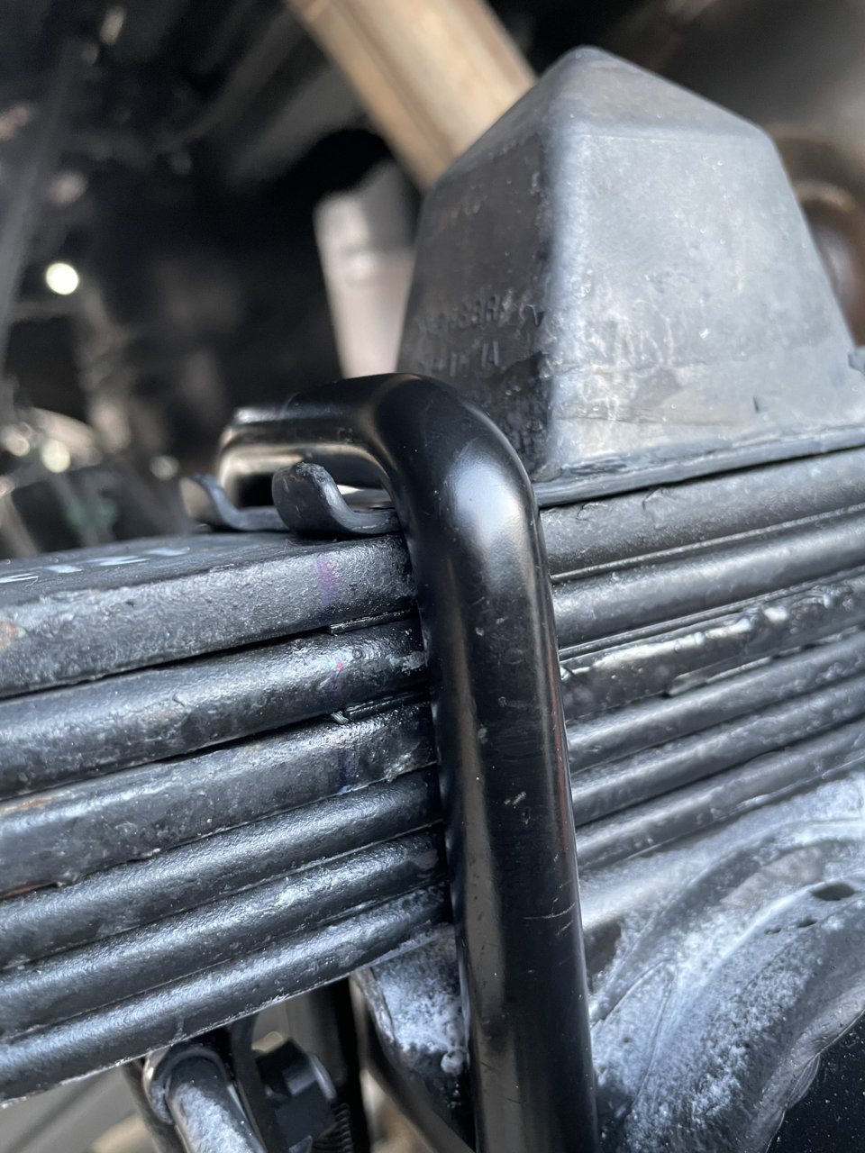

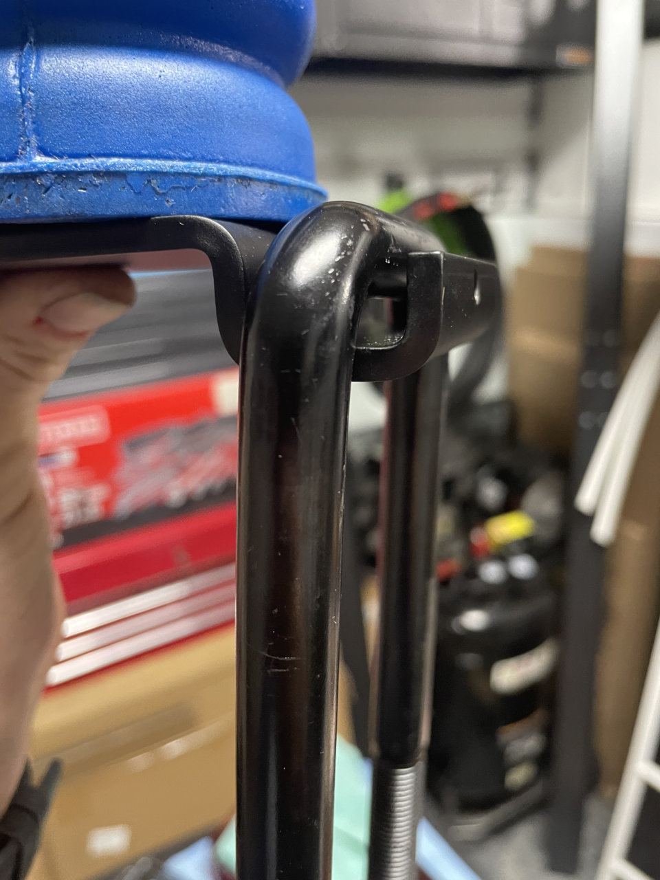

  10. Jan 29, 2021 at 8:53 PM
    #30
    baldbeardedtaco
    baldbeardedtaco Well-Known Member
    Sep 4, 2018
    #265223
    3,328
    FL
    18 TRD Sport DCSB MGM
    Do you remember if your ubolt sits completely flat on the sumo bracket? Or does the ubolt touch the edges of the sumo bracket not sitting flat in the center?
    Pic for reference

  12. Jan 29, 2021 at 10:50 PM
    #32
    baldbeardedtaco
    Sep 4, 2018
    #265223
    3,328
    FL
    Thanks for this. The ubolts sent with the aal are ome and I think it’s slightly narrower inner diameter than stock bolts but also the factor bump plate is notched where the ubolts rest (basically raising it up slightly and clearing the bend radius… is my guess). I read the description as it mentions other brand ubolts don’t have a proper radius to match stock but they don’t list complete measurements, only leg length so I’ll email them. This maybe my solution- I appreciate you!
    Gtboosted[QUOTED] likes this.

  17. Jan 30, 2021 at 11:11 PM
    #37
    baldbeardedtaco
    Sep 4, 2018
    #265223
    3,328
    FL
    During the dry fit it didn’t seem right. I installed the 3leaf aal today and compared the stock to the ome on the stock bump stop- factory ubolts sit completely flat but the ome did not (again this is with the factory bump). When I checked the factory ubolt on the sumo spring- it didn’t sit flat either. It wasn’t as bad obviously but still had a gap (maybe 1/8”).
    I’ll be emailing both companies with my findings and see what happens. I really want to get these sumos on
    I thought I took a pic of the factory ubolts on the sumos but must not of
