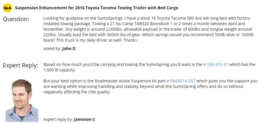

    Replied to the email from SumoSprings and asked about the reasoning -40 vs -47. Here's my question and the reply. Sounds like what @Hammerma experienced.
    Me: With the SSR-612-40 being the 500lb rated model, is that 500lbs each side? If I plan to add 500lbs of gear in the truck, as well as the 212+lbs of tongue weight, then I can see that model being sufficient. If it's a total of 500lbs for the pair, it would seem to me that the SSR-612-47 model would be the better choice.
    SS response: Adding that weight the blue can still be good and the SSR-612-47 is a good choice as well. IF you like to go black it can help but when the truck is unloaded the SSR-612-47 can cause the ride too become harsh and or stiffer then how it felt prior to the product being on the vehicle it is up to driver comfort SSR-612-40 can support the weight you asking and not impact how the truck drives unloaded while SSR-612-47 can still offer the support but may not enjoy how the truck feels empty.

    The sumo-springs are an inexpensive investment and dead simple. If, in the off-chance, you decide they do not resolve your hauling issues you can most likely sell them and recover a portion of their cost.
    You'll see many users here on Tacomaworld with sumo-springs and ride-rite airbags and you'll waay fewer users with the active suspension proposed. I easily hauled / towed more weight than what you describe (before modifying my truck) and all I experienced was a bit of squat in the rear of the truck... that being said I believe the sumo-springs will help you and will not negatively impact your comfort when the truck is unloaded. my $0.02 and worth what you paid.
    As for the 1000 lb sumo springs vs the 500 lb.. the company all but admitted that the 1000 lb springs will negatively affect your ride when the truck is empty. eTrailer isn't considering that scenario apparently.

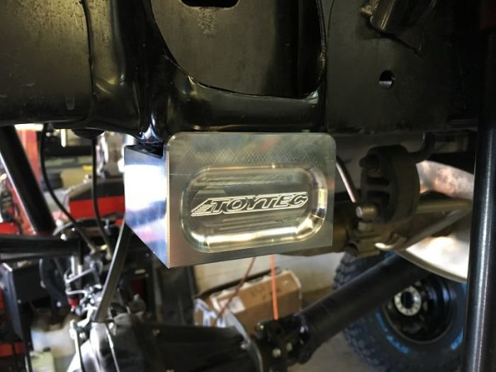

    Not my pic but I have this installed on my taco. I have about a 1.5-2” lift in the rear. I have the bilstein 5160s along with a deaver aal. This came with the 6112/5160 lift kit that I installed. I have the OEM bump stop of course and bought a sumospring to replace it.
    I have the 612-40s, so the blue ones. Would you guys recommend removing this piece? Or leave it with the sumospring installed.
    Im waiting on the front sumo springs to come in. Looking forward to installing that as well. E29E8F68-C766-47A3-B60B-BBC87BC953FA.jpg
