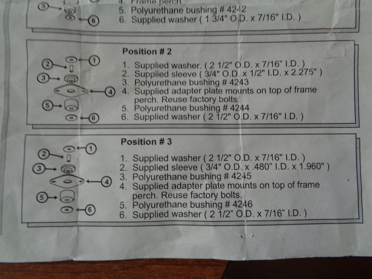

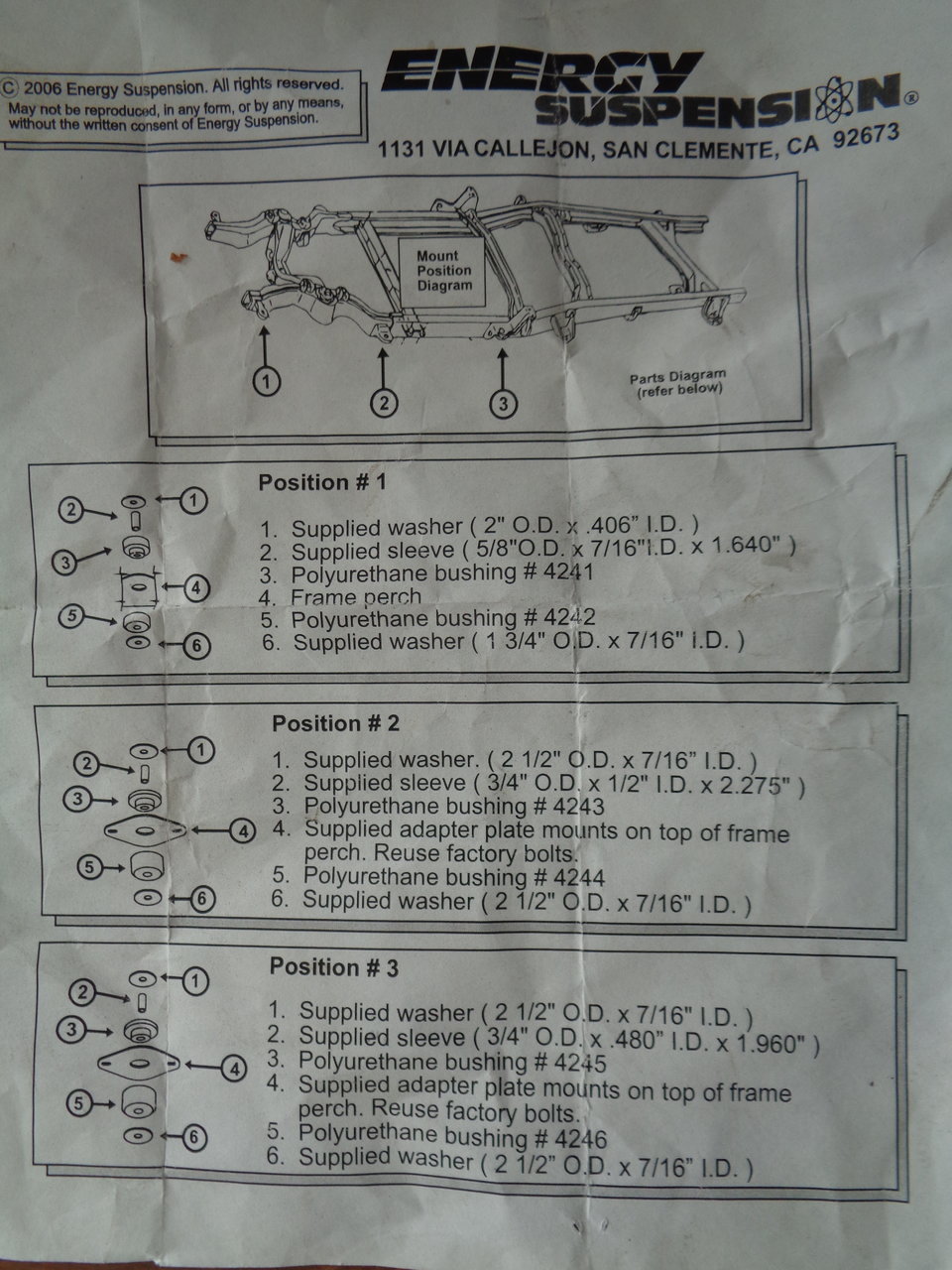

    Do you still have the original mounts? If you do can you line them up and take a picture?

    4244 are for 2nd position middle. 4246 is for 3rd position next to bed. The mounts are installed in the wrong position.

    Ok so they do provide a diagram and the size needed. Looks like the mechanic didn't bother with it.

    He put it all together and did not pay attention to the different parts or numbers. I would be pissed.

    I remember the bushings have the part number stamped on the side of it so you would know what bushing goes where in relation to the truck mounts. Also, the sleeves are all different sizes as well- so essentially you need to just go in height succession- again, relationally to where they are installed on the truck. Not getting these right, or having the right kit, could result in what you're seeing with body placement being off in relation to the bed.
    Not torquing these right (due to over-torquing)- I believe- would cause the body to be lower than the bed when resting on a level surface.
    I have had 0 problems with Energy Suspension products, and I'd absolutely put them in if I did it all over again. I ordered the "Master Kit" and used their whole kit on my truck and have been very pleased.
    It would be hard to say exactly what the issue is without going through, taking them all out and completely re-installing a "new" kit. Honestly, if you aren't happy with it, that's probably what I'd do.

    What @36tacundra posted is EXACTLY what I was referring to. You don't look at the diagram (i.e. don't use the right pieces/parts where they should be) then you'll have problems.
    Good looking out with that pic.
