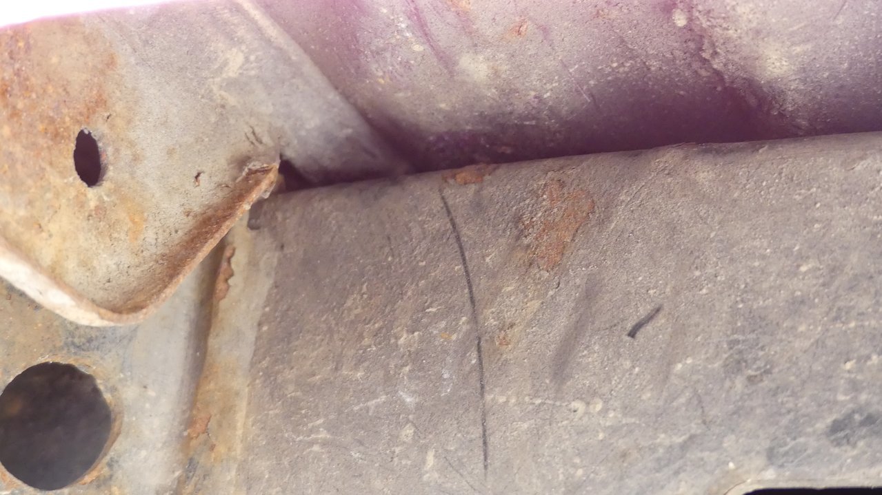

    So next question - The correct mount is in position 2 (like that? no more "middle") driver's side. There still is not much clearance from cab to frame. I have compared it to other same year tacos that have the standard mounts. Should this improve with the correct mount in position 3? Can I flip these? Or somewhere in my internet travels regarding this mount install turned install, uninstall, install, I came upon a custom make parts lift dude. I can get a couple of 1/2 spacer blocks. Not high enough to start messing with other stuff. I think that's at one inch....
    Input? I'd have to order the blocks. Think he's a week out on easier stuff like this.
    Or if flipping them is preferable, is there a thread anyone knows of off hand? If not, I am sure I can figure out my way around here....
    Just realized I can edit.... Yup....

    OME 2.5,Tundra 17s,Falken Wildpeak AT3W hitch w/ 7-pin, ARE cap, JVC HU w/BT, HID/LED lights
    @Kristi with a K according to the instructions @36tacundra posted it would seem that all the bushings are of different height. hence the different numbers associated with them.
    the mechanic probably put the wrong ones with other wrong ones and that is causing the height difference. as some of them are also "squished" it seems to confirm this conclusion.
    If you feel so inclined take it back and either have them/him/her/it fix the problem or ask for the money back. They clearly did not follow the included diagrams that an 8-year old could read.
    take the picture from here and have them remove the mounts and verify each # part is in the correct position if you go to them for the fix.
