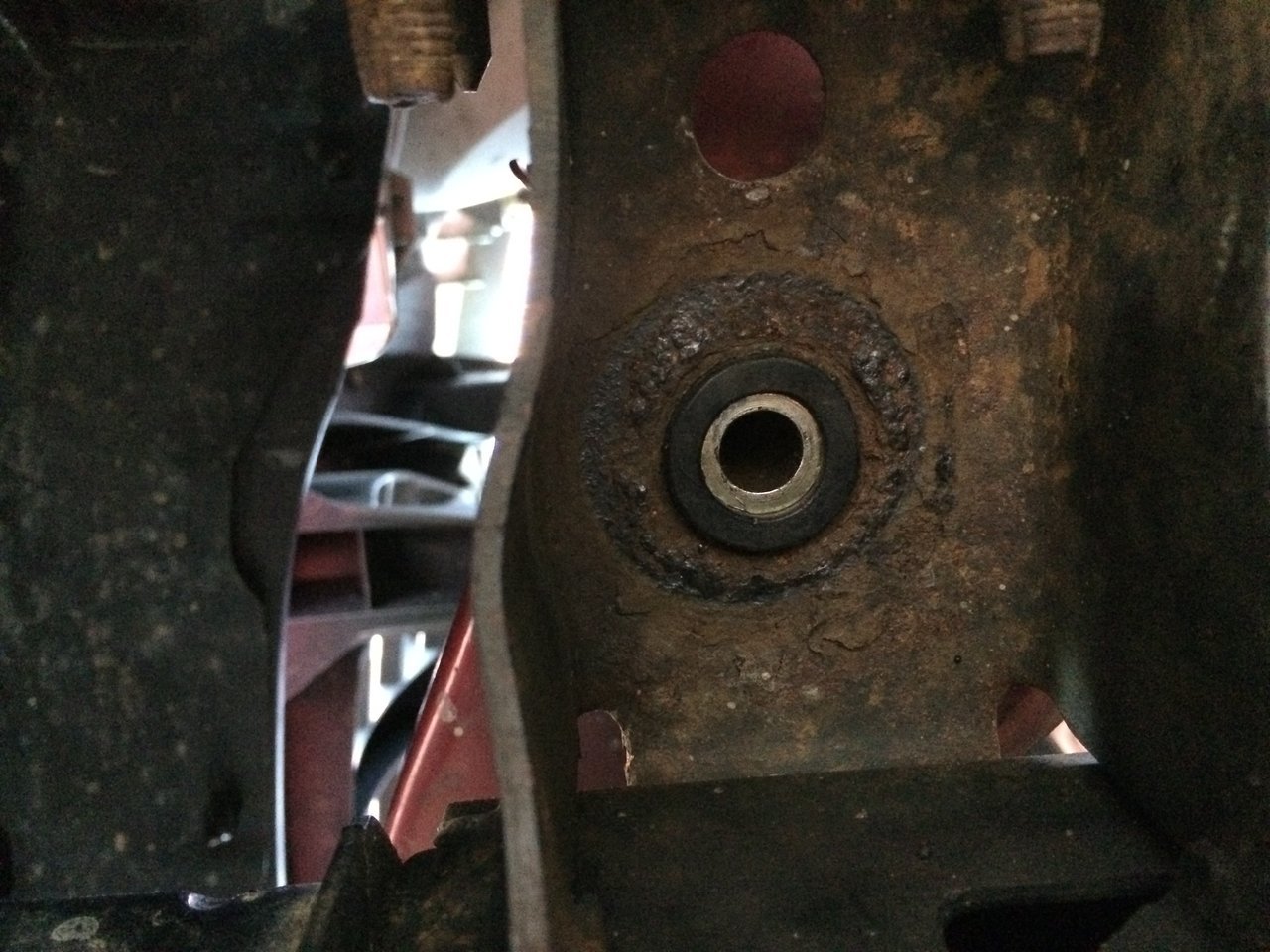

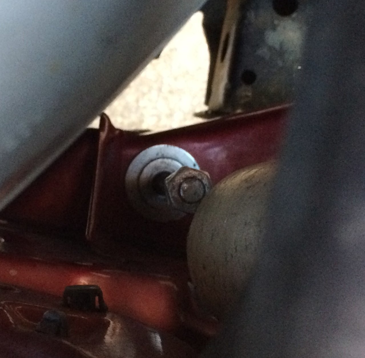

    Help! The numnutz mechanic didn't use the washers on top so the sleeves jambed up into the bolt holes on the radiator mounts. I was able to do the passenger side by pulling it out with plyers. The driver's is jambed up farther so it is flush both top & bottom. Plus I can't get the bolt out all the way cuz this is the side with the radiator pump. If I could get the bolt out I could probably use something to hammer it down far enough to grab it with the plyers. Any suggestions?

    Thanks. Other issue first. Grr.... so close....

    Hate to ask this... Can you take a pic from a couple different angles?!?
    That would help me out a lot.

    Bolt as far up as I can get it. The sleeve is below the base of the bolt. So it does no good to push it down flush.
    From underneath. Flush as well.

    I think I see what I'm seeing here. Not sure why you wouldn't use the washers, but he didn't, so no use being mad about it.
    My suggestion here... You'll need a few tools- Breaker Bar, BFH and a socket. Find a socket that's smaller that's about the same size as that sleeve (smaller than the hole of the truck's frame but enough to get a little "bite" on the sleeve). Take the breaker bar and either attach it to the socket (which would be ideal) or set the breaker bar on the socket and then hit the end with a hammer.
    I'd go from the top down (sky to ground) on this because you'll get way more leverage this way with the hammer, and you should be able to get enough force from the hammer, to breaker bar, to socket to get it to come out.
    Let me know if you need a crayon drawing.

    Think I just might be able to do it. I found a long ginsu type knife that has two point ends on it. I wedged it in next to the top of the bolt & gave it a few whacks & a smidge, I mean a tiny smidge of a smudge of the sleeve came through underneath. If the knife was longer it'd be much easier, but it'll work. Also if I get rid of one of the points it'll probably work better. It's getting cold, heck it's been cold, plus the darknesses is almost here.
    So that's my big idea. Any bigger ones would be most welcome.

    I think I get what you're saying, but the bolt is wedged. Well not wedged in that I can't push it down, wedged in that I can't take it out all the way. It can't pass the water pump. That's why it's like that in the pic - Sky to ground :)
