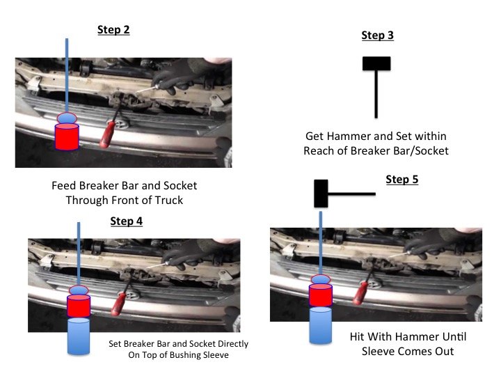

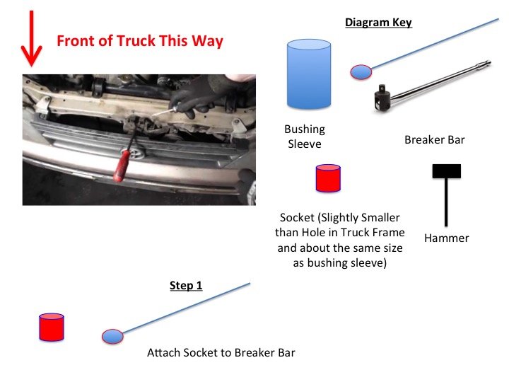

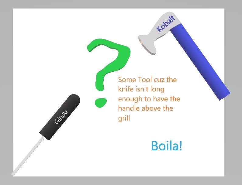

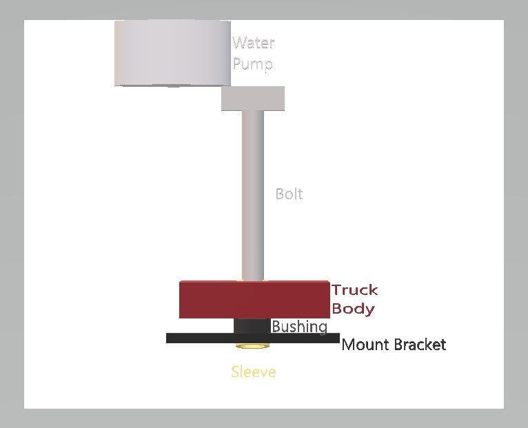

    Ok... PowerPoint Crayon Sketch. Take 1.
    Do you get what I was referring to now? That might make it a little easier for you. Just make sure you get a socket that's about 2 sizes smaller than the hole the bushing sleeve is stuck in (but large enough to grab the bushing) and set your socket with breaker bar on the bushing. Give it a couple good whacks with the hammer, and it'll be out!

    I'm with you now. I want to say I had enough "play" in that bolt that I was able to angle it in/out when I put mine in. Let me take a look when I get home and I'll be able to see what's going- with what mine looks like at least.
    I got it. We're on the same page now. :cheers:

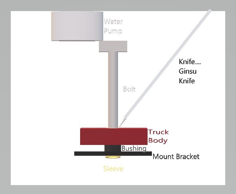

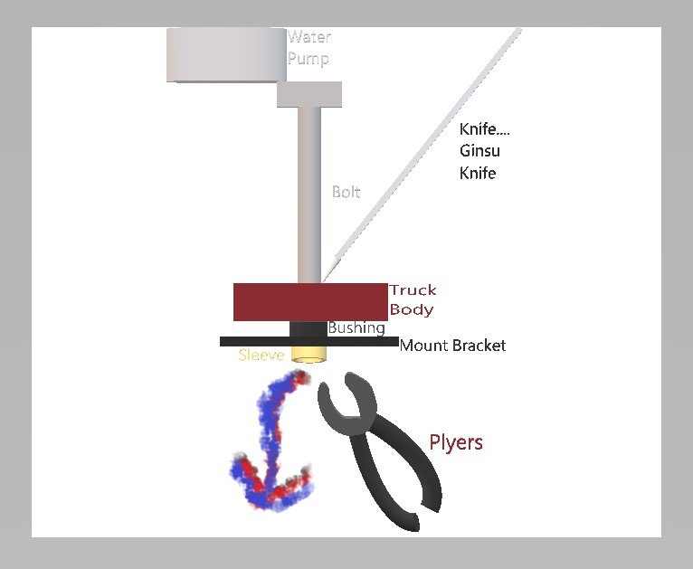

    It isn't necessary to take the bolt all the way out in order to remove the top bushing, you just have to clear it, so you may have not removed it. I have to cuz the freakin' sleeve is stuck up inside the bushing. The passenger side radiator bolt came all the way out cuz there was nothing obstructing it.

    This is my big idea -

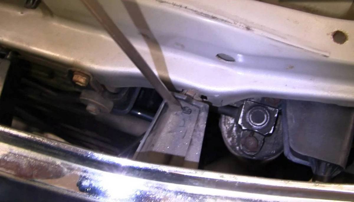

    Found this pic on line. It's hitting on the cylindrical part on the right. I guess I best get straightened out on what that is before I go making something else up....
    So I can easily remove or move this? It's "hardtubed" to the radiator. If it was "flextubed", I might'a tried it earlier.

    that's the Freon reservoir for the A/C. you can unbolt it (one of the links I posted says to do this to the hoses as well) and you can move it slightly out of the way to get the bolt out
    also it is hard-tubed to the condenser but that is clipped to the radiator as well.
    you don't need to move it far to get the bolt out, just a little bit :)
