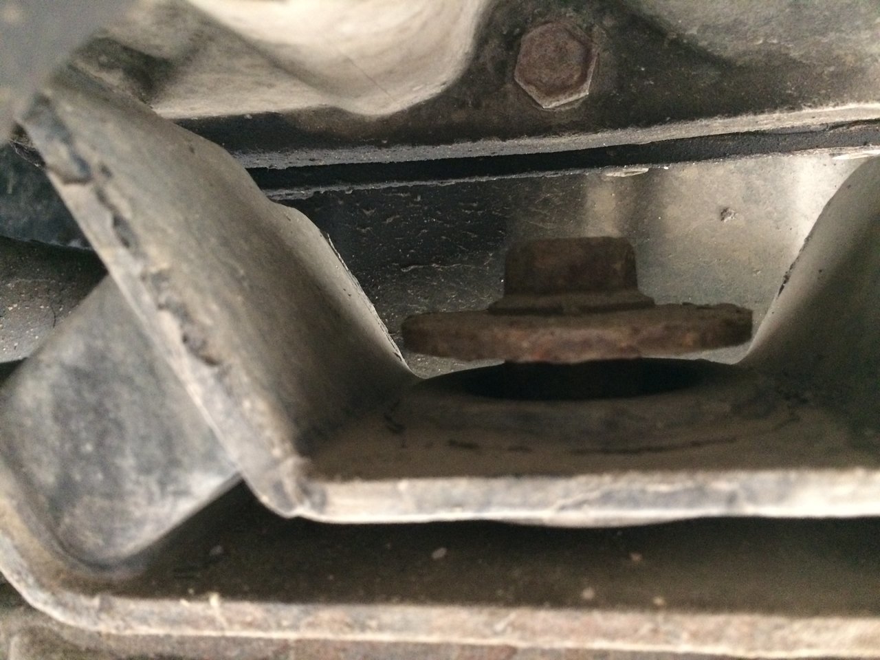

    Hey, thanks for buggin' me. I had indeed taken some pics, but wnated to get better ones, then we got snow :( & then I got offered some work, ya-da, ya-da, ya-da....
    So we started with the tranny mount, or the easiest one to see. My guess is since this one looks like this....
    Also, I put the Handy Level app on my phone & did a quick check on the drive shaft angles. Did I write them down? Nope. Was I in denial that it would ever snow & I would get back under & do them properly by now? Yup. However, & you will correct me if I am off here, a new tranny mount or new tranny mounts, would change this anyway?
    I am hopefully getting access to a lift in a heated space this week, so maybe first I will see were I can get with the bolt. This is always my main concern as I am not set up to deal with the potential issues that can accompany the big ol' rusty bolts/nuts. This is why the mount job ended up with a mechanic.
    Oh, & I got myself all the stuff to grease, so am going to take care of that & keep up on it....
    Haha! So the answer to your question, you ask? I have not figured it out, however we may be on to something/somethings/lots of things. My guess is it is going to be one thing after another until she is back to where she should be had I done my part....

    @Torspd & @Pigpen
    We finally broke out of the single digit & below temps, so I was able to do the tranny mount. No more highway vibration! & ya know? I will have to verify tomorrow, but dare I state that the takeoff shudder is gone?!?! That can't be right. I have had that since way back.... Anyway, thank you both for helping me ID the source.... still much to do come springtime....
