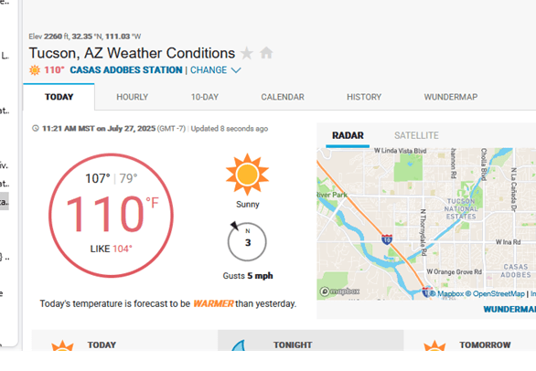

    My thinking ..........
    I usually add a quart to the trans to assure myself than I have more oil than needed.
    I pin the T-stat open when checking. I use both the above Check Temp mode video procedure and I check the temp with an ODB II doggle and Torque Pro app. The temps seem to be between 95F* and 115F* for the checking range.
    For me, that takes about 10 minutes to go from 95F to 115F because its in the car's own 'Temp Check Mode'.
    I usually have the car pretty level and the draining time is about 2 minutes.
    The dash indicator alerts and the TPro app are very close in temp agreements. That assures me that the app is reading faithfully with the car electronics.
    I have an external/additional trans oil cooler added to the system, making it similar to the pre-2021 Tacomas. To include that oil when checking at the low temp range (95F-115F), I pin the T-stat, because the T-stat opens at about 195F for the trans oil.
    Any comments?

    It isn't even noon yet .
