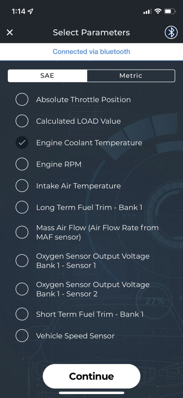

    I took a short drive, max speed ~40mph. According to the scanner, the coolant rose to 190.4F at the end of this drive. I watched the needle closely on start up; it maxed out a few minutes after starting; not immediately. I didn't watch it as closely last night because I was looking at the scanner app, so I probably missed it.
    Which, if any, of the following should I scan?
  17. Feb 9, 2022 at 1:32 PM

    180° to 200° is normal range for operating temps. Sounds like your truck is not overheating afterall.
    I like to monitor battery voltage, coolant temps and trans fluid temps (auto only).
