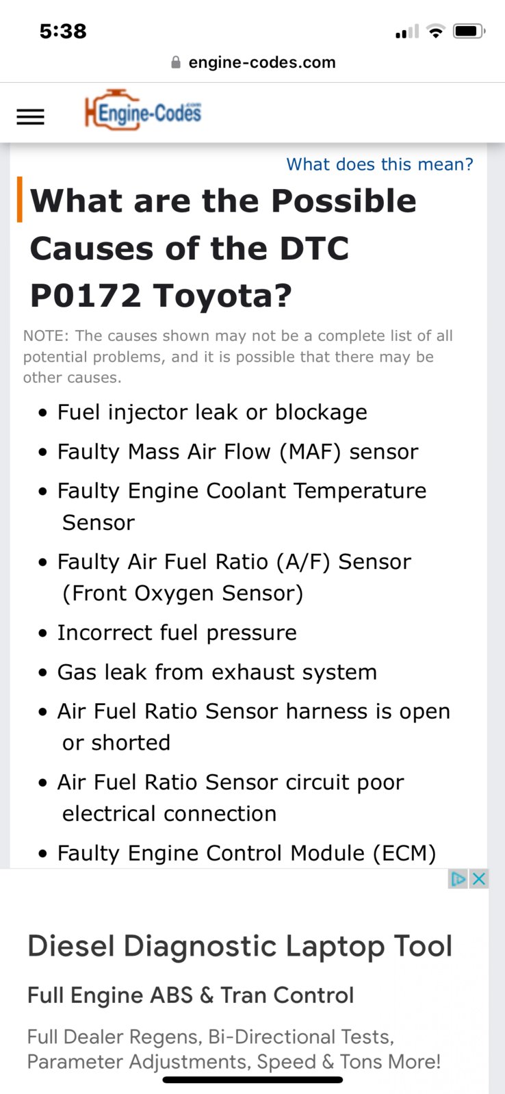

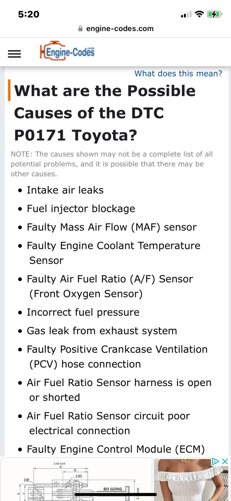

    My guess is that code was P0172 or bc of 2 banks on a 3.5L a P0171

    Those reasons are where I would begin
    maybe go down a rabbit hole when u get time and search ‘hot no start condition’
