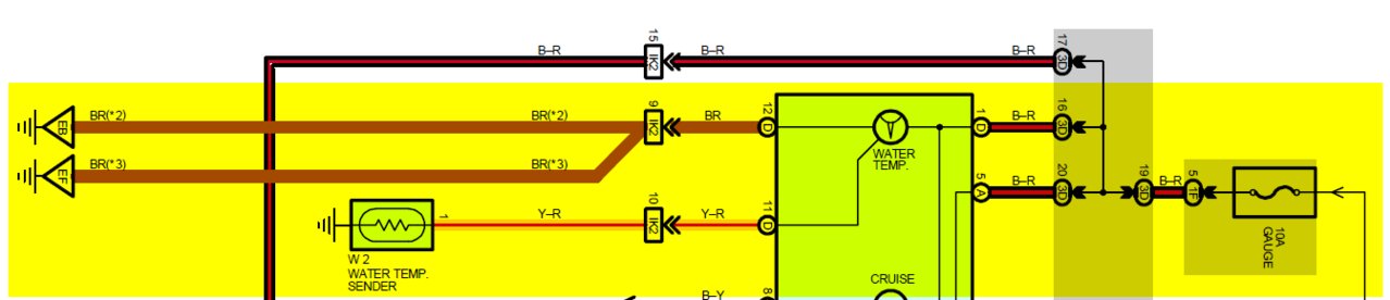

    This is the diagram of that gauge. Very simple - from power to the gauge via the sender (variable resistor) to the ground. Computer does not see anything of that:

    If you look at the post I linked above you will see that the water temperature gauge is simple analog instrument (at least in my 1995 Tacoma). Keep in mind, that the coolant temperature sender is a simple thermistor (a resistor that varies its resistance with the temperature). The gauge (electromagnetic needle) senses the current going through the sender and shows it on the needle. There is no single inteligencie in the gauge, as as dumb as analog multimeter.
    Keep in mind, that the sender is in different place from the coolant temperature sensor connected to the computer. They measure coolant temperature in different places, so even if one can fluctuate, the other might not - all depends how coolant is flowing through these parts of the engine. In 2.7 the sender for the gauge is at the radiator inlet so it measures the temperature of the coolant flowing into radiator, while the sensor conected to the computer is located on the back of the engine, so it senses the coolant temperature flowing inside the engine.

    All 1st gen Tacoma. It is identical for 1995, 1999, 2000, 2003. I see in 2007 (2nd gen) this meter is reading from the computer, so it looks like 2nd gen and up is more sophisticated.

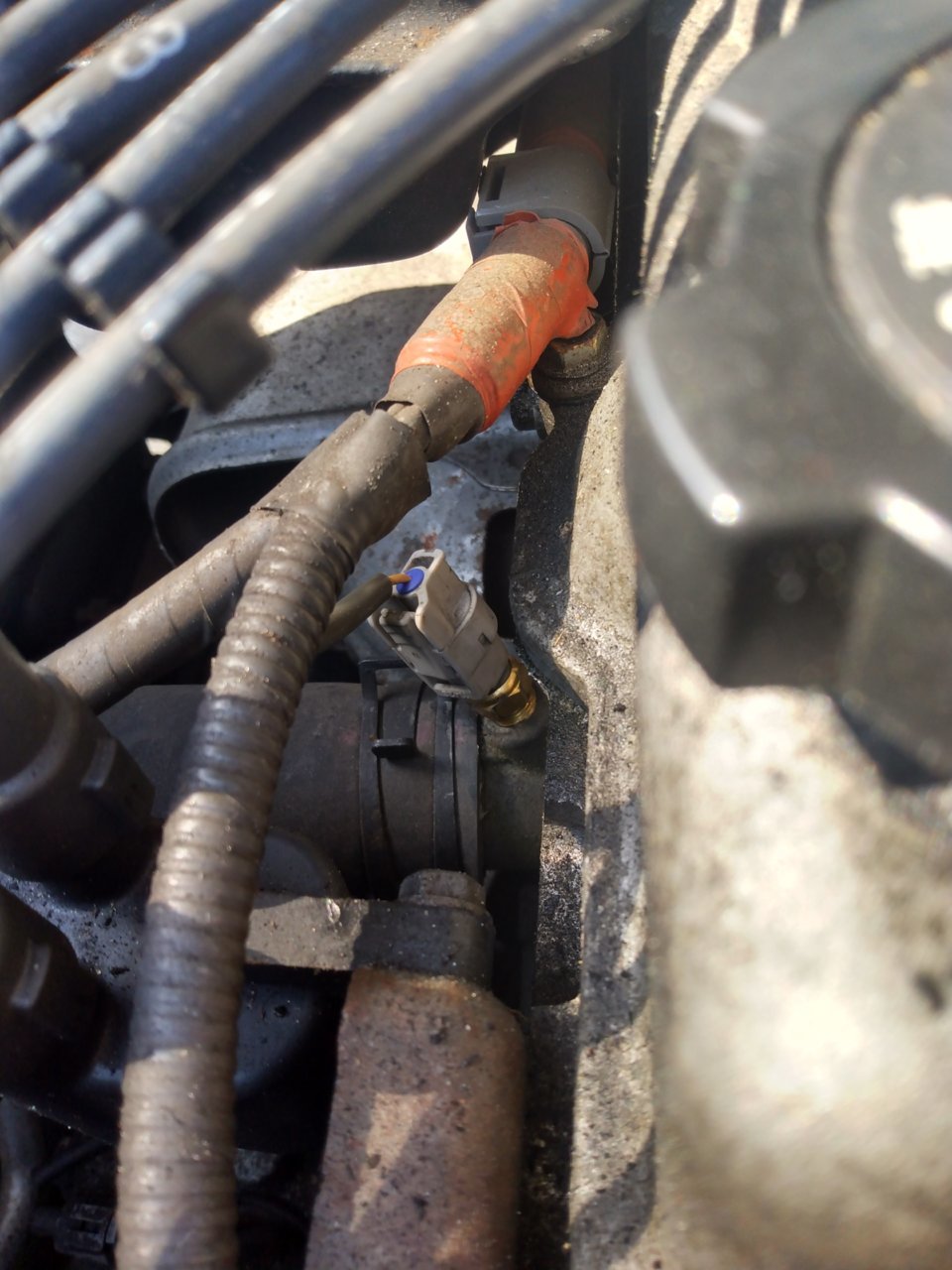

    Wow ! lots of great information there. So just maybe that sending unit that I can get to is the problem. Although going into the gauge cluster is an option I hate all the work involved. I had a radiator hose break on me and I found out fast when the temp gauge climbed to the top real fast. I like temp gauges. I don't have my multi meter working yet. I'll test the sensor when I get the battery. New sensor should be here around Tuesday. Thanks for all the great replies !!

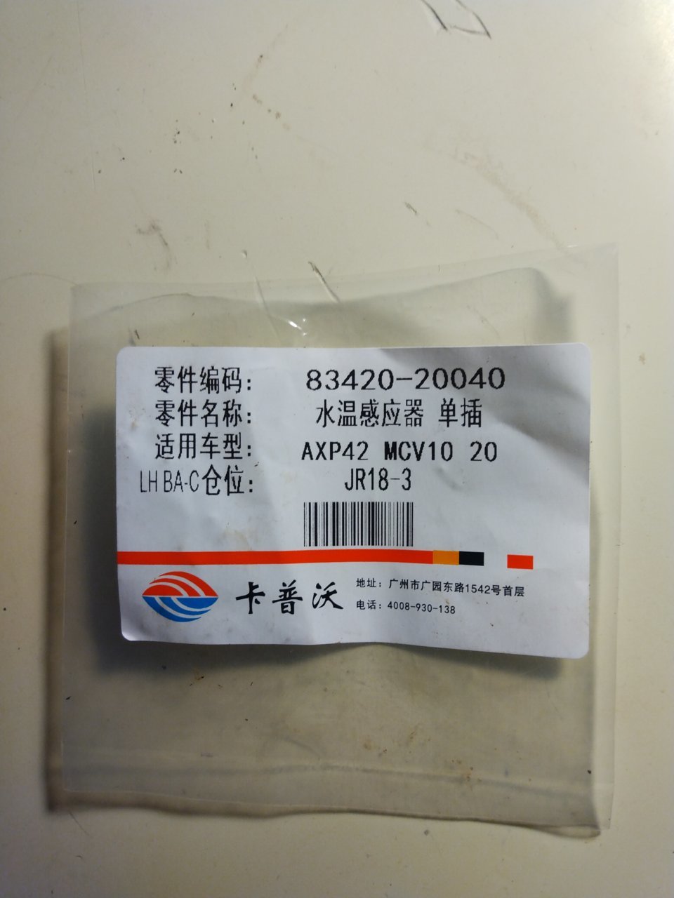

    Quick update. I just installed the new sensor and low and behold the Temp Gauge is working !!!! Boy was that nice to see. Here's a picture of the part number and it's location. It's on the Right side passenger side about 1/3 way from front of engine mounted into a water pipe. Thanks for all the help. $5.49 from China. Can't resist those prices.

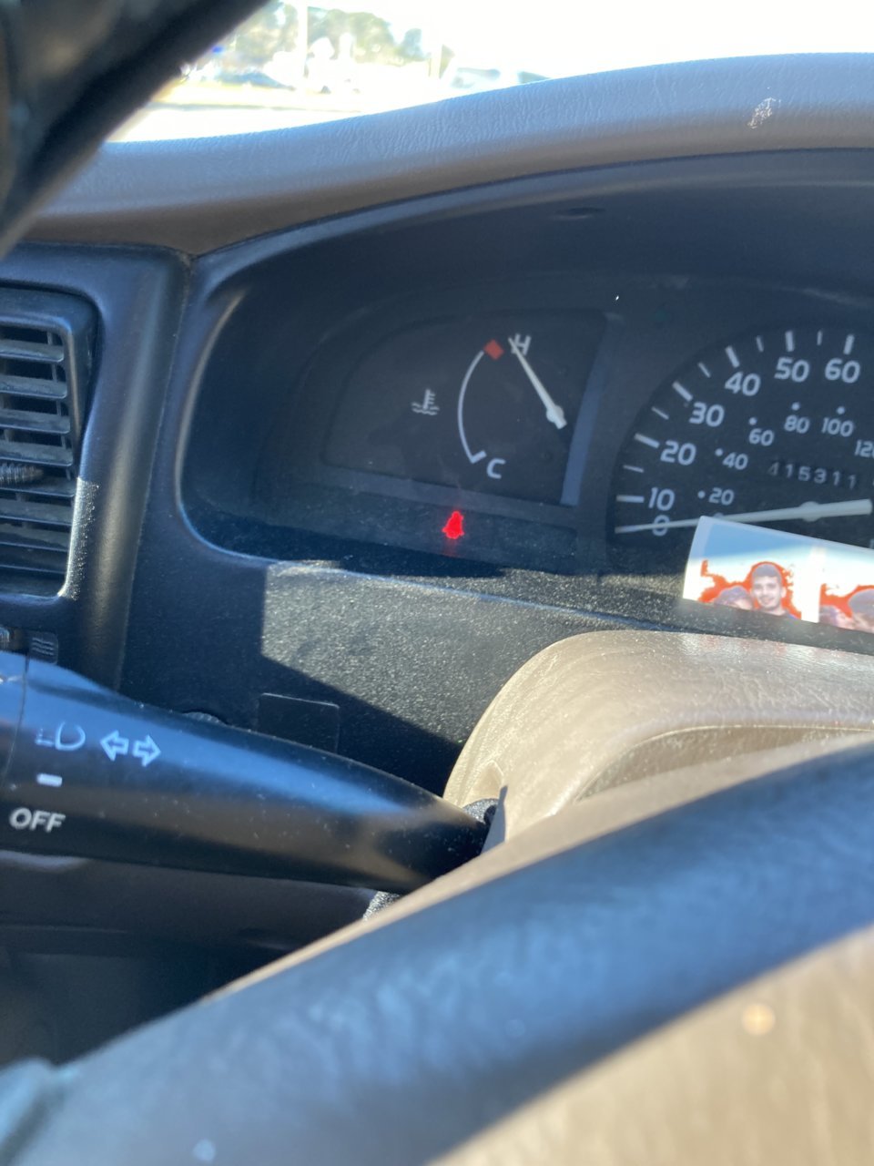

    Bump please help, it’s been pretty cold here lately and my temp gauge has been bouncing a lot when I would hit bumps on his week, I could tap on my dash cluster and it usually would go back to normal in the middle, well now it just goes straight to overheating. There are no leaks and I’m not loosing any coolant. I found the sensor next to the intake in middle passenger side but tried to feel around for the one on the back of the block but can’t find it. With it fixing it self this week when I was able to tap on dash makes me think it could just be loose wire in cluster or could the thermostat be stuck ? Or be a faulty sensor? I got the codes read yesterday when it started happening from autozone and the only code it was throwing was for o2 sensor which has been replaced about a year ago but the check engine light stays on and has never been able to reset its 2002 tacoma 2.4 2wd 5 lug if anyone has any experience with this please share! Just wondering if I should try to check behind the cluster or go ahead and replace thermostat and sensors but just don’t want to cause more problems because everything is so old and brittle and don’t want to replace it if it isn’t broken just trying to trouble shoot problem, Thank you!
