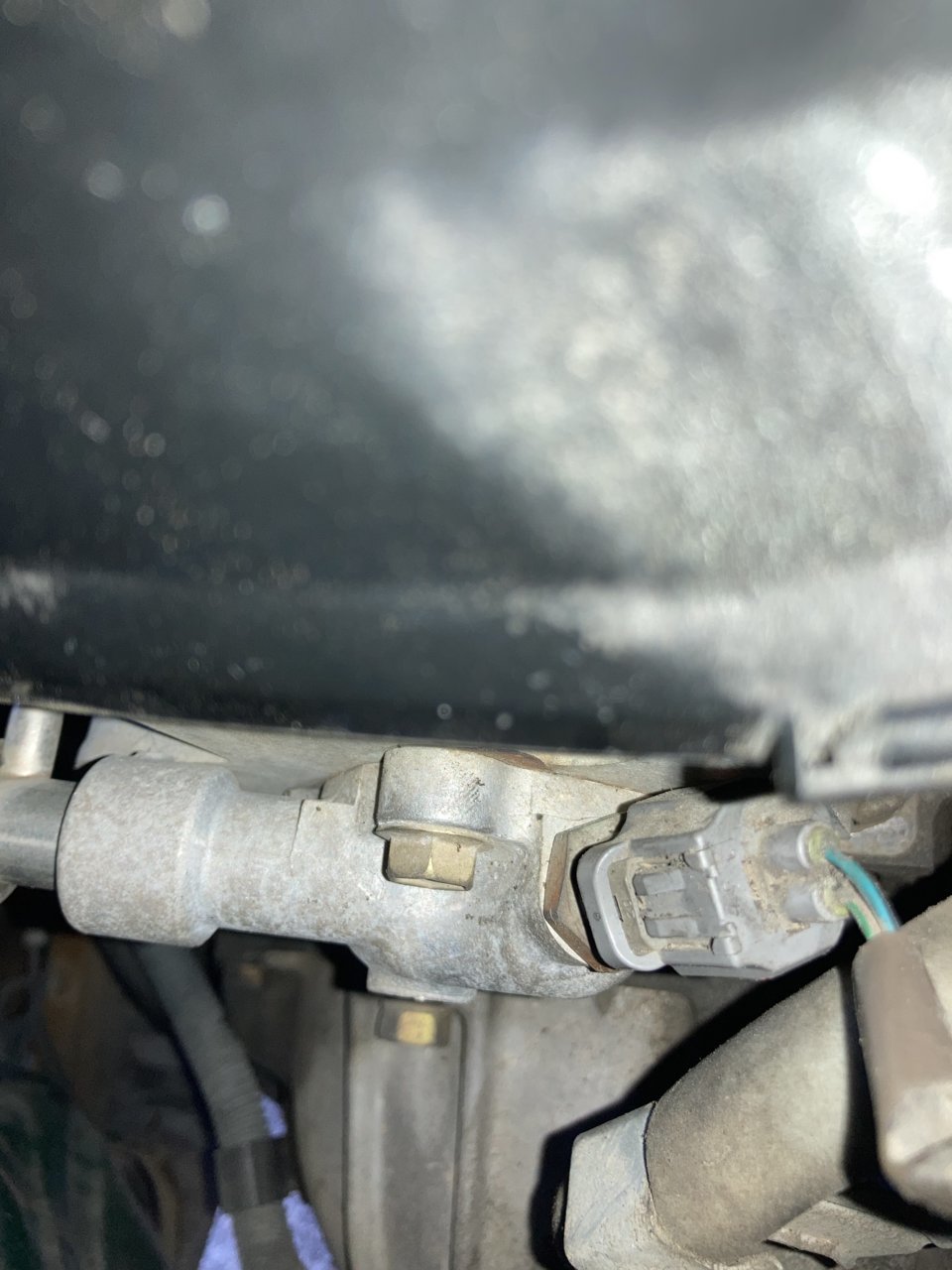

    Replaced thermostat and the front sending sensor today, tried to get the back one off and didn’t have right extension it was a pain just to get unhooked but found it was easier to unhook from the driver side then remove the two brackets holding some hoses to be able to squeeze behind and was able to get socket over it but the wrench wouldn’t fit down and had no room to rotate wrench. Going to try to get pivotal extension and finish tomorrow. Was hoping the thermostat and sender would fix my problem but looks like it’s going to be rear sensor or gauge issue.

    Just to be sure your read my post on the 1st page. If you have a dash indication problem only and the engine temperature reported by ODB2 reader is OK there is no need to mess with the rear sensor. The rear sensor is used ONLY by ECU to read engine temperature for proper mixture control. The dash temperature indicator is connected directly to the front sensor and nothing else. If the dash indication is still wrong after replacing the front sensor you have either wiring issue (connectors or wires itself) or the instrument cluster issue (electrical or mechanical).
    So the bottom line is if you do not have a problem with the temperature reported to ECU (easy to see in live data) and you don;t have any mechanical problem with the rear sensor (like broken connector, coolant leak etc.) just leave it alone. Don't fix what is not broken.

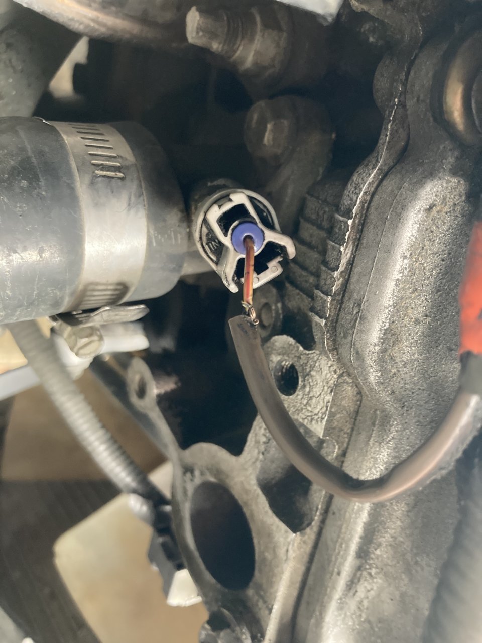

    I did not see that but I will try to get it over to auto store to see if they can read the Temp for me with their scanner , when I stoped by autozone the other day it was not showing any temp codes. Here is a picture of the sending sensor there are some wires showing so I’m going to try to splice wire and bandage up the best I can and see if this works before having to take it to a shop

    Shrink wrapped wire and tested connection and have a faulty sending unit sensor or bad gauge cluster. Going to have to buy a decent scanner that can give live data to see what temp it is actually running or go swap this new sensor and see if it is faulty. Don’t think it is faulty gauge if it is getting movement ? Anyone had this problem before?

    You won't get codes.
    That single wire plug is simply telling your needle where to point and is not a real indicator as to how hot your engine coolant temps are.
    These engines have both a sensor, and a sender.
    The one that communicates with the ECM will either be a 2 or 3 wire plug, and tells your ECM when it should be in open/closed loop and what your coolant temps are. This is also where you gather your temp information when you plug in a scan tool on your OBD port.
