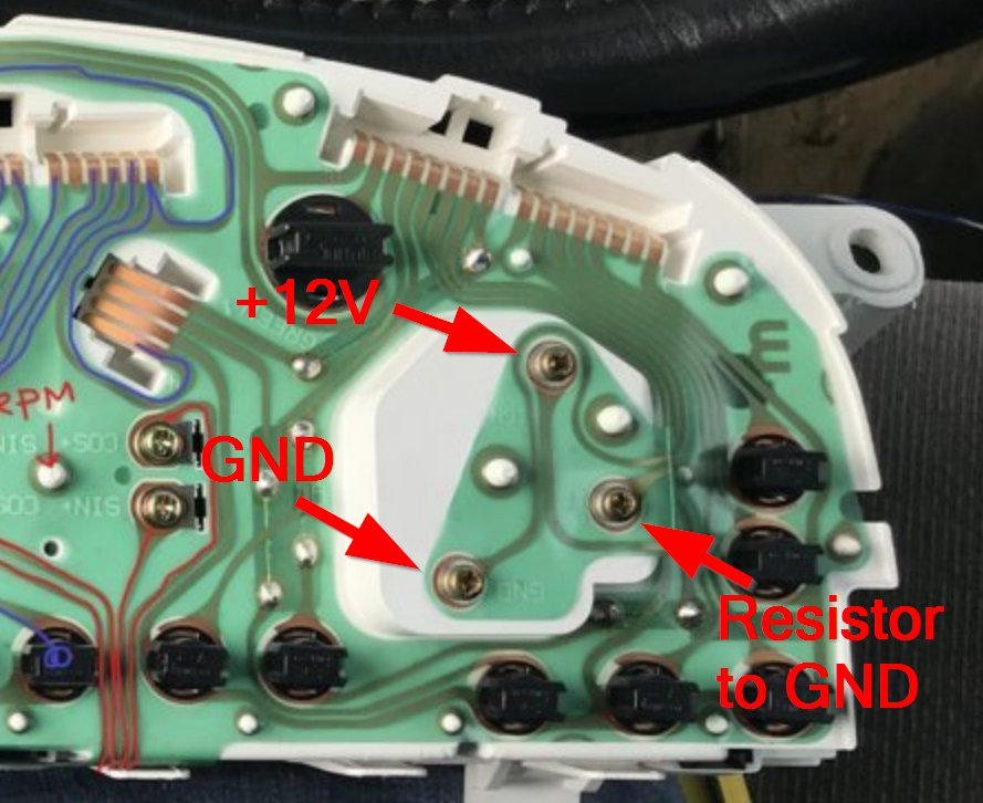

    If you have cluster out it is easy to check. Look at the diagram above and picture below for reference
    When 12V is applied to the gauge the needle will set depends on the resistance between the third pin and the ground. At 300 ohm it should show something between H and C.
