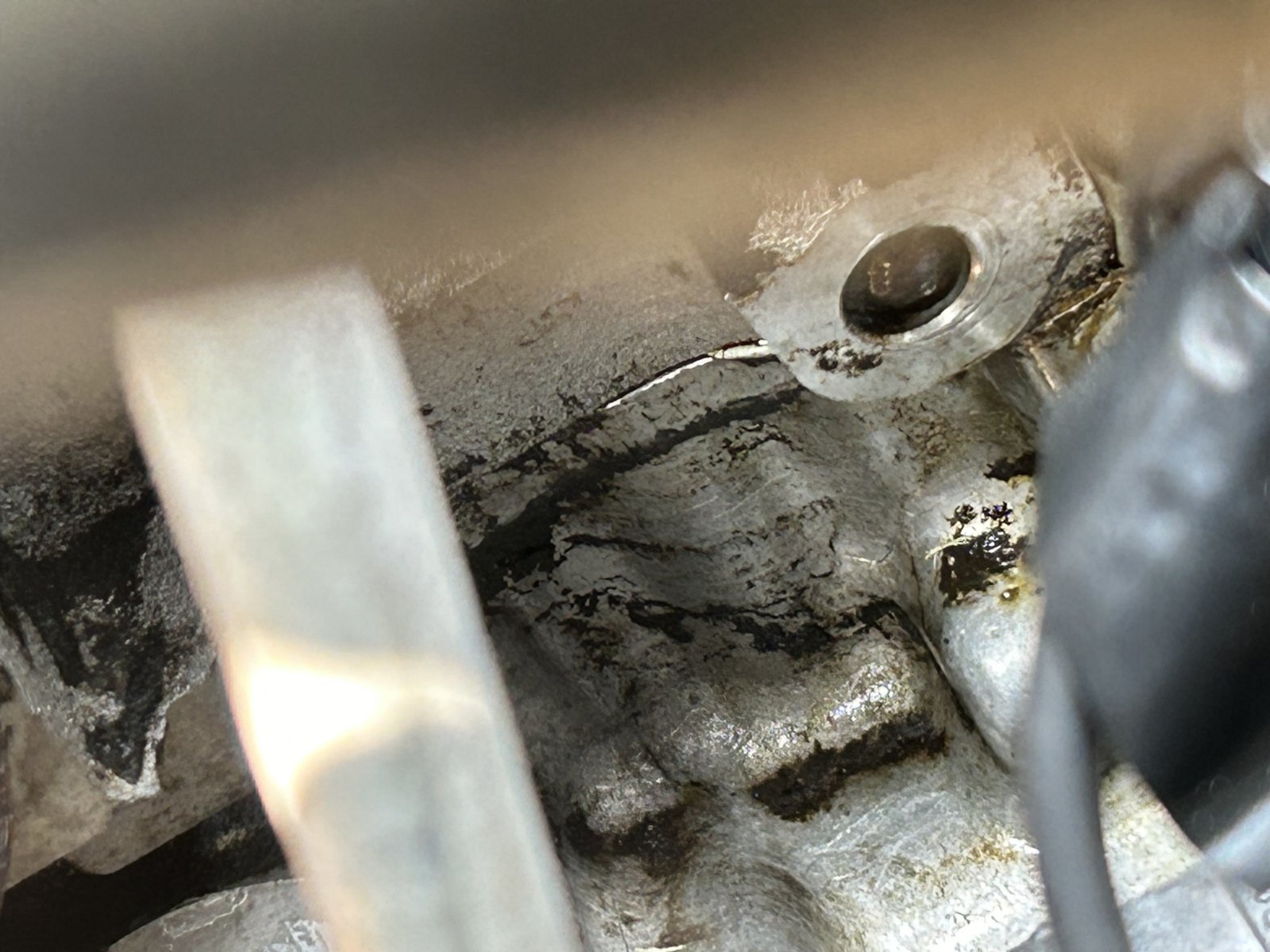

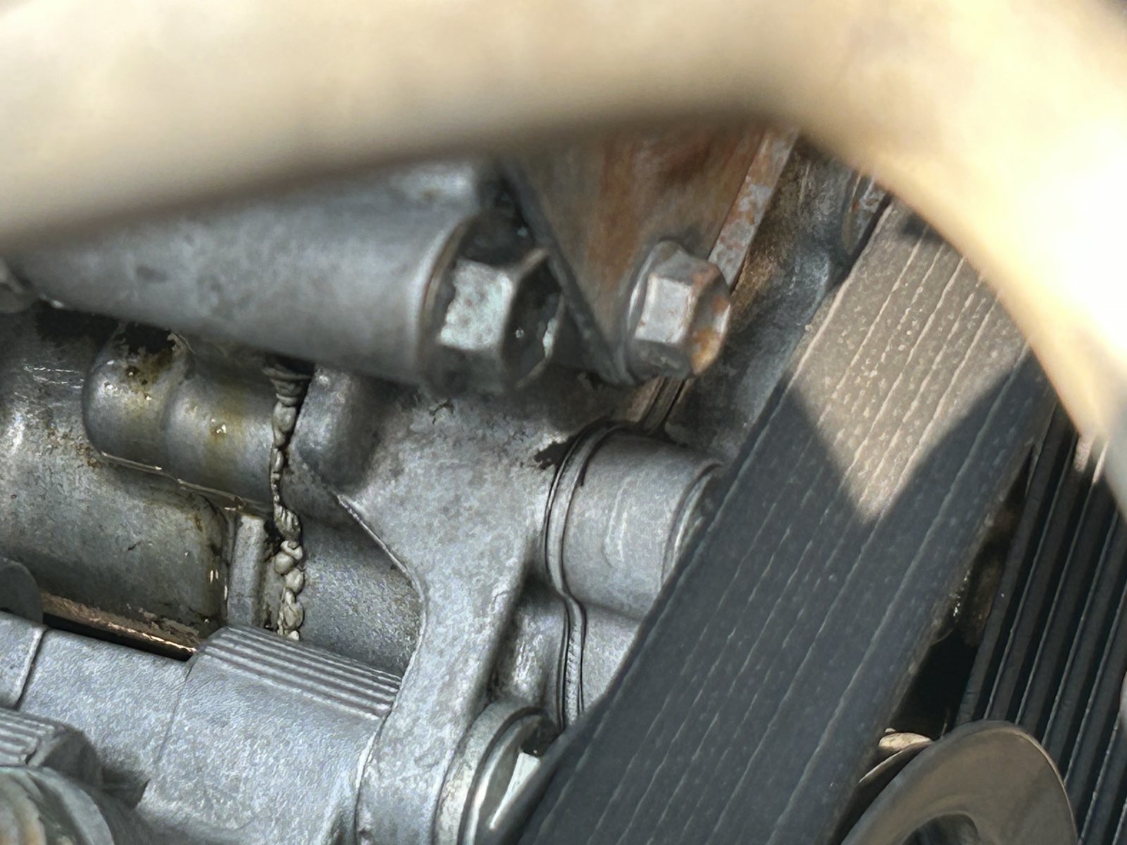

    IMG_2593.jpg IMG_2594.jpg I have radiator fluid. I just took these pics after doing my engine cleaning. This is right above the power steering pump.

    You’re certain it’s coolant leaking? It “looks” like oil. Id do a cooling system pressure test. You might be able to rent a pressure tester from an auto parts store.
    https://www.amazon.com/Stant-12270-...automotive&sprefix=Coolant+pre,aps,143&sr=1-2
    This is the one I had. I think for a backyard mechanic it would be fine. Mine kept taking a crap so I sprung for a snapon one.
    https://shop.snapon.com/product/Cooling-System-Testers/Cooling-System-Pressure-Tester-Kit/SVTS272A
