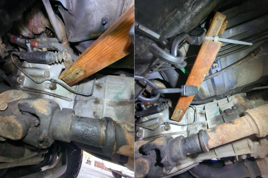

    Hey guys just thought I'd share my temporary fix for the cracked clutch pivot issue. In case anyone is googling and broken down, unable to get a tow, with a displeased wife in the passenger seat (Like I was).
    Related threads:
    Disclaimer - this is definitely sketchy for many reasons, I wouldn't trust the body mount especially. But if you're out wheeling away from civilization it could be the best option.
    Assuming that you're going to replace your bellhousing, clutch, clutch fork, slave cylinder etc.
    • You can wedge something under the clutch fork to hold the alignment enough for the clutch to engage.
    • Luckily I found a piece of a wooden furniture leg nearby. (Maybe a good thing to carry?)
    • The zip tie is the main thing holding it in place vertically which is wrapped around the brake line body mount
    • Bungee cords holding it in place in other directions, and I have one looped through the furniture leg in case it falls off, so I won't lose it.
