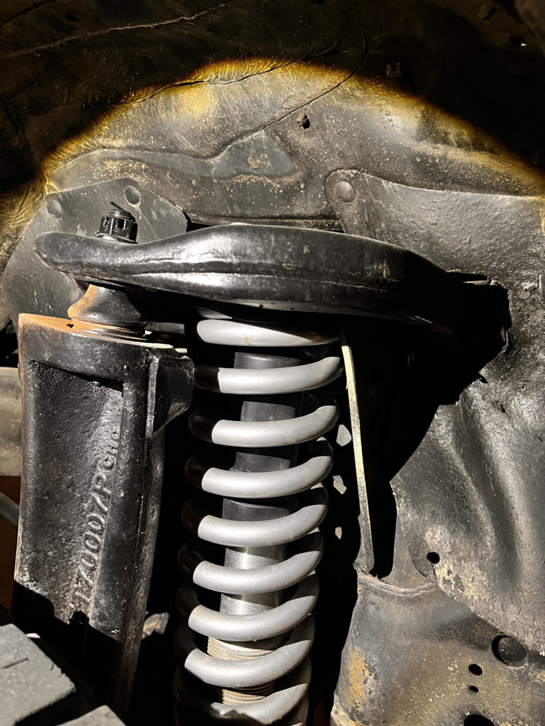

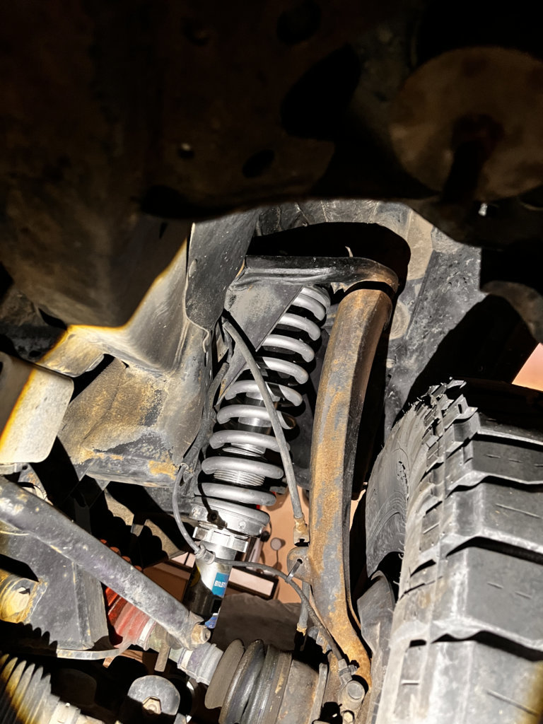

    @Dare Devil Diablo Here are pictures of my setup, it is just not making sensing to me how rough it rides.

    Those look really nice! Probably wrong spring/damping...

    You have almost no or ZERO uptravel left in your suspension with where the UCA is resting at ride height. Wrong spring, wrong shock, or both. Stacking lifts is no good either. Throwing a SAS at the problem may fix it by removing all that is wrong.. or you could fix what is wrong.

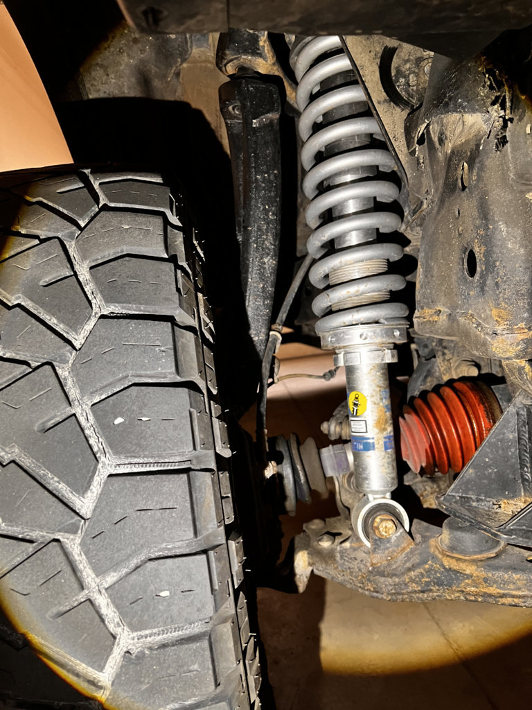

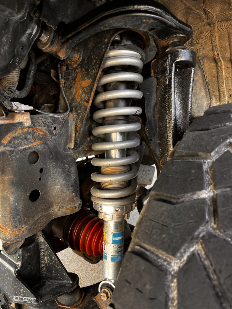

    Post more photos from different angles. Include both sides. I want to see what else I can find.

    Is that shock made for the 6" lift? If it is, in fact, long enough for the lift then he can remove the spacer and tighten up the coilovers to get proper ride height.
    If the shock is too short it may require the spacer for proper travel. I know Rough Country's 6" lift comes with a spacer so you can use standard shocks with their lift. Their suspension geometry is different than Fabtech's and is not compatible.

    @JasonLee Here are some additional pictures for you to take a look at.

    @Dare Devil Diablo The coilovers are made specifically for the tacoma with the 6" fabtech lift. They are from TopNotch.

    Looks like they came with the puck spacers.
    I think you have a spring rate problem and possibly a damping problem.
    You should adjust your coilovers so your lower control arms are slightly lower on the outboard side. Looks like you might be sitting opposite of that. You could be hitting your bump stops causing a rough ride if your ride height is set too low.
