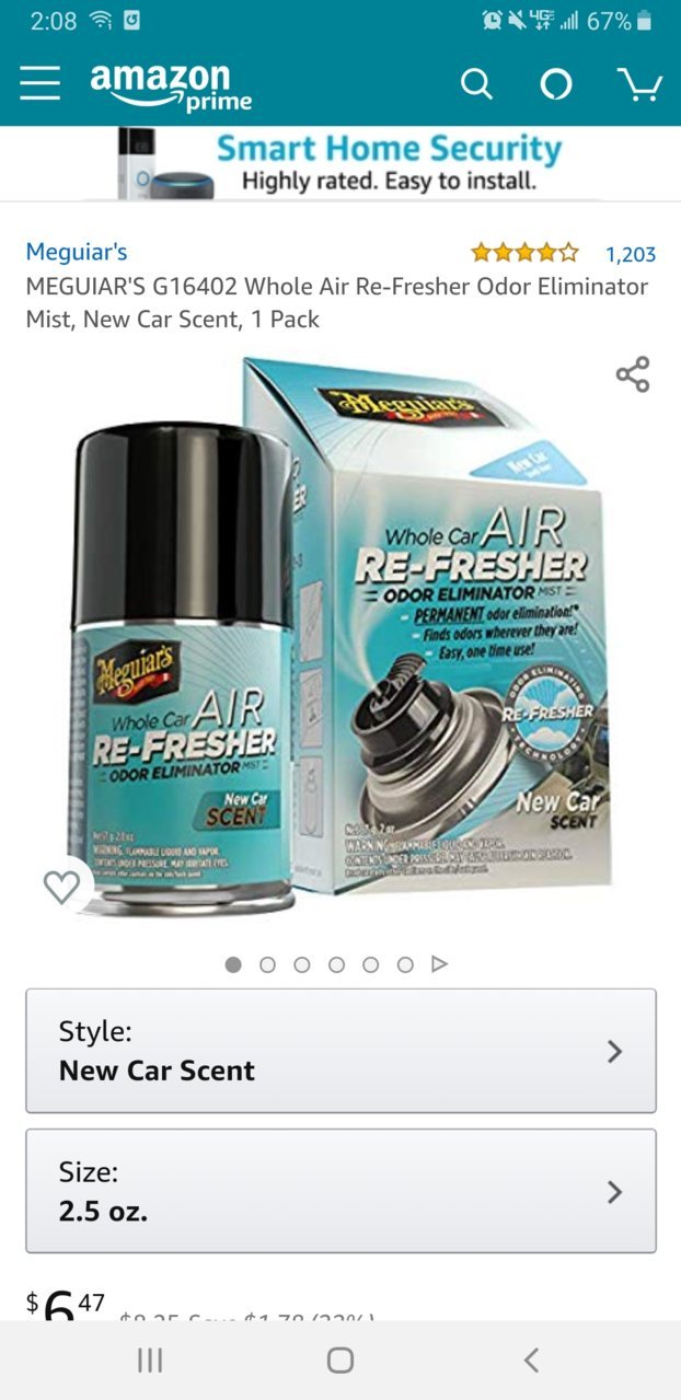

    Ive used Frigi Fresh in the past and it helped a lot. I've seen this and your supposed to have your truck running with the air on. Screenshot_20190725-140842_Amazon Shopping.jpg
